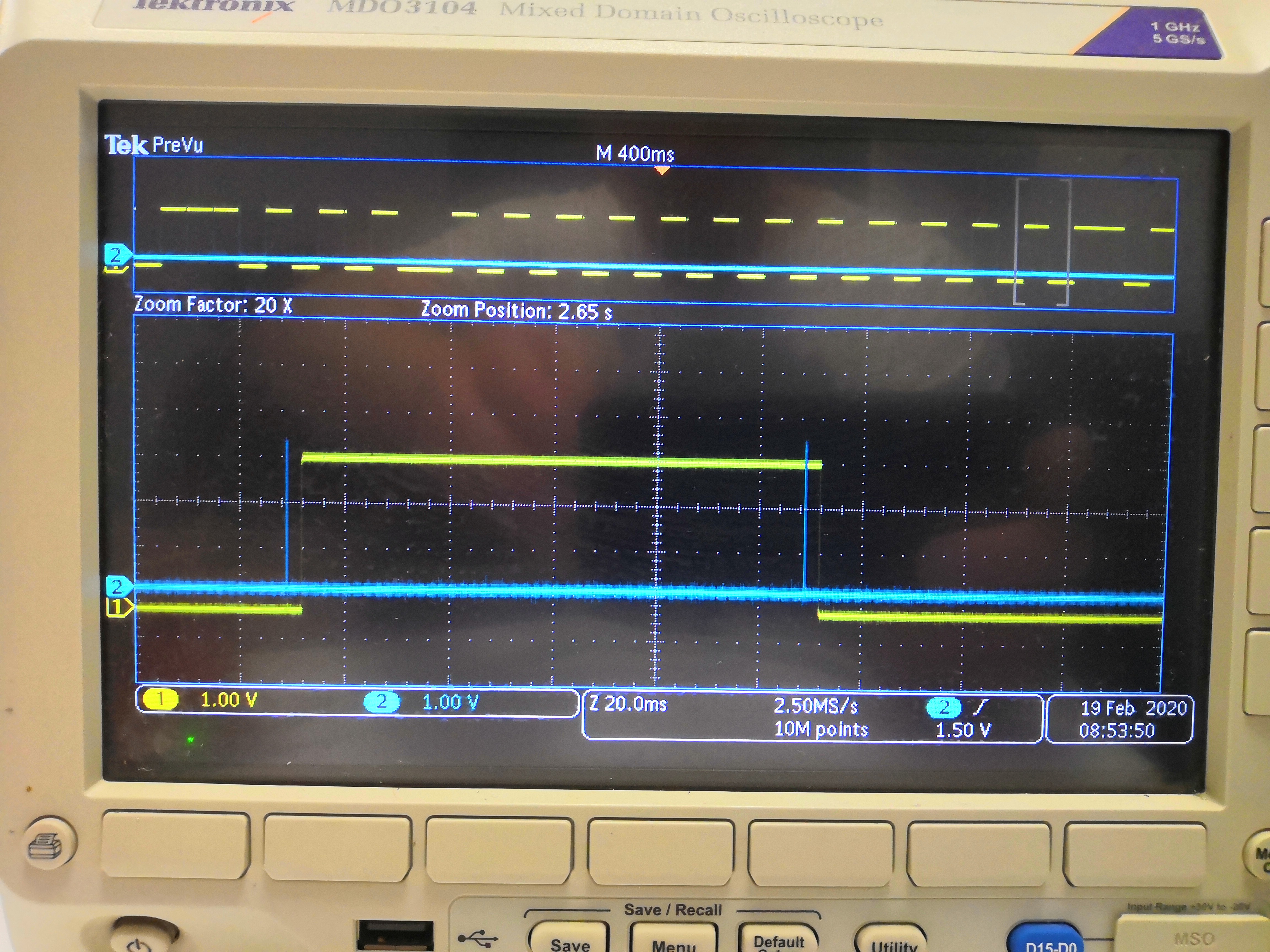

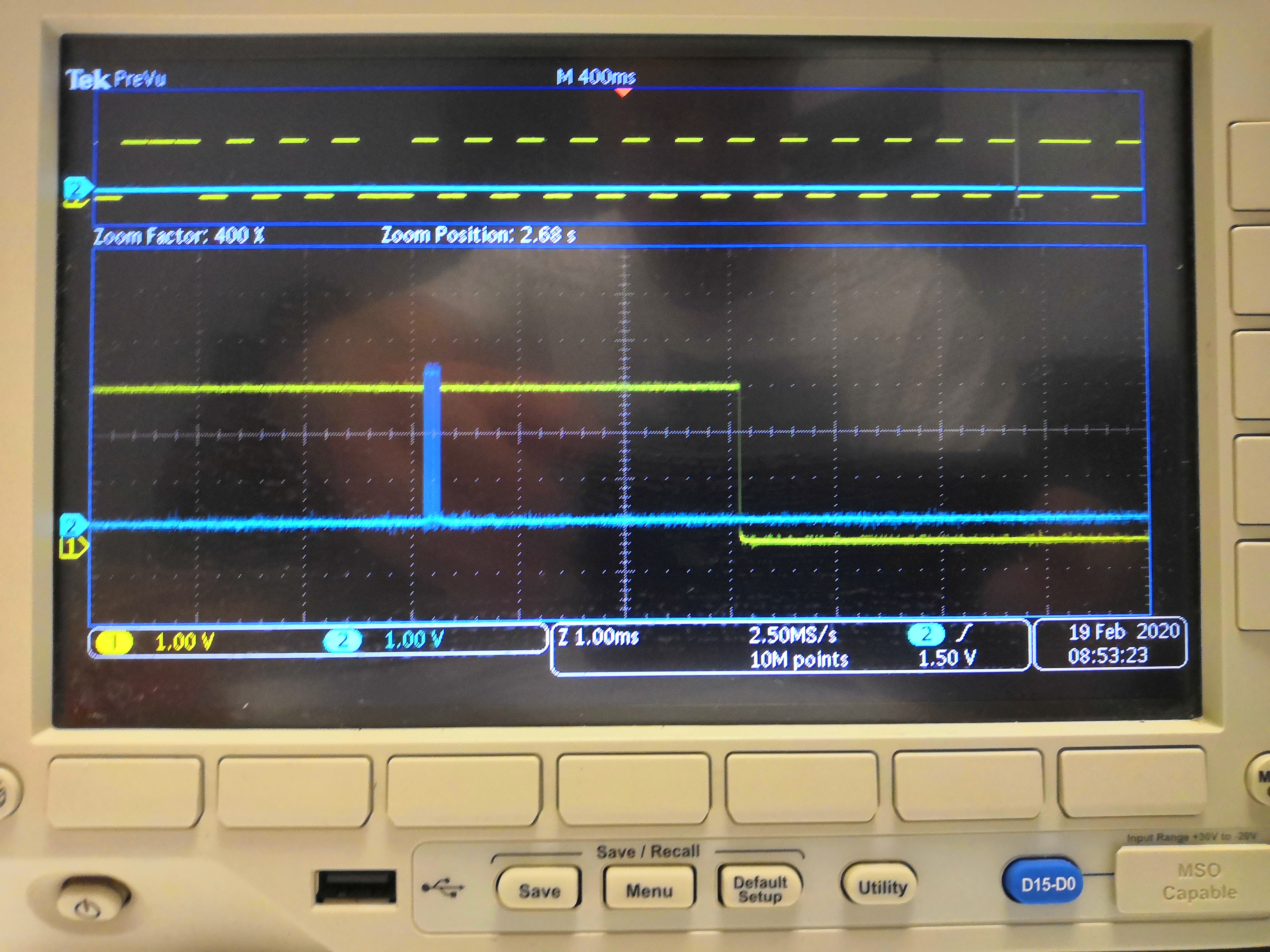

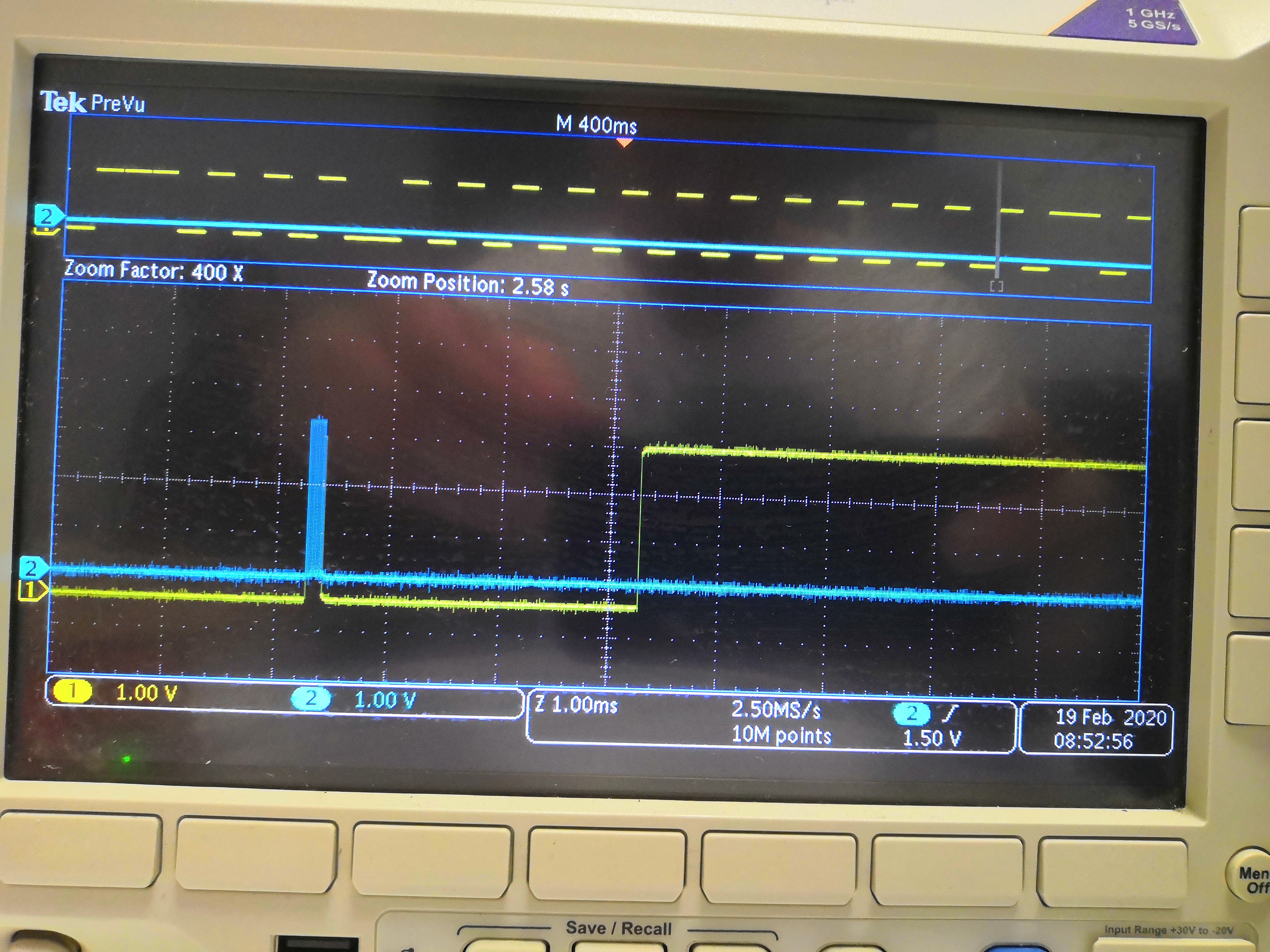

    Can you verify the three following points:
    • Can you observe the expected antenna and antenna-array switching on the boosterpack? Please refer to the "AOA welcome page" (and more precisely on the truth table provided) to do so.
    • Can you verify if the two branches of your if are accessed?
    • Can you verify the error is not only due to an error when displaying the data?
  • Hi Clement,
    Right after our previous post, we changed the code like this:
      // Initialize ant array switch pin
      if (status == 0)
        // Start with A2 (ANT_ARRAY pin high is A1, low is A2)
        PINCC26XX_setOutputValue(ANT_ARRAY, 0);
        status = 1;
      else
        // Start with A1 (ANT_ARRAY pin high is A1, low is A2)
        PINCC26XX_setOutputValue(ANT_ARRAY, 1);
        status = 0;
    Later, we connected pins 27 and 28 to the oscilloscope and observed that antenna-array and antenna switching occurs. We think, only data parameters from the host weren't changing, that's why were observing only "antenna": 1,. Also, we observed that we enter both statements in if block.
    After we inspected the signals in the oscilloscope, we found that although pin 27 was switching, pin 28 was switching only when pin 27 was in the HIGH state (even when pin 27 supposed to be LOW at that moment).  Here are some pictures:
    At the pictures, yellow one is pin 27 and the blue one is pin 28. We solved this problem by sending new AoA parameters through NPI (like host does with passive/master nodes).
    Next, we noticed that pin 27's switching is not strict as it should be: sometimes switching from HIGH to LOW or vice versa takes more than one connection interval. In the upper part of the last picture there are 3 clear moments like this. We thought that, our implementation might be not healthy enough so we decided to reproduce default examples of SDK 3.30 and see whether we made something incorrectly. We found that there was the same problem. Here is a picture of the persistence image we obtained from our oscilloscope:
    In this case, we set connection interval to 10 ms. There is clear trace of 'extended/passed' HIGH states in the left upper of the yellow upper line. Probably this is the reason why switching between two antenna-arrays was removed from the latest SDK 3.40. Is there any workaround to this issue in the latest SDK?
    Best regards
