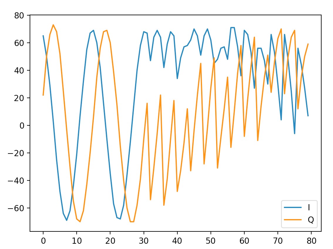

I've been trying out the SDK for the CC26X2 (version 3.40.00.02) with a pair of CC26x2R1 as RTLS Master and RTLS Slave (no Passive)
and I'm currently using the rtls_example_with_rtls_util.py and rtls_aoa_iq_with_rtls_util_export_into_csv.py application.
For RTLS Master and RTLS Slave (no Passive), with AOA parameters [sample_rate = 4MHz, slot_duration = 2us] in rtls_aoa_iq_with_rtls_util_export_into_csv.py
It looks normal in first 32 samples as no ANT switching in reference period.
pic 1: RAW without filtering
pic2: default filtering ANT switch slot
1. in PIC1, why the IQ samples would be across axis every 2 samples?
2. And in PIC2 of IQ plots with default filtering(no antenna switching slot), it didn’t look like a wave during the sampling slot (every 2us, 8 samples),
Does the 2us slot duration means antenna switch + sample slot? Or 2us for each slot?

    Q1) First of all, can you confirm you have consulted the AOA welcome page and followed the chapter "Preparations"?
    Q2 and Q3) (And for all the questions regarding CTE timing): Please have a look to the BLUETOOTH CORE SPECIFICATION Version 5.1 | Vol 6, Part B | 2.5.1 and BLUETOOTH CORE SPECIFICATION Version 5.1 | Vol 6, Part B | 2.5.4.
    - The 2us slot duration means antenna switch + sample slot. In other words, you have one antenna switching every 2us.
      [EDIT] The sampling slots (lasting 1us or 2us) are alternate with switching slots (lasting 1us or 2us too). Details can be founded in the “Bluetooth Direction Finding - A Technical Overview” document (especially in the Figure 20 - CTE timing rules).
    -The values used by LL_SetCteSamples() seem correct to me:
    • If you are using 1us then you have 1us switch slot which is dropped and 1us sample slot which are samples you are saving -> as you said, 32 samples + 4 samples from the switching slot = sampling starts at offset 36
    • However, if you are using 2us then you have a 2us switch slot, 1us ‘idle’ slot which allows your antennas to settle and finally 1us sample slot -> 32 samples + 8 samples from the switch slot + 4 samples from the idle slot = sampling starts at offset 44.

    Q2) Q3). So for both 1us and 2us slot duration with 4MHz sampling rate, the "valid" samples within a sampling slot are all 4 samples?
    I referenced how RTLS passive extract IQ samples for pair angle calculation
    (Passive copy samples from RF RAM, and only support 4MHz 2us)
    It seems the valid samples within a sampling slot is 8
    #define AOA_NUM_VALID_SAMPLES 8
    #define AOA_OFFSET_FIRST_VALID_SAMPLE 8
    #define AOA_NUM_SAMPLES_PER_BLOCK 16

  • Hi Kenny,
    First of all, please accept my apologies, I made a mistake in my last message. I have edited it and referenced a link I really like. As you will see, the sampling slot it self lasts 2us. The switching slots lasts also 2us.
    I am not sure which piece of code you are referring to but it worth to mention the system keep track of which antenna has been used to sample a given I/Q sample. As a result this information is propagated through the code (especially in RTLSCtrl_estimateAngle() and AOA_getPairAngles()) and used.
  • Hi Clément,
    From AOA_getPairAngles() defined for RTLS_MASTER, the valid symbol per slot is 1*sample_rate
    From AOA_getPairAngles() defined for RTLS_PASSIVE, the valid symbol per slot seems to be 2*sample_rate (PASSIVE AOA config is 4MHz, 2us and not able to modified)
    and as you mentioned system keep track of which antenna has been used to sample a given I/Q sample, but how could we peek this or we could only interpolate by ourselves in the order of [0, 1, 2] with the first valid IQ starting from ANT1?
    Kenny
    As you know the first antenna used and the switching sequence, you can "guess" from which antenna each sample is coming from.
