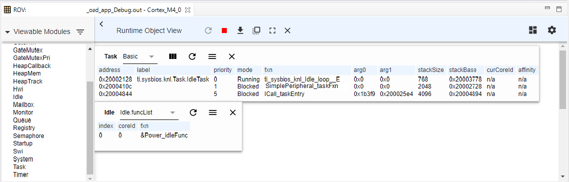

I am working on cc2642.
I am using the below IDE and SDK.
- CCS 9.2.0
- simplelink_cc13x2_26x2_sdk_3_30_00_03
- base code -: simple_peripheral_oad_onchip.
I have i2c and SPI interfaces in my application.

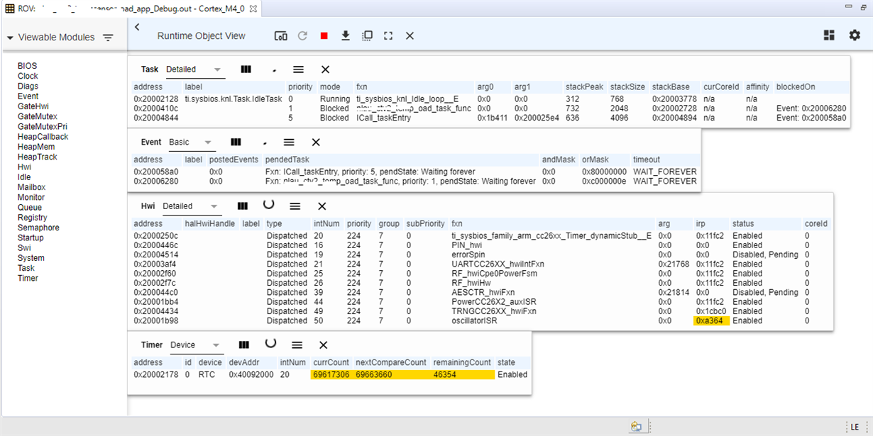

I have timer for every one minute, once the time expires device will wake-up, read temperature and advertise it for 6 seconds and stops advertisements.
As per my understanding device should go in sleep mode if no tasks are running but(event_pend) but I am observing my device is taking around 1.6ma current in sleep mode.
it seems the device is not going in sleep mode I am closing my i2c and SPI if not using.
Please advise how to put the device in sleep mode I should get only ~5ua current in sleep mode.
Please let me know if you need further information from my side.
