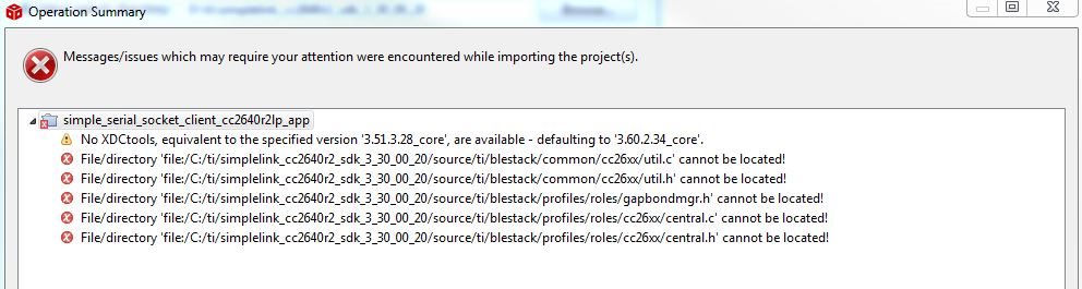

    Here is the error message:

  • Hi Ozzy,
    This seem to be related to your environment variables being of, did you install the SDK into the D drive or did you move it there yourself after installing?
    Your SDK environmental seems to think the SDK is installed under C:/ti and not D:/ti. This is why the projects do not import as expected. As you can see by the errors, multiple files are missing which is why you can not link the project.

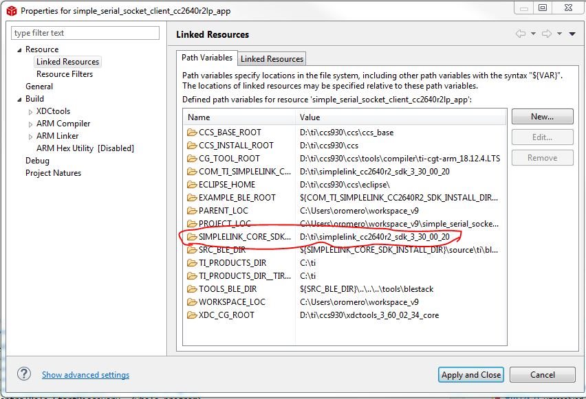

    2. Changed the path variable to point to the the D: drive where my CCS9 installation is at:

  • Hi Ozzy,
    It is the "COM_TI_SIMPLELINK_CC2640R2_SDK_INSTALL_DIR" one that is the issue in your case, this is what is used when importing the projects. Based on your errors I assume you still have the import issue. Just to clarify, as long as you get errors when importing the project that it can't find files, then it wont build.
    Yes, I have no issues importing or compiling these project, but I know that by install dir variable is correct (and I conveniently has it under C:/ti per default as I only have one drive).
    Unless you really care to fix this, you can find the .projectspec files in the examples directory (these files is the recipe used by CCS to import projects) and replace the use of "COM_TI_SIMPL....." with the actual path of each files.
