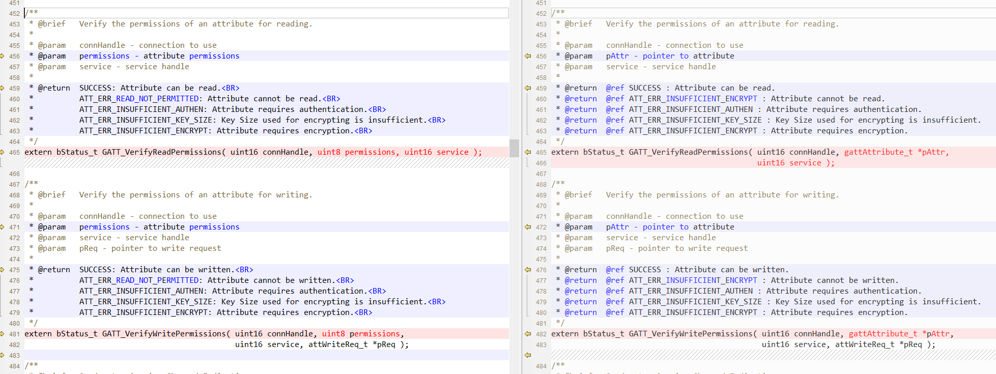

I updated the SDK from v2.2.2 to v2.2.4 and found that GATT_PERMIT_AUTHEN_WRITE not permitted for RACP characteristic with passkey entry pairing.
It is totally working on v2.2.2 with same phone and same application.

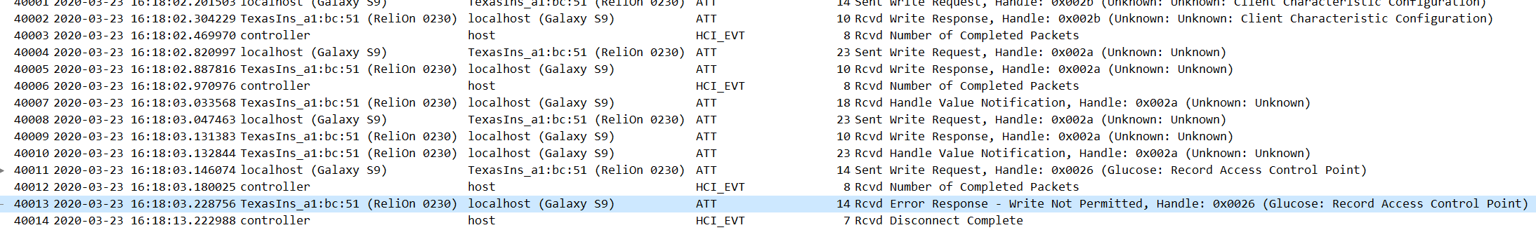

3. When our mobile application request write for the RACP Characteristic after bonded with passkey entry, it's not permitted like below.
This is a btsnoop log from android phone. I attached the log. Could you help me about this?

    -> My application code is exactly same in both project and I compared whole files of the two versions of SDK
        I found below difference in the gatt.h and nothing else was special.

    I was able to reproduce the issue.
    First, I confirmed that the glucose_example allows writing RACP with passkey entry on BLE Stack v2.2.2.
    Second, I also confirmed that the glucose_example does not allow writing it on BLE Stack v2.2.4. I got the same response as you -- write not permitted.
