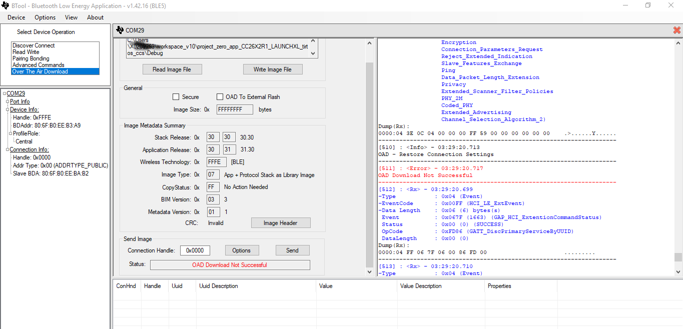

Dear team,
I am following the link as below
http://dev.ti.com/tirex/explore/node?node=AOimuSWjap.4RuDbcp7OqA__pTTHBmu__LATEST
But i always got an error.
[1] : <Info> - 03:31:59.208
OAD - Update Connection Settings
[2] : <Info> - 03:31:59.208
Start OAD Download
[3] : <Info> - 03:31:59.209
StartReset Service Discovery
[4] : <Info> - 03:31:59.209
OAD Send UUID Discovery
[5] : <Tx> - 03:31:59.208
-Type           : 0x01 (Command)
-OpCode         : 0x2016 (HCI_LEReadRemoteUsedFeatures)
-Data Length    : 0x02 (2) byte(s)
 Handle         : 0x0000 (0)
Dump(Tx):
0000:01 16 20 02 00 00                               .. ...
[6] : <Tx> - 03:31:59.219
-OpCode         : 0xFD86 (GATT_DiscPrimaryServiceByUUID)
-Data Length    : 0x12 (18) byte(s)
 ConnHandle     : 0x0000 (0)
 Value          : 00:00:00:00:00:00:00:B0:00:40:51:04:D0:FF:00:F0
Dump(Tx):
0000:01 86 FD 12 00 00 00 00 00 00 00 00 00 B0 00 40 ...............@
0010:51 04 D0 FF 00 F0                               Q.....
[7] : <Rx> - 03:31:59.228
-Type           : 0x04 (Event)
-EventCode      : 0x003E (HCI_LE_GenericReportEvent)
-Data Length    : 0x0C (12) bytes(s)
 LE Event Code  : 0x04 (4) (HCI_LE_ReadRemoteUsedFeaturesCompleteEvent)
 Status         : 0x00 (0) (SUCCESS)
 ConnectionId   : 0x0000 (0)
 Features       : 0x00000000000059FF (23039) (
                  Encryption
                  Connection_Parameters_Request
                  Reject_Extended_Indication
                  Slave_Features_Exchange
                  Ping
                  Data_Packet_Length_Extension
                  Privacy
                  Extended_Scanner_Filter_Policies
                  PHY_2M
                  Coded_PHY
                  Extended_Advertising
                  Channel_Selection_Algorithm_2)
Dump(Rx):
0000:04 3E 0C 04 00 00 00 FF 59 00 00 00 00 00 00    .>......Y......
[8] : <Rx> - 03:31:59.239
-EventCode      : 0x00FF (HCI_LE_ExtEvent)
-Data Length    : 0x06 (6) bytes(s)
 Event          : 0x067F (1663) (GAP_HCI_ExtentionCommandStatus)
 DataLength     : 0x00 (0)
Dump(Rx):
0000:04 FF 06 7F 06 00 86 FD 00                      .........

[54] : <Error> - 03:32:33.008
OAD Download Not Successful
[55] : <Rx> - 03:32:33.000
-Data Length    : 0x0A (10) bytes(s)
 Event          : 0x0501 (1281) (ATT_ErrorRsp)
 PduLen         : 0x04 (4)
 ReqOpCode      : 0x06 (ATT_FindByTypeValueReq)
 Handle         : 0x0001 (1)
 ErrorCode      : 0x0A (10) (ATTR_NOT_FOUND)
Dump(Rx):
0000:04 FF 0A 01 05 00 00 00 04 06 01 00 0A          .............

[61] : <Rx> - 03:32:33.121
 OpCode         : 0xFE11 (GAP_UpdateLinkParamReq)
Dump(Rx):
0000:04 FF 06 7F 06 00 11 FE 00                      .........
[62] : <Rx> - 03:32:36.995
-EventCode      : 0x000E (HCI_CommandCompleteEvent)
 Packets        : 0x01 (1)
 OpCode         : 0x2020 (HCI_LE_RemoteConnectionParameterRequestReply)
 Handle         : 0x0000 (0)
Dump(Rx):
0000:04 0E 06 01 20 20 00 00 00                      ....  ...
[63] : <Rx> - 03:32:37.093
-Data Length    : 0x0B (11) bytes(s)
 Event          : 0x0607 (1543) (GAP_LinkParamUpdate)
 ConnInterval   : 0x0320 (800)
 ConnLatency    : 0x0000 (0)
 ConnTimeout    : 0x0258 (600)
Dump(Rx):
0000:04 FF 0B 07 06 00 00 00 20 03 00 00 58 02       ........ ...X.
Please help
