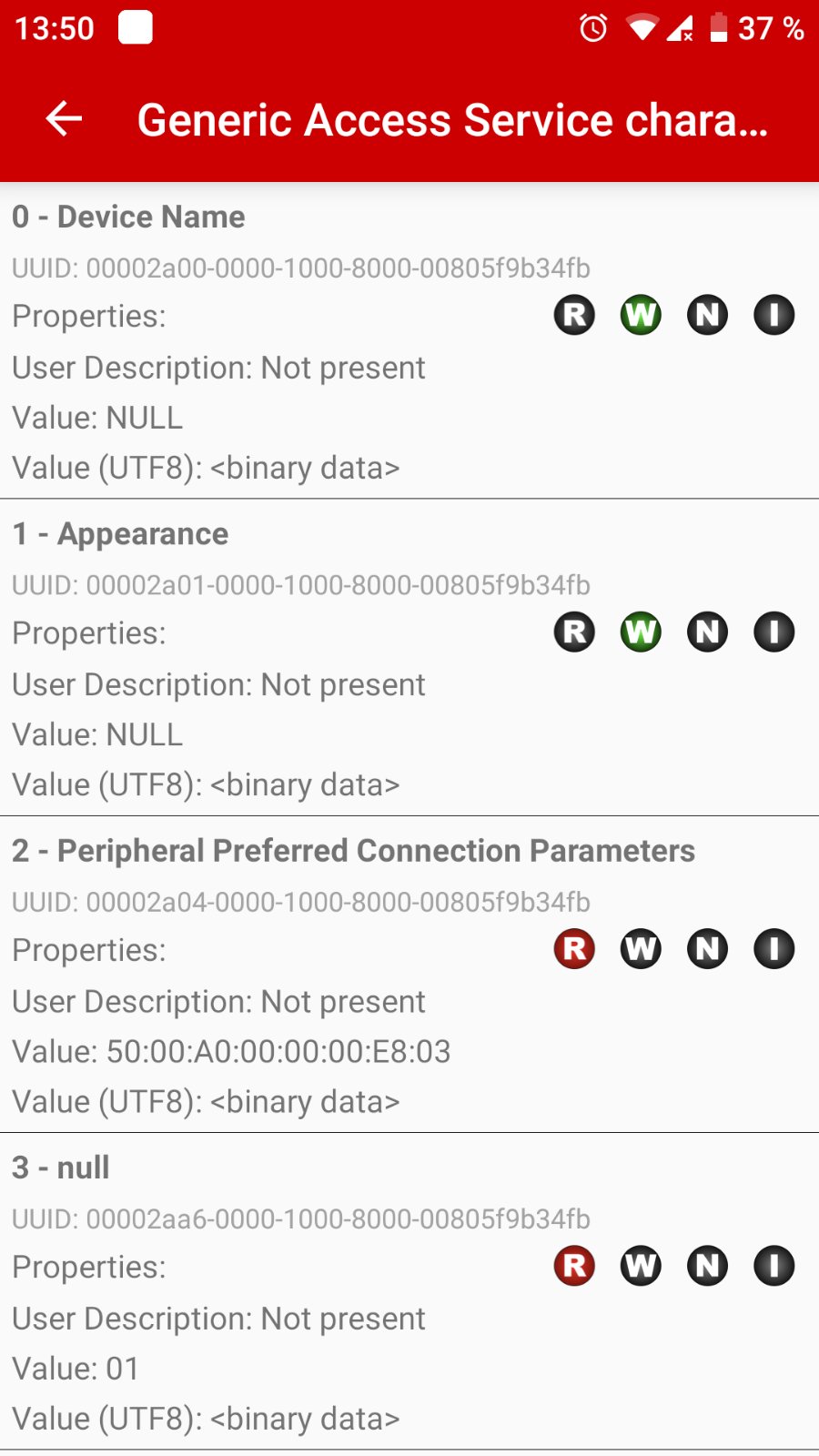

We assume that there is an bug in the GAP functionality in SDK 3.40.0.02. When checking the simple_peripheral_app_CC13X2R1_LAUNCHXL_tirtos_ccs example on the Launchpad CC1352R, we noticed that the Device Name and Appearance characteristics have the W (write) attribute, while the attribute should be R (read). In previous versions of the SDK, this problem was not observed. Please fix this error.
