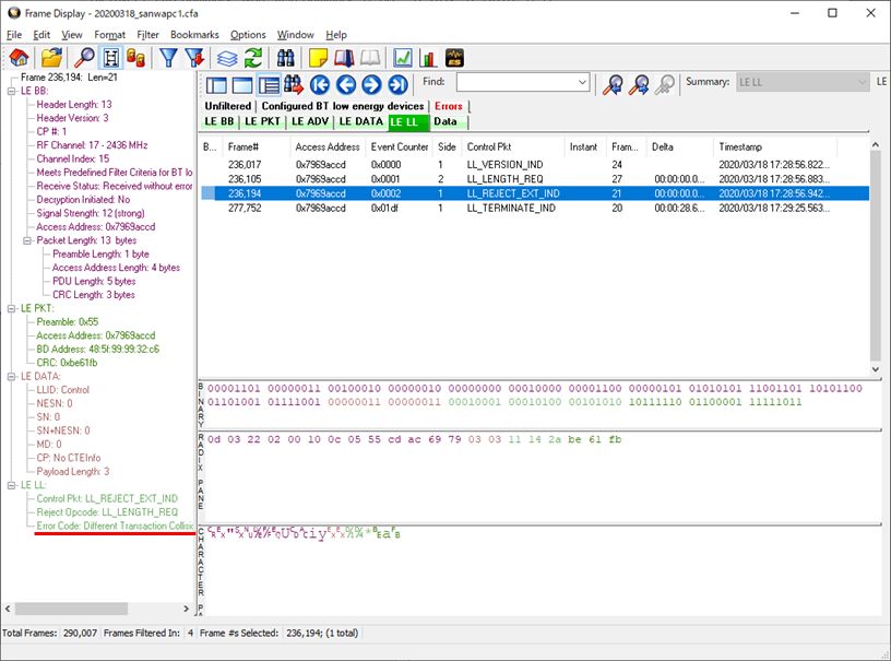

My customer is developing on customer's board using CC2650MODA. They designed based on project_zero of CC2650, but when paired with PC, error occurred. Customer confirmed the connection on various PCs using "Bluetooth LE Explorer" (Analyzer). On some computers, pairing error has occurred.

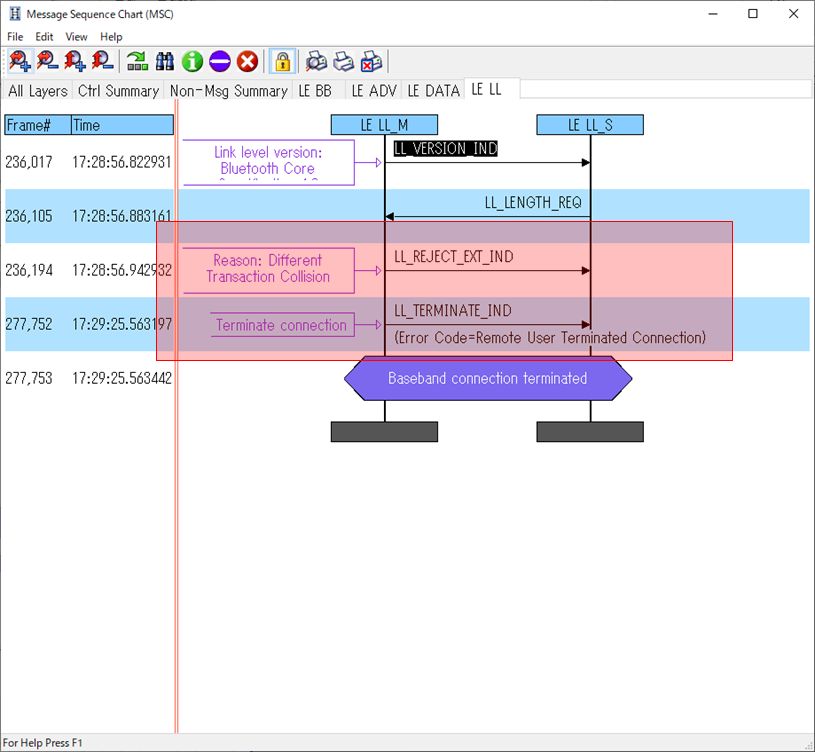

From PC(Master), it was confirmed "different transaction collision". We thought PC was bad and checked with SensorTag. Pairing was successful even on PC what pairing error occurred. Even if the driver of error PC is replace, customer's board can't be paired. I think that something in project_zero is bad.
Do you have any thoughts about what the cause might be?
