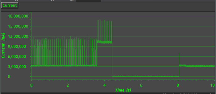

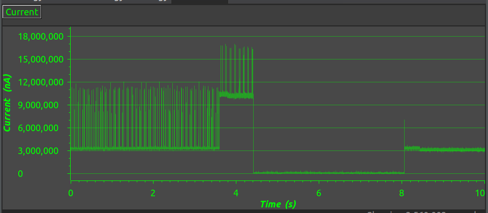

    I just used the Code Composer Studio Energy trace tool to find out my board' s power consumption. Here is the output;
    Actually, the current consumption graph seems promising to me. I pressed button 1 (my shut-down button) at sec: 3,6. Because I turn the greenLed on in my interrupt routine, current consumption jumped to 10mA immediately. After some time, in my main function, I turned both LEDs off and shut the board down at sec: 4,4. After for a while, I pressed the wake-up button at sec: 8 and as you can see, current consumption jumped to 3mA again and it seems logical because as I said, my BLE stack and my LEDs and my UART interface did not work after I pressed the wake-up button but I expect they should work of course.
    I could not get additional debug outputs because when I pressed the shut-down-button while debugging through CCS, I could not see any additional console output like informative or error outputs.

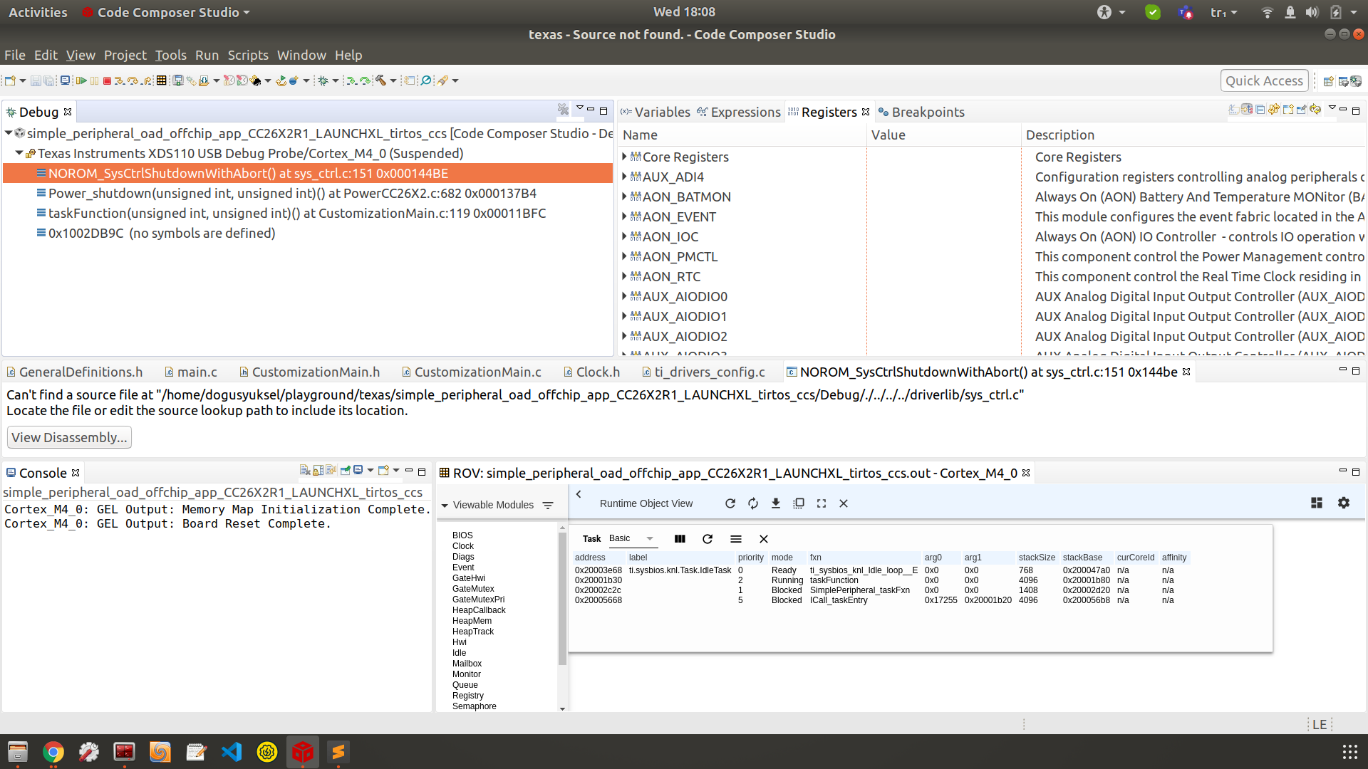

    Can you attach the debugger, then pause the debug session and screen-shot the call stack?
  • Hi Marie,
    I attached the screen.
    In the attachment, you can see also RuntimeObjectViewver part. When I pressed the button and the system went to power-off, my second task seems "Running". Maybe it can also give a clue to you.
