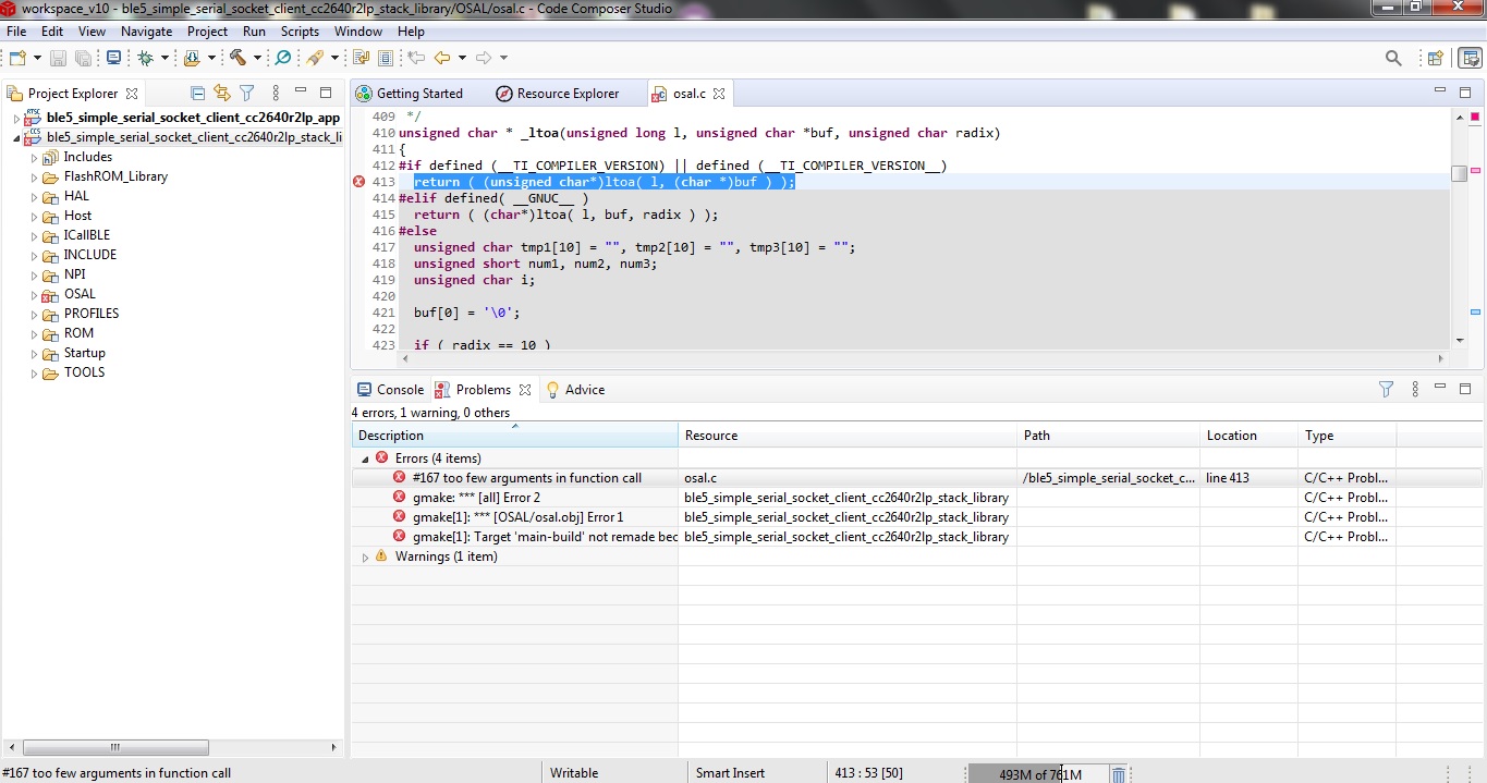

    I tried to bulid the client code in ccs but following compilation error is occuring, can you please help me to resolve this issue.
  • Those examples are based on simplelink_cc2640r2_sdk-3.30. Do you use matched SDK version?
  • Compilation error occured when i was compiling with SDK version 3.30.00.20.
  • Make sure you also download source\ti folder content in and copy all the folder contents into your 3.30.00.20 source\ti folder.

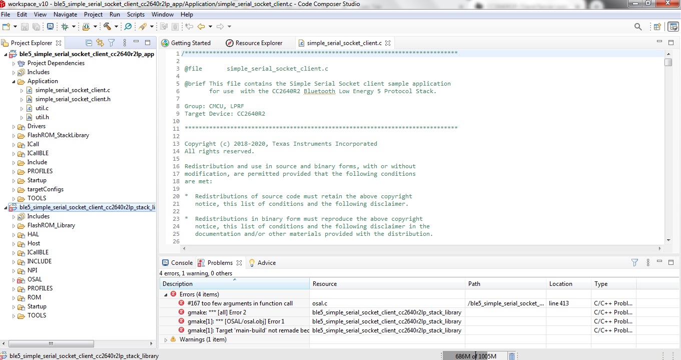

  • Before compiling i had coped the folder contents, but still i am facing same compilation issues. I even tired compiling project zero but same error is occurring for that project also.
  • Can you attach build log and errors shown on CCS console?
  • Attaching build log and screenshot of problems.

    "C:/ti/simplelink_cc2640r2_sdk_3_30_00_20/source/ti/ble5stack/osal/src/common/osal.c", line 413: error #167: too few arguments in function call
    1 error detected in the compilation of "C:/ti/simplelink_cc2640r2_sdk_3_30_00_20/source/ti/ble5stack/osal/src/common/osal.c".

  • If you install SDK 3.30.00.20 without overriding by those example source codes, can you build project_zero in ble5stack folder successfully?
  • No not able to build with stand alone SDK 3.30.00.20 also. I tried to compile simple broadcaster in IAR, i am able to build successfully. In ccs simple broadcaster is giving error.
  • SDK 3.30.00.20 uses CCS-9.0.0.00013 by default. Maybe try to install CCS-9.0.0.00013 to test again.
