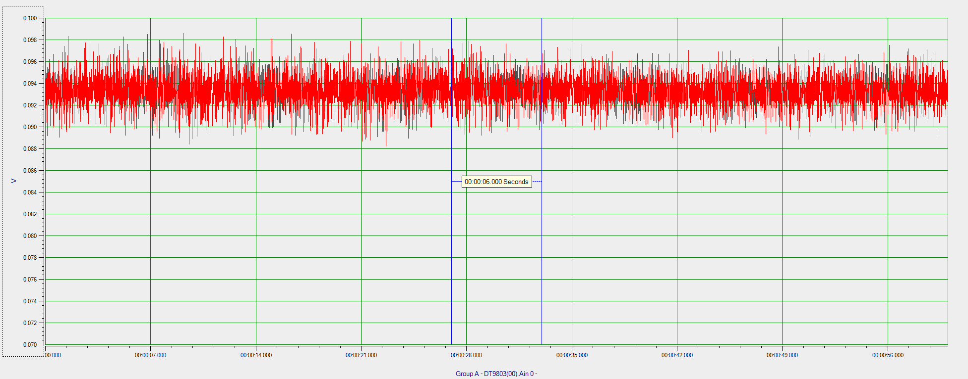

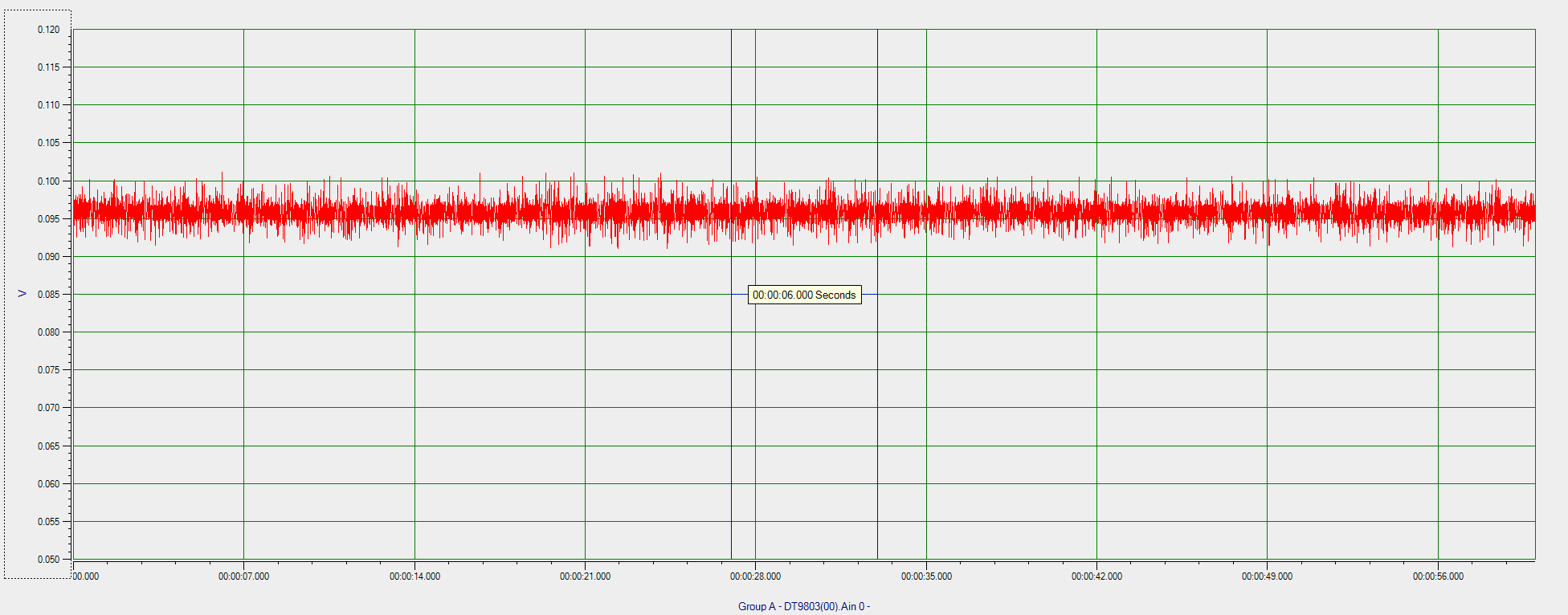

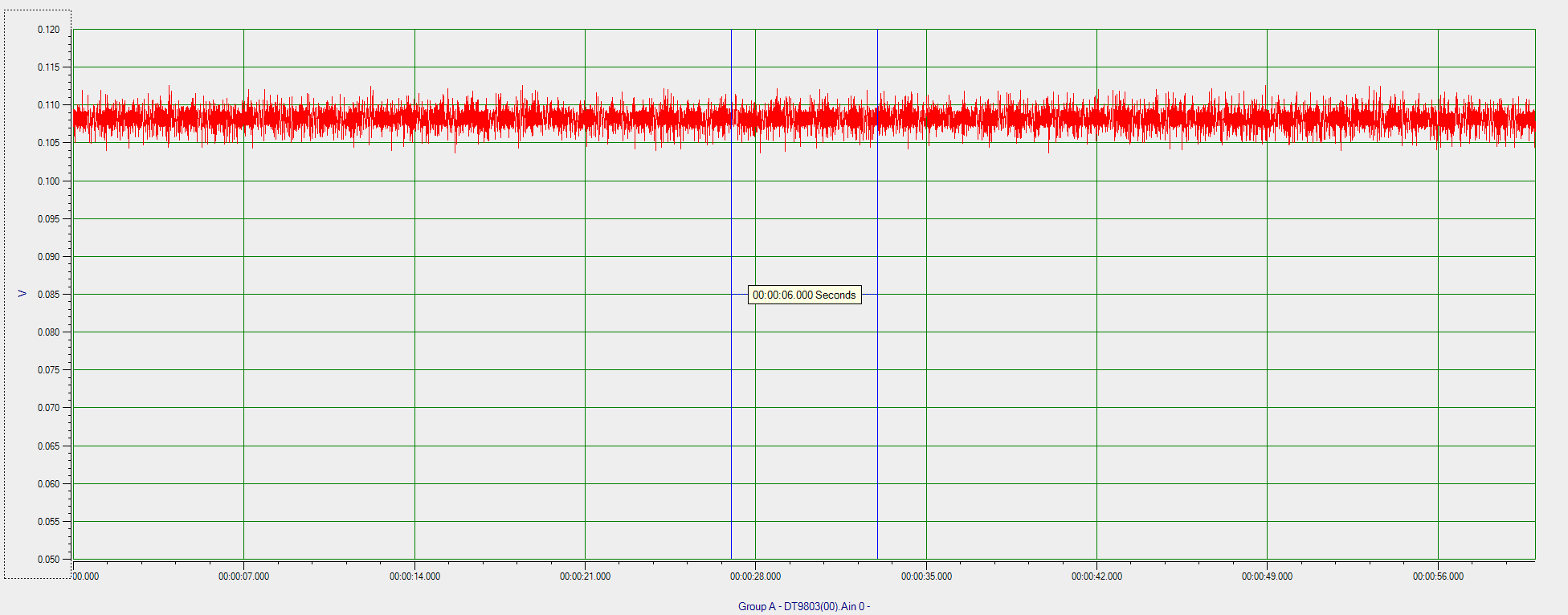

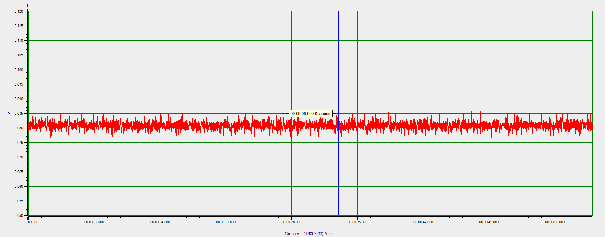

We have some percentage of the final CC2640R2F product, which their power consumption is about 15%~20% more than the other percentages. The software is exactly the same. The hardware is from the same batch of manufacturing, all SMT. It was through ultrasonic processing. Not sure if ultrasonic caused breaking components? If so, what would the most likely component be? The hardware is pretty much the basic from the reference design. Every test conditions were exactly the same.
This is the standard consumption:
This is the problematic consumption:
Simple schematic:
Samson
  • - Is the y-axis in the plots in mA? Is in number of units on the x-axis?
    - Which state is the chip in when doing this measurement?
    - Is it just CC2640R2F on the board or is it other devices on the board that draws current? If the latter, do you know that the CC2640R2F draws current?
  • Hello TER,
    The number on the y-axis divide by 10 is the mA number. The x-axis is time.
    Advertising with interval 600ms to 700ms. That's it. Nothing else.
    There are an external flash and an external sensor. That's it. I am pretty sure these two external components are not the problem source. When CC2640R2F is sleeping, there is zero current drawing. The sensor has its own idle state, it has nothing to do whether CC2640R2F is sleeping or not. So I am pretty sure the current is drawn by CC2640R2F itself only.

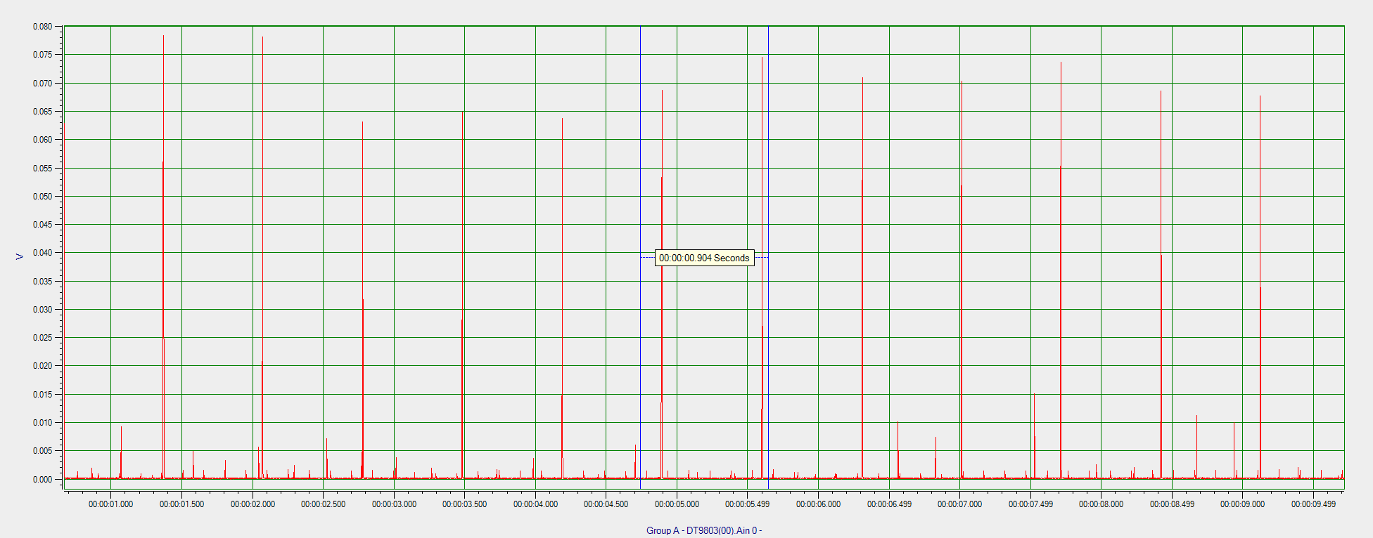

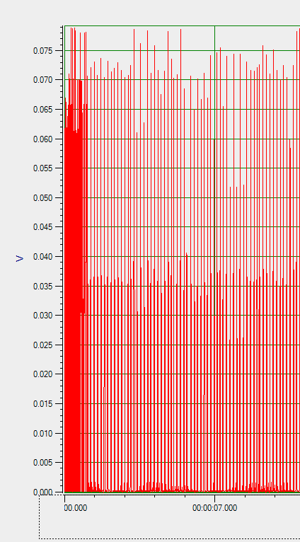

  • Would it be possible to zoom in on the current draw for one advertising event for a "good" and "bad" device?
    Would it be possible to do the same measurement where you don't have an antenna on the device but terminate in 50 ohm? The increased current could be caused be the antenna being detuned, either due to something on the board or that you have something in the near field when testing.
    Hello TER,
    Here are the extra graphs:
    Good ones:
    Bad ones:
    The little pulses on the bottom were the external sensors.
    Samson

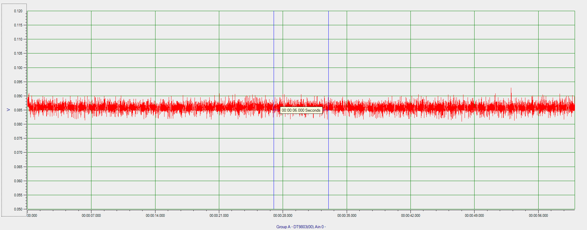

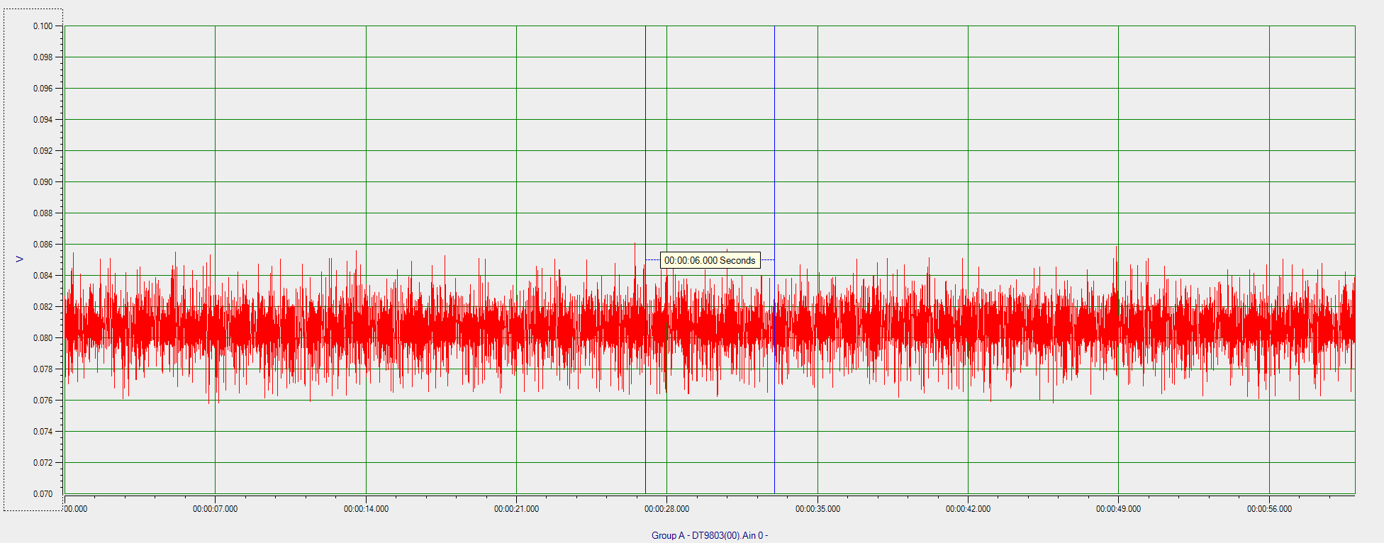

  • An additional question: On the zoomed out plots the current looks different for the various advertisement events, I assume that is just the resolution on the plot and not what it actually looks like?
    If you set the CC2640R2F to send a CW (Use SmartRF Studio or the CW example in the SDK) and measure the current consumption, do you see the same delta in current consumption (to rule out measurement errors)
    Hello TER,
    You are right that is the resolution. The plots were manually moved so it is hard to make two graphs with the exact same resolution.
    That is a good suggestion. I will change the firmware to the compliance mode to generate CW. The way I did the measurement does not allow me to use SmartRF Studio.
    Samson
  • Hello TER,
    Here are the graphs of 0dbm @ 2440MHz CW with an external power supply. (Battery cannot offer enough current for CW.)
    I also made the Y-axis consistent between graphs.
    The good one:
    The bad one 1:
    The bad one 2:
    Samson
  • Did you double check the power consumption with a multimeter? And did you terminate with 50 ohm? The current variation is larger than I would expect based on the numbers I have seen from our measurements but before looking into it in detail I would like an confirmation that the delta in current is not due to the antenna.
    Hello TER,
    Yes, I did check it with a multimeter. It is the same. I can see the RMS value is in the same variations, 8.x to 9.x mA. For the 50 ohms termination, I have a dumb question since I am not an RF expert. We are using the PCB DN007 antenna. (The same as the LaunchPad.) Do you want me to cut the original DN007 antenna and solder a 50 ohms resistor to the GND, then re-measure it?

    I redo the measurements. The previous graph was 5dbm already, but that has something else, so I did everything again.
    This time, I am pretty sure the external flash and the external sensor are all disabled and all y-axis resolutions are synced. The interesting thing is the 5dbm output made the variation even more.
    All CW 2440Mhz.
    RMS Reading:
    0dbm,
    the good one: 8.18mA
    the bad one: 8.54mA
    the second bad one: 8.64mA
    5dbm,
    the good one: 10.31mA
    the bad one: 10.99mA
    the second bad one: 10.67mA
    0dbm, the good one:
    0dbm, the bad one 1
    0dbm, the second bad one
    5dbm, the good one
    5dbm, the bad one
    5dbm, the second bad one
    Samson
