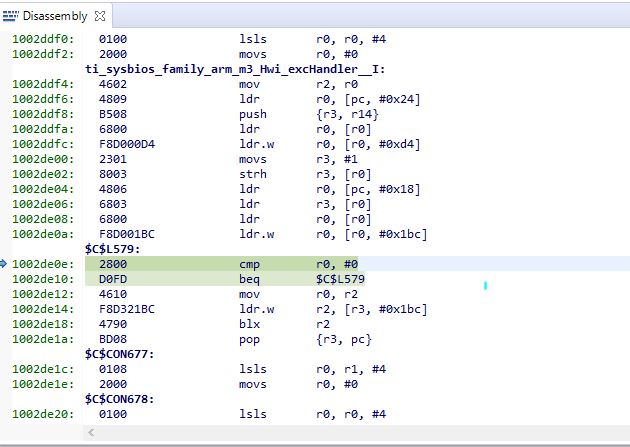

my programm starts switching beteenadress 1002de0e and 1002de10. What is it doing there? Why could it stuck there? I started to develop a project on the base of Project Zero.
Thanks a lot.
Thanks a lot.
Hi Viki,
If you suspect a hardware error you can look in the CPU Exception section of the Debug chapter:
If you want some more information about what code is running from ROM you can try loading the ROM symbols. Please see:
