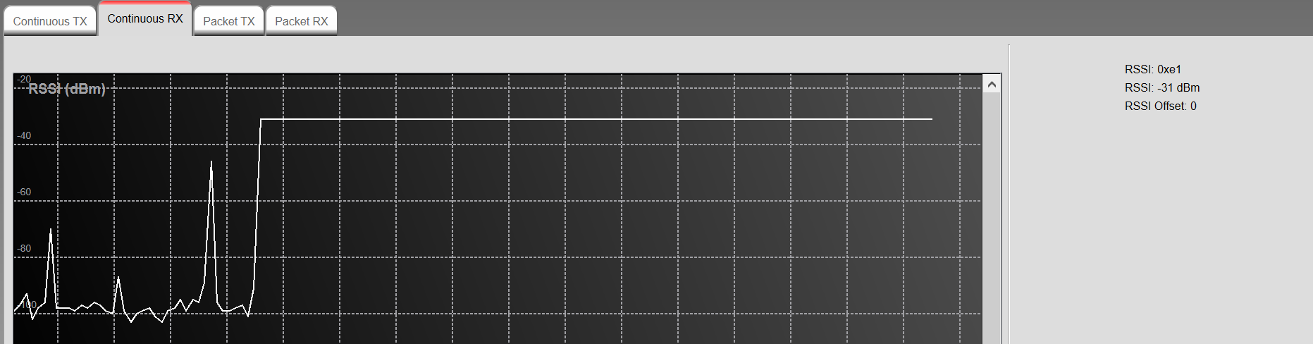

I am using the 2 TI launchpads, 1st as Host Test and 2nd in RF Smart Studio as to see the RSSI value for transmitted message from the Host Test.
I am using HCIExt_SetTxPowerCmd  to change the power level from -21 dBm to 5 dBm. However, I am not seeing any difference in RSSI value when the power is set to -21 dBm to 5 dBm.
I am using following Host Test API from BTool:
  1. HCIExt_SetTxPowerCmd
  2. HCIExt_ModemTestTxCmd --> Capture the RSSI value in Smart RF Studio
  3. HCIExt_EndModemTestCmd
-21dBm:
-12dBm:
0dBm:
5dBm:
