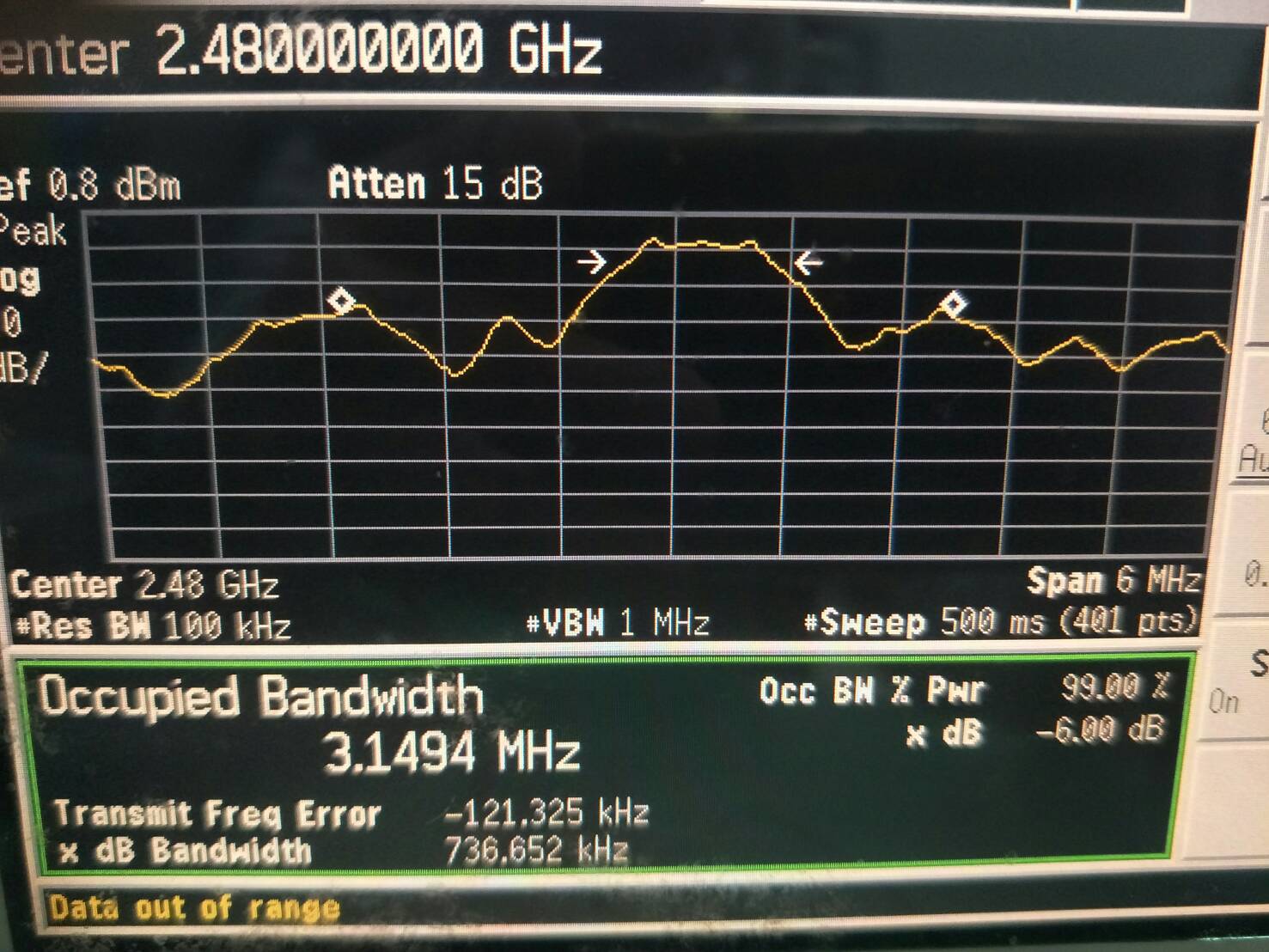

CC2541: CC2541 Occupied Bandwidth test failed on the SRRC Certification.
Part Number: CC2541
Hi ,
On the SRRC Certification. The test lab tested the occupied bandwidth is 3.1494MHz. So it is failed. any suggestion or feedback are highly appreciated.
Is there any way to solve it?
Thanks.
    What is the mode (BLE or Proprietary) you are using? If it Proprietary, what is the data rate, Modulation etc?
    What software you are using for testing?
    Are you using SmartRF Studio? If not could you please try with SmartRF Studio?

  • Hi ,
    I using SmartRF studio and set to BLE mode.
    Set as shown: channel 39 、 Modulated 、 tx power = 0dBm
    Thanks.
    I suspect you might have some spurs on the board and it is affecting the OCBW.
    Would it be possible to disconnect the On-Board Power supply to the CC2541 chip and fed it externally from a Lab power supply and retest it?
    Did you test at other channels for example Ch-37 and Ch-17?
