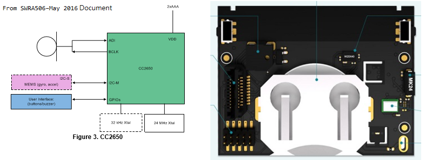

5.Can you help me figure out where are the GPIO, BCLK, ADx in the following two pictures?
GPIO: microphone power supply
BCLK: audio clock signal
ADx: PDM input stream from microphone
Thanks so much.

    5- Please review the schematic of the CC2650STK for details

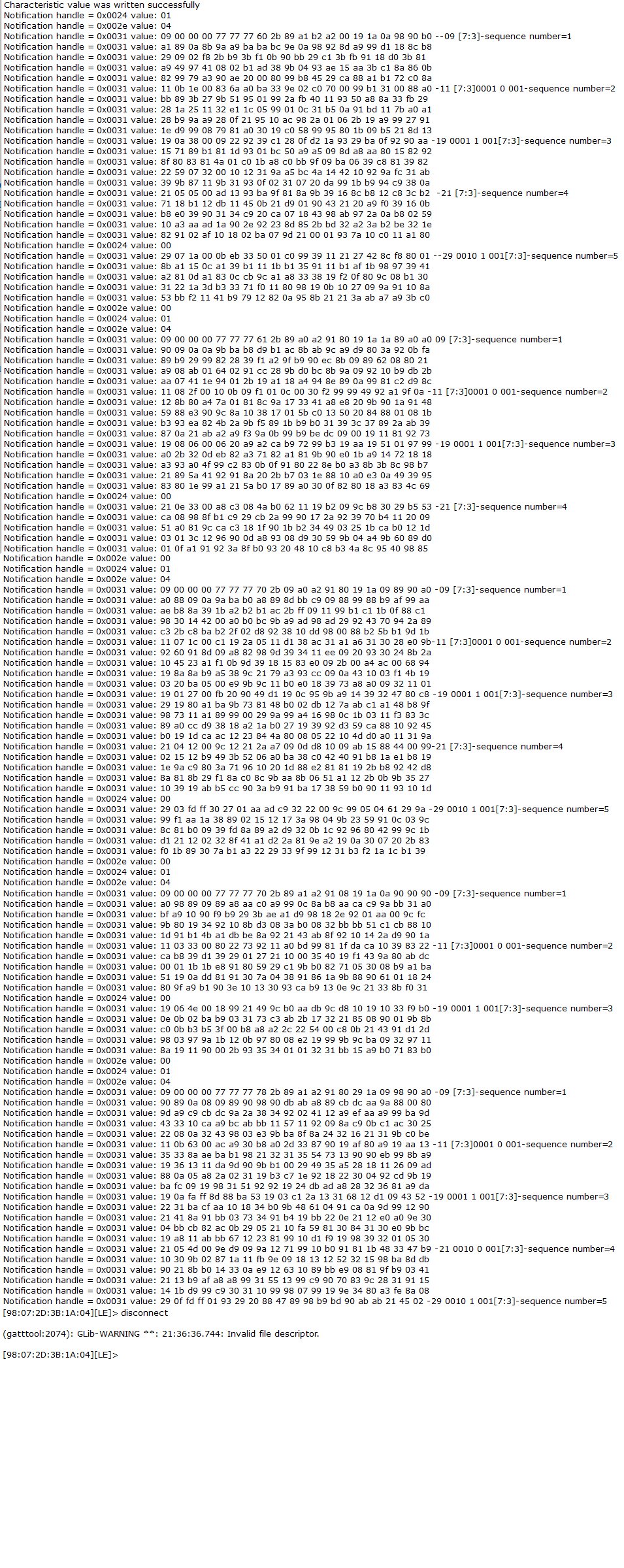

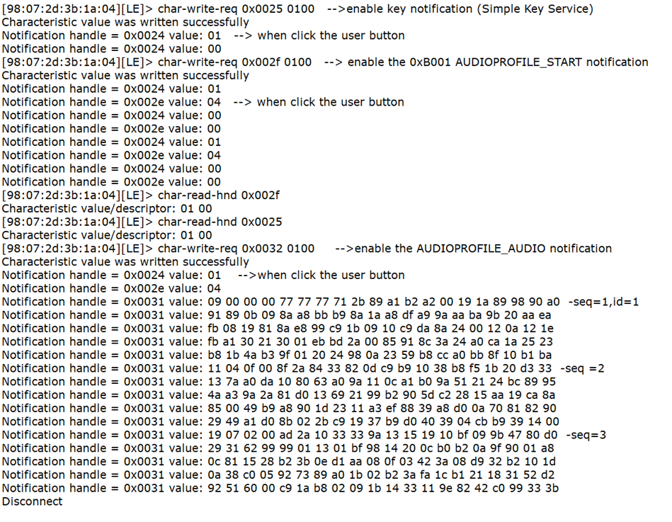

  • Hi Clément,
    I try to use gatttool, please check the history in the attachment.
    After clicking the user button of the cc2650stk sensor tag multiple times, the red LED is always on, and then suddenly disconnected.
    Do you know how to use gatttool to check the problem?
    Which UUID Services should I confirm?
    Thank you.
    Log History I :
    Log History II  :
    MM
  • Hi Clément,
    Sorry,correct the error description :
    After clicking the user button of the cc2650stk sensor tag multiple times, the red LED is always on, and the audio frame is stopped, and the sensortag can not write/read anything.
    When write the command of "disconnect" then the sensortag green led is blinking.
    The description of the problem, makes me think to an error in the BLE connection. This error might be due to various elements, maybe a memory leak.
    Try to use the ROV once the error has occurred. You can use the debugging chapter of the BLE Stack User's guide to help you in this debug.
