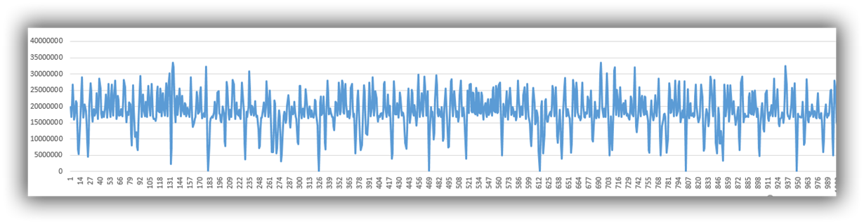

  • update IQ picture in the same environment without LNA modification
    If it was not clear, we fix the LNA gain for a given CTE. I am not sure what you are trying to do but by having a too big gain might saturate the LNA (and get unstable values).
    Can you provide some details regarding your test setup? Are you running conducted or non-conducted tests? Are you in a controlled environment (anechoic chamber)? Is the AOA varying? How much distance is there between the two devices?

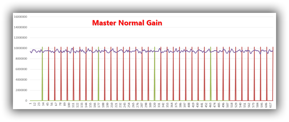

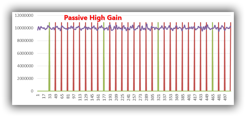

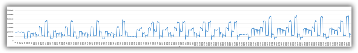

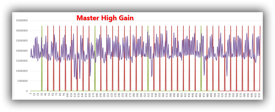

  • Hi  Clément,
    Sorry, The problem is still there.
    We can't set Tag to lower power, even the result no jagged .
    I measured again with conductive for Master -High gain, Master- normal gain, Passive High gain test, and use the same device to measurement. i think Master - high gain have some problem.
    Note: The red and green straight line just help me to discern the ANT switch interval, and i already connect RF cable to RF karkit and the signal will not go through ANT switch, so straight line is useless, don't care it.
    Can you run the tests with a fixed LNA low gain? I would like to see if in that case too the values measured by the passive are twice bigger than the values measured by the master.
    Thanks and regards,

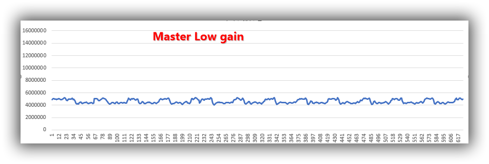

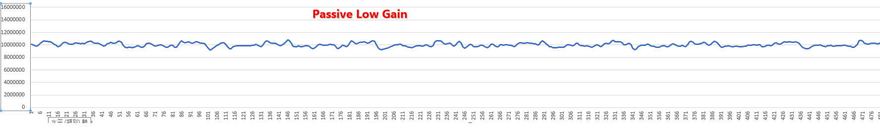

  • Hi Clément,
    thx for your support.
    1.My gain change for Master mode (ble_user_config.c)
       -->copy setting from pOverrides_ble1Mbps and add low gain config
    uint32_t pOverrides_xxx_ble1Mbps[] =
        // override_ble5_setup_override_1mbps.json
        // Bluetooth 5: Set pilot tone length to 20 us
        HW_REG_OVERRIDE(0x5320,0x03C0),
        HW_REG_OVERRIDE(0x6098,0x35ff),
        // Bluetooth 5: Compensate syncTimeadjust
        (uint32_t)0x015302A3,
        (uint32_t)0xFFFFFFFF
    const boardConfig_t boardConfig =
      .rfFeModeBias  = RF_FE_MODE_AND_BIAS,
      .rfRegTbl      = (regOverride_t*)pOverrides_bleCommon,
      .rfRegTbl1M    = (regOverride_t*)pOverrides_xxx_ble1Mbps,
    #if defined(BLE_V50_FEATURES) && (BLE_V50_FEATURES & (PHY_2MBPS_CFG | PHY_LR_CFG))
      // Currently, no overrides for 2M and Coded, so exclude from build.
    2.My gain change for Passive mode (urfc.c)
      regOverride_t pOverridesCommon[] = {
        0x00158000, // S2RCFG: Capture S2R from FrontEnd, on event (CM0 will arm)
        0x000E51D0, // After FRAC
        ((CTECONFIG << 16) | 0x8BB3), // Enable CTE capture
        ((CTEOFFSET << 24) | ((CTE_SAMPLING_CONFIG | (CTE_SAMPLING_CONFIG << 4)) << 16) | 0x0BC3), // Sampling rate, offset
        0xC0040341, // Pointer to antenna switching table in next entry
        (uint32_t) antSwitching, // Pointer to antenna switching table
         END_OVERRIDE };
       regOverride_t pOverrides1Mbps[] = {
         END_OVERRIDE };
    I have upload low gain picture for Master/Passive. Looks like Passive gain stage have some problem on SDK4.1. but it is normal on SDK3.4
