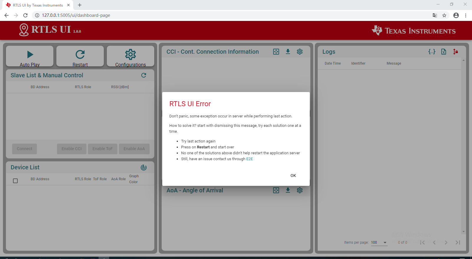

Unfortenetly, I cannot find the example ,i can't rtls_master and rtls_slave for simplelink_cc2640r2_sdk_4_10_00_10.

TI has made the decision to discontinue further development and support of the TI-proprietary Angle of Arrival (AoA) on the CC2640R2. We recommend and welcome our customers using AoA on CC2640R2 to transition from the CC2640R2 to the new RTLS examples based on the Bluetooth 5.1 specification which can be used with the CC13x2R and CC26x2R devices. These software examples can be found in the SimpleLink™ CC13x2 and CC26x2 software development kit 3.40 or later which features a Bluetooth 5.1 qualified stack with support of Bluetooth 5.1 Angle of Arrival. To make this transition, here is a list of available resources you can reference: Simple Link Academy, AoA stack users guide, LaunchPad Tool Order Page
If you have any questions about moving to the Bluetooth 5.1 AoA solution or any questions about the solution itself, please post to E2E!
You absolutely need a slave device. In the example, the slave device is responsible to send the CTE.
With SDK 3.40 and latter (i.e. including SDK 4.10), you can use a CC2640R2 as passive device (the master and slave devices have to be a CC26X2R1).
There is no SDK allowing to use two LAUNCHXL-CC2640R2F and one LAUNCHXL-CC26X2R1 to measure AOA.

I have the same RTLS UI ERROR.How can you solve it?

what's trouble? can't rtls_master and rtls_slave for simplelink_cc2640r2_sdk_4_10_00_10.?
I used two cc26x2r1 and one cc2640r2f, cc2640r2f antenna,SDK is the latest ,Maybe you can try to refresh and reconnect. That's how I am。
