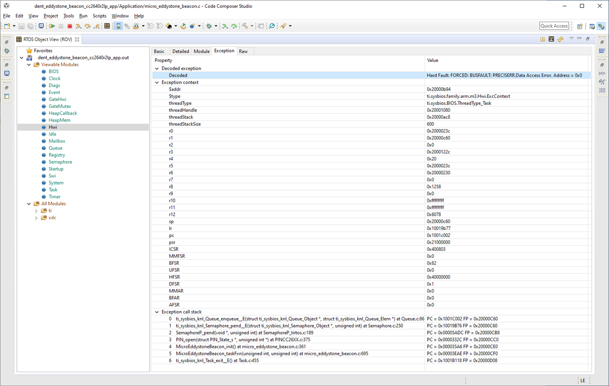

    I'm still stuck with migrating from 7x7 to the small 2.7x2.7 package.
    Trying to run the 7x7 code on the small 2.7x2.7 package, it hangs on ti_sysbios_family_arm_m3_Hwi_excHandler__I() , CFSR=0x00000400 (IMPRECISERR=1)
    Which #define(s) should I change?
    Should I avoid using some peripherals/GPIOs?

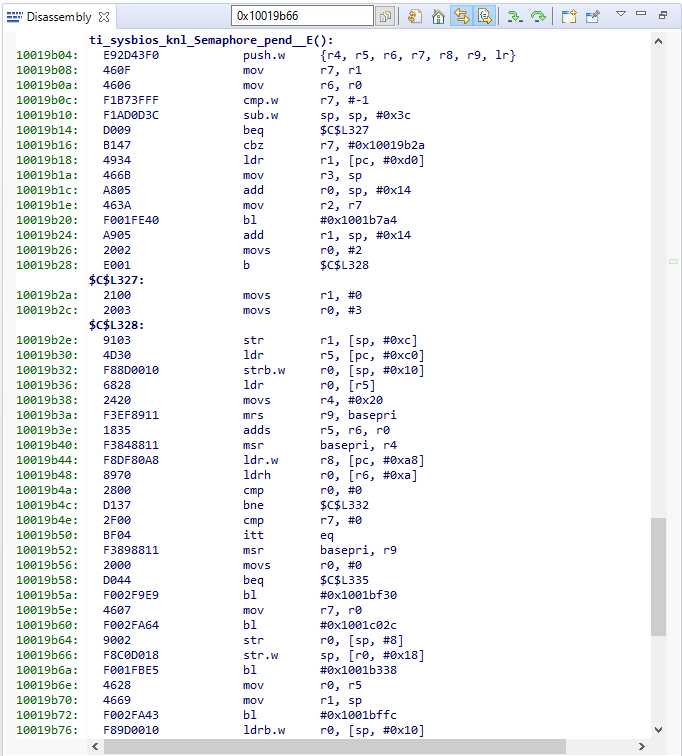

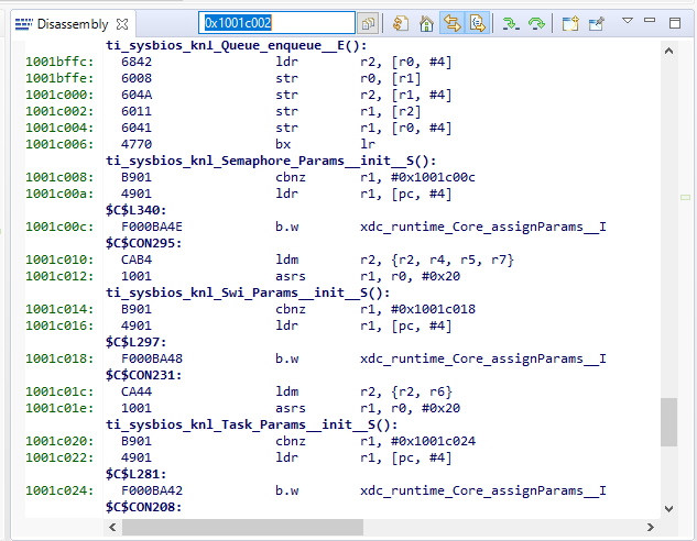

  • I did two debug sessions:
    1. Please see below:
    the assembly lines around the offending opcode are:

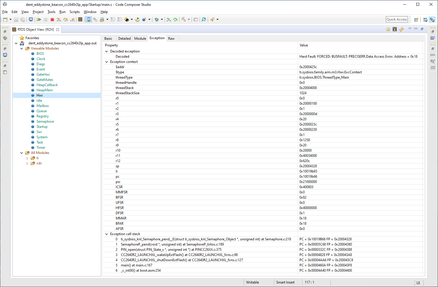

    2. The Board_shutDownExtFlash() function is called in order to save power. It was necessary to achieve low power on CC2640R2_LAUNCHXL. The custom board with 2.7x2.7 DSBGA package doesn't have external flash, so I commented out the call to Board_shutDownExtFlash(). (BTW, does it also save power by disabling internal related peripherals?) Now, without Board_shutDownExtFlash(), I get the following exception:
    Thanks for looking into it.

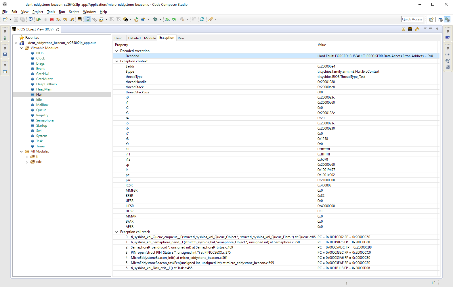

  • Hi Yoram,
    Can you double check that all the pins in your board files exist on your board?
  • My board files did have pins that don't exist in the 2.7x2.7 DSBGA package, because the code is based on example for 7x7 package on the CC2640R2_LAUNCHXL board.
    In CC2640R2_LAUNCHXL.h I replaced every IOIO_xx greater that IOID_13 to IOID_UNUSED
    Now I don't get CPU exception, but the code doesn't work right, and doesn't transmit the beacon.

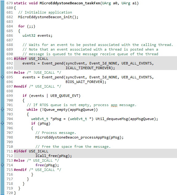

    Narrowing down the code that doesn't work right, I found that in the following function (found in micro_eddystone_beacon.c) :
    line #695 is reached 3 times, and in the 3'rd time, Event_pend() doesn't return. It neither get stuck nor get CPU exception, and when suspending execution, I get various code locations (examples listed below).
    When executing the same code on CC2640R2_LAUNCHXL, line #695 is endlessly reached, and the beacon is transmitted OK.
