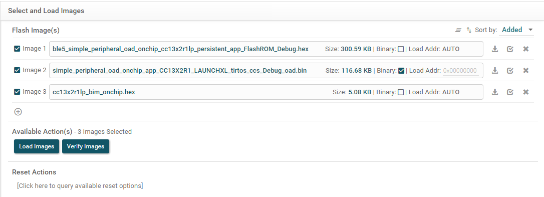

I build and flash the persistent application(ble5_simple_peripheral_oad_onchip_cc13x2r1lp_persistent_app) through UniFlash, then I build and flash user application(simple_peripheral_oad_onchip_app_CC13X2R1_LAUNCHXL_tirtos_ccs) through UniFlash. Finally, I flash BIM(cc13x2r1lp_bim_onchip.hex) in TI SDK Debug_unsecure dirctory through UniFlash.  As shown below:
Then I can scan "SP OAD on-chip" and connect it by iOS app BLE Scanner(This time I will enter the user application). I write 0x01 to service FFDO characteristic FFD1 on this user application. This would reset the device and boot the persistent application which has FFC0 OAD Service. And I notice the connection does break. Then the device boots to persistent application. At this time(Enter the persistent application), I can scan "Simple peripheral" but I can't connect it successfully by iOS app BLE Scanner or TI SimpleLink Starter. Could you please help me analyze the root cause ?

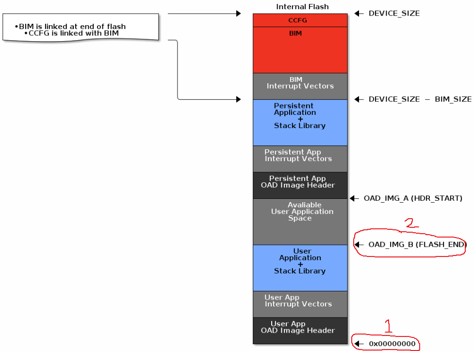

Where dose the incoming OAD firmware(User App + Stack Library) store at the very beginning in the internal flash during the On-Chip OAD process? Or say which one (1 or 2) does the incoming OAD image store at the very beginning in the following picture?
Thank you.

    In regards to your second question of where the OAD image is downloaded, it is stored at the beginning of flash, at location #1 you listed on the picture (as it overwrites the previous user application you have on the device).
    Michael
