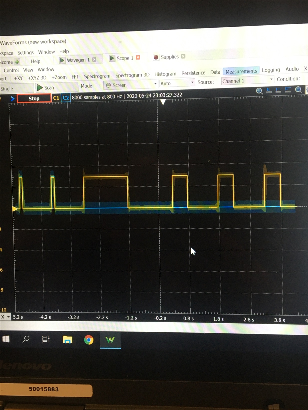

  • Thank you, I have an update.
    I have been able to unchain the Rx and Tx operations in the rfEchoRx project. So Tx operation triggers with TRIG_ABSTIME and its start time is rxStatistics.timeStamp + Txdelay. I verified that the output is the same as the regular rfEchoRx project (that has chained commands) by mapping the LNA (RFC_GPO0) radio signal and the transmission initiation (RFC_GPO3) radio signal to GPIOs.
    However, I am still unable to add some extra code for the 'ultrasound listening' as I discussed above. As we discussed, I tried to add some code from the adcBufContinuous project under the 'case PROP_DONE_OK' section. This extra code from the adcBufContinuous project is so that I can read and process the voltages. Although I have most of the adc code in this section (like creating a UART, setting up an ADCBuf peripheral in ADCBuf_RECURRENCE_MODE_CONTINUOUS, and calling adcCallback which performs some simple calculations on the read voltages), the specific line of code that breaks the RF functionality on board 2 is:
    if (ADCBuf_convert(adcBuf, &continuousConversion, 1) !=
                        ADCBuf_STATUS_SUCCESS) {
    If I comment this specific line out, the unchained Rx and Tx operations work fine. However, with the inclusion of this line of code, the RF operations on receiving board (which is running this modified version of rfEchoRx) stops functioning. It does not even receive (LNA signal never turns on), so it obviously never transmits. Because of this the transmitting board switches between transmitting and aborting.
    Why does board 2's RF functionality stop? Is the ADC somehow blocking the RF? Should the ADC conversion not be performed in this section under ''case PROP_DONE_OK''? We don't want to put the ADC code inside the RF callback, so where else would it make sense to include?
  • Hi N-M,
    You should minimize the work done here, initialization should preferably be done prior to this (so that you only had to do a convert). While the ADC should not break the Radio code (there is no such block that I'm aware of), it might not be advisable as the radio would affect the readings. The fact that you say it stops after this call leads me to believe that  this call either stalls the CPU or is blocking your task in another way.
    If you "pause" the device when the radio activity stops, what state is it in, what is it doing? Also, could you share the current code for me to look at to see if I could spot something obvious?
  • Thank you for the help, I am attaching my versions of rfEchoTx.c and rfEchoRx.c
    In rfEchoRx, I moved the initialization code outside of the "case PROP_DONE_OK" as you suggested. But the RF functionality on board 2 still stops with the ADC conversion code line. When I "pause" the device, the board 2 is completely inactive. It acts essentially as a turned-off radio from the very beginning.
    In rfEchoTx, most of the code is the same as the original example project. But there are a few differences (lines 236-254): along with transmitting an RF packet, I am also transmitting a PWM 40 kHz burst of 10ms. The PWM then stays idle for 1s which corresponds to the packet interval. I had to slightly delay the transmission of the RF packet to occur after the transmission of the PWM signal because it seems like they cannot be transmitted at the same time. I don't think these changes should affect my question (because the boards works fine with this modification as long as the ADC code line is omitted) but just wanted to let you know. The PWM being transmitted from board 1 is what I am trying to read using the ADC code in board 2.
    Also both files have mappings to GPIO pins to debug the LNA and transmission initiation radio signals.
    Thanks again.

        /******************** Setup for rfTx code to send RF signal and later receive echo (board 1)********************/
        /* Open LED pins */
        ledPinHandle = PIN_open(&ledPinState, pinTable);
        if (ledPinHandle == NULL) {
            while(1);
        uint32_t curtime;
        uint32_t Txtime;
        RF_Params rfParams;
        RF_Params_init(&rfParams);
        if(RFQueue_defineQueue(&dataQueue,
                               rxDataEntryBuffer,
                               sizeof(rxDataEntryBuffer),
                               NUM_DATA_ENTRIES,
                               PAYLOAD_LENGTH + NUM_APPENDED_BYTES))
            /* Failed to allocate space for all data entries */
            PIN_setOutputValue(ledPinHandle, Board_PIN_LED1, 1);
            PIN_setOutputValue(ledPinHandle, Board_PIN_LED2, 1);
            while(1);
        /* Modify CMD_PROP_TX and CMD_PROP_RX commands for application needs */
        RF_cmdPropTx.pktLen = PAYLOAD_LENGTH;
        RF_cmdPropTx.pPkt = txPacket;
        RF_cmdPropTx.startTrigger.triggerType = TRIG_ABSTIME;
        RF_cmdPropTx.startTrigger.pastTrig = 1;
        RF_cmdPropTx.startTime = 0;
        RF_cmdPropTx.pNextOp = (rfc_radioOp_t *)&RF_cmdPropRx;
        /* Only run the RX command if TX is successful */
        RF_cmdPropTx.condition.rule = COND_STOP_ON_FALSE;
        /* Set the Data Entity queue for received data */
        RF_cmdPropRx.pQueue = &dataQueue;
        /* Discard ignored packets from Rx queue */
        RF_cmdPropRx.rxConf.bAutoFlushIgnored = 1;
        /* Discard packets with CRC error from Rx queue */
        RF_cmdPropRx.rxConf.bAutoFlushCrcErr = 1;
        /* Implement packet length filtering to avoid PROP_ERROR_RXBUF */
        RF_cmdPropRx.maxPktLen = PAYLOAD_LENGTH;
        RF_cmdPropRx.pktConf.bRepeatOk = 0;
        RF_cmdPropRx.pktConf.bRepeatNok = 0;
        RF_cmdPropRx.pOutput = (uint8_t *)&rxStatistics;
        /* Receive operation will end RX_TIMEOUT ms after command starts */
        RF_cmdPropRx.endTrigger.triggerType = TRIG_REL_PREVEND;
        RF_cmdPropRx.endTime = RX_TIMEOUT;
        /* Request access to the radio */
    #if defined(DeviceFamily_CC26X0R2)
        rfHandle = RF_open(&rfObject, &RF_prop, (RF_RadioSetup*)&RF_cmdPropRadioSetup, &rfParams);
    #else
        rfHandle = RF_open(&rfObject, &RF_prop, (RF_RadioSetup*)&RF_cmdPropRadioDivSetup, &rfParams);
    #endif// DeviceFamily_CC26X0R2
        /* Set the frequency */
        RF_postCmd(rfHandle, (RF_Op*)&RF_cmdFs, RF_PriorityNormal, NULL, 0);
        while(1)
            _delay_cycles(47300000-1); // 1s delay between each cycle of RF & US bursts
            /*********** Delay transmission of RF packet to be after US signal
             * because both cannot happen at same time ************/
            curtime = RF_getCurrentTime();
            Txtime = curtime + (uint32_t)(4000000*0.005f); // (5ms but board cannot transmit RF and US at same time, so it sets RF to 1.75ms delay after US if Txtime is <=10ms)
            RF_cmdPropTx.startTime = Txtime; // delay RF packet transmission time by 5ms so US square-wave emitted first
            /* Loop forever incrementing the PWM duty */
            duty = (uint32_t) (((uint64_t) PWM_DUTY_FRACTION_MAX * 50) / 100); // set duty cycle to 50%
            PWM_setDuty(pwm2, duty);
            _delay_cycles(473000-1); // 10ms delay to sustain burst
            PWM_setDuty(pwm2, 0); // set duty cycle to 0 (no signal)
            /******************** RF loop ********************/
            /* Create packet with incrementing sequence number and random payload */
            txPacket[0] = (uint8_t)(seqNumber >> 8);
            txPacket[1] = (uint8_t)(seqNumber++);
            uint8_t i;
            for (i = 2; i < PAYLOAD_LENGTH; i++)
                txPacket[i] = rand();
            /* Transmit a packet and wait for its echo.
             * - When the first of the two chained commands (TX) completes, the
             * RF_EventCmdDone event is raised but not RF_EventLastCmdDone
             * - The RF_EventLastCmdDone in addition to the RF_EventCmdDone events
             * are raised when the second, and therefore last, command (RX) in the
             * chain completes
             * -- If the RF core successfully receives the echo it will also raise
             * the RF_EventRxEntryDone event
             * -- If the RF core times out while waiting for the echo it does not
             * raise the RF_EventRxEntryDone event
            RF_EventMask terminationReason =
                    RF_runCmd(rfHandle, (RF_Op*)&RF_cmdPropTx, RF_PriorityNormal,
                              echoCallback, (RF_EventCmdDone | RF_EventRxEntryDone |
                              RF_EventLastCmdDone));
            /********** Mapping RF signals to GPIO for debugging **********/
            // Map RFC_GPO0 to IO 24

  • Hi N-M,
    I would consider these lines in the RX side a bit more:
                    /* Start converting. */
                        /* Did not start conversion process correctly. */
                        while(1);
                     * Go to sleep in the foreground thread forever. The ADC hardware will
                     * perform conversions and invoke the callback function when a buffer is
