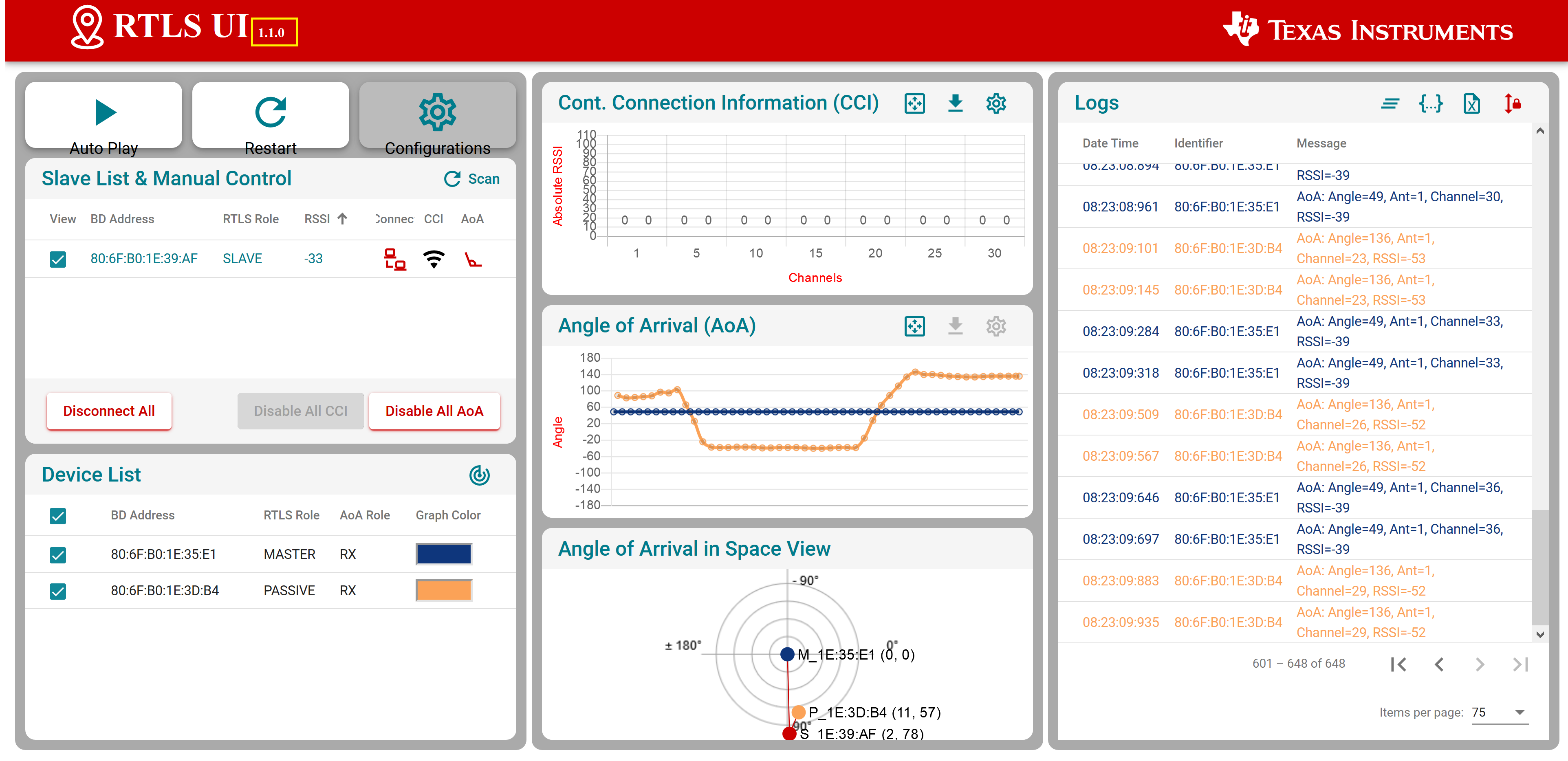

    Can you send a screenshot In the UI I can't seem to find a view that localize an asset e.g track it's location.. I assume I need to configure such software myself. documenation also says in such case "A fourth device is required which is capable of combining the samples from the individual nodes and finding the intersection between the angles" is that correct?
    Here is the RTLS_UI (please verify you are using version 1.1.0 of the RTLS_UI [from SDK 4.10]):
    On the Space View, you can chose where the CTE RX devices are standing and get a location.
    This is partially true. The example uses a fourth device (the computer). In a real system, it is possible to use the passive to find the intersection of the angles.

    Thank you for contacting me this soon! Can we have The regional sales contact information in The Netherlands?  Also from the user interface can you confirm I am understanding it correctly:
    You are using a master and passive device to gather the AoA, at least looking at the log the Master is gathering an AoA and the Passive is. Do you have a reason you are using the passive in this case? Or is it just for prototyping purposes?
    Please review this page to contact TI sales team: https://ticsc.service-now.com/csm
    In our OOB example, each slave device is only able to form one connection. As a result, if you want to have more than one CTE receiver (i.e. more than one locator), you absolutely need one master and one (or several) passive devices.
