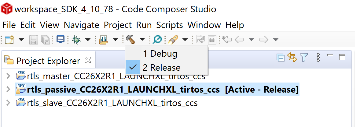

  • Hi Stone,
    Can you try to rebuild your application using the Release configuration (instead of the Debug configuration)?
    To switch to the Release configuration, click on the small arrow next to the hammer icon and select "Release".
    Kind regards,
  • Hi, Clement,
    I'm sorry that Release mode has the same problem as Debug mode did.
    As I know, there is no difference between Debug mode and Release mode except a compile option (-O4) and it seems not a optimization problem.
