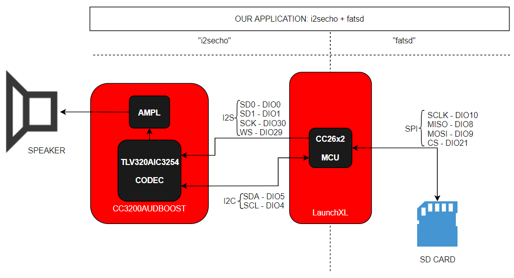

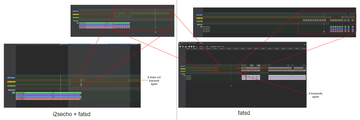

Good afternoon:
We are working on an application to play an audio sample (saved on an SD card) and send it to CC3200AUDBOOST's TLV320AIC3254 codec.
I have tried the "fatsd" and "i2secho" examples separately and both work perfectly.The next step is to implement the code from "fatsd" into "i2secho" and this is where we are having problems since it seems that some kind of problem is happening when opening the SPI communication with the SD card.
Attached is the code:

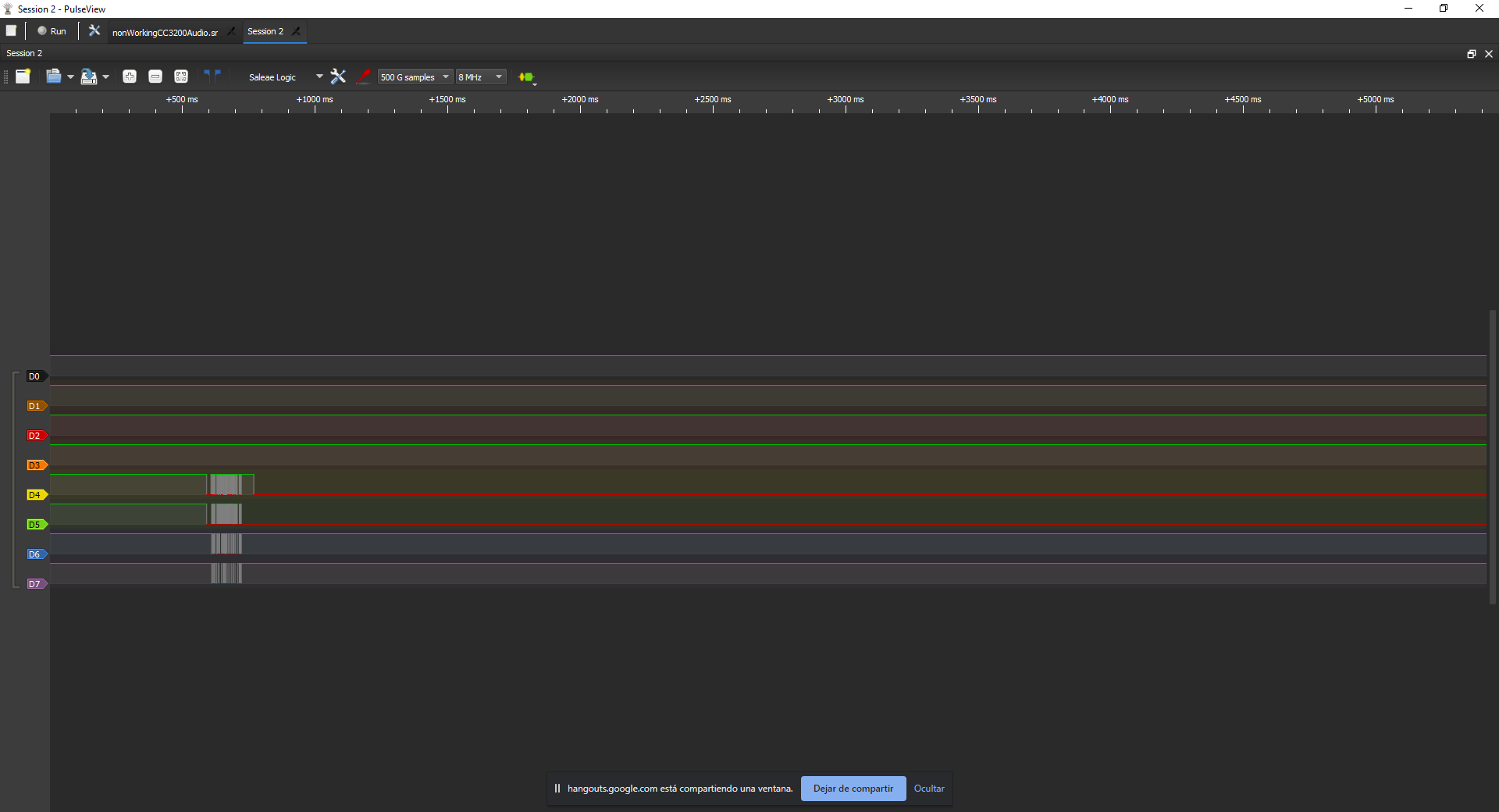

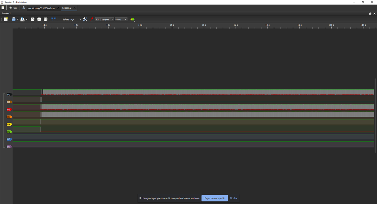

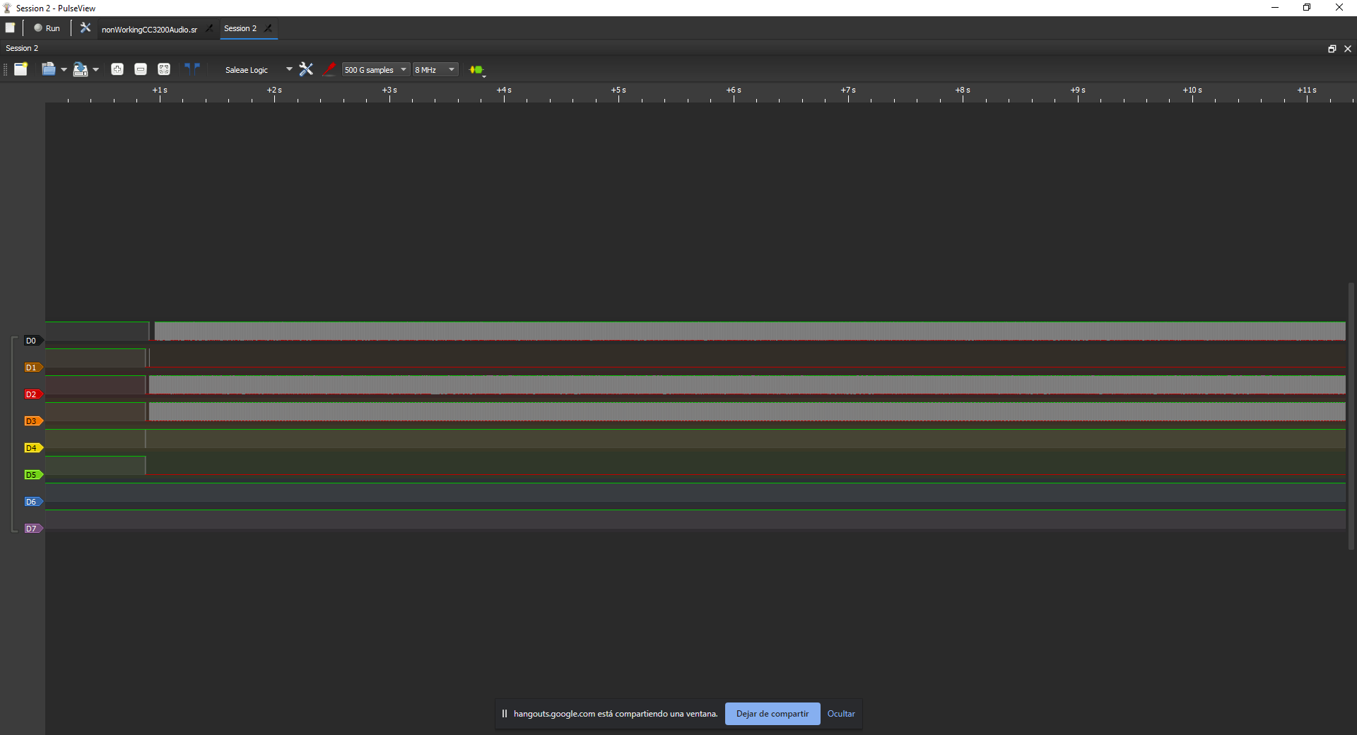

I'm also attaching two screenshots from the logic analyzer so you can see the difference between running the example "fatsd" (first image) and our application (second image). Each line of the logic analyzer is:
- D4: MOSI
- D5: CLK
- D6: MISO
- D7: CS
As you can see, the SPI communication is not carried out, but the code shows the drive mounted correctly.
fopen() always return NULL on opening, but it is possible to see a voltage change level when SDFatFS_open() is called.
We suspect, after debugging, that the bus may be busy.
We have tried the following:
- Try to create instead of opening a file - Nothing (line 233 and followings)
- Try to re-nice SPI and DMA - Nothing
- Try to hardwire CS to GND - Nothing
- Try to disconnect SD reader module - The same
 We'd appreciate it if you could give us a hand with this problem:)
Greetings in advance.

    alvaro torijano said:

  • Hello DavidL,
    DavidL said:
      Sounds like a very cool project. But before jumping into the code, do you have a block diagram to understand how all the pieces go together?
    Here you can see our block diagram:
    As you can see, there's no pin conflicts as you can see in the block diagram picture.

    In picture below you can see SPI comparison between i2secho+fatsd (left) vs fatsd (right):
    Any idea of why the SPI transmission stops? Any suggestions?
  • Hello Jorge,
      That's interesting, is your code hanging after this? Have looked into ROV to see if there is HW exceptions or any errors?
    Anyway, have you tried changing the initialization order? Initialize the SD card before the i2s, please wait until your are done with the SD initialization before initializing the i2s.
    Unfortunately, I do not have access to all of my boosterpacks at this time, so I'll not be able to try this on my side but hopefully we will be able to narrow this down with the ROV and switching the initialization order.
       David
