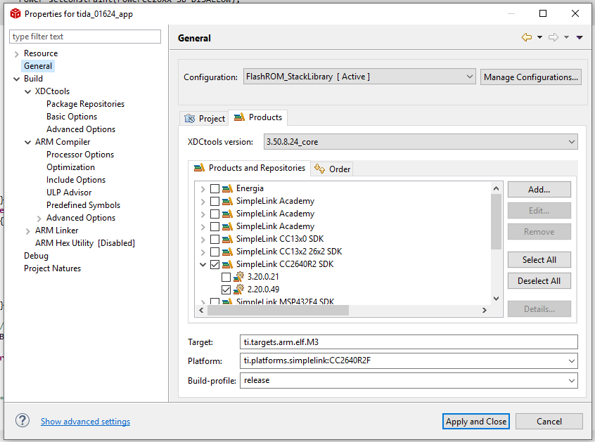

Hi Sundari,
What version of SimpleLink SDK and XDCtools are you using? You can check this in the project properties for the CCS project. Select the project in the CCS project explorer, and select File -> Properties from the menu bar. You can find this info in the Products tab under the General settings section as shown below.

Hi Brandon,
As per your suggestion xdc tool version and SDK version are selected .but still error persist.

Sundari,
Please see the related post below:
https://e2e.ti.com/support/tools/ccs/f/81/p/909057/3359515#3359515
The error is saying that you are not using a compatible XDCTools version. In your case, you are using 3.50.8.24. Please check the release notes for your version of the software package and see what is the required XDCTools version.
ki
Here are the release notes for the SDK in question: http://software-dl.ti.com/simplelink/esd/simplelink_cc2640r2_sdk/2.20.00.49/exports/release_notes_simplelink_cc2640r2_sdk_2_20_00_49.html
