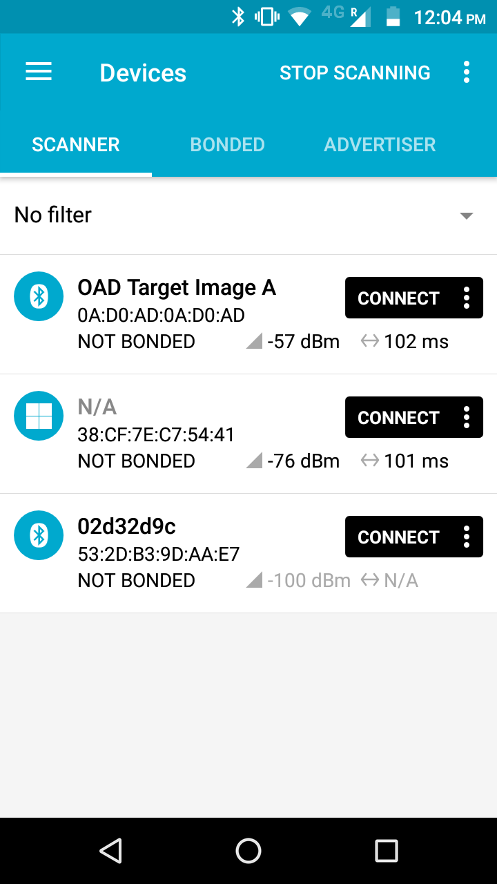

    I am doing on-chip OAD using cc2650. In this the OAD_target(image A) working fine.

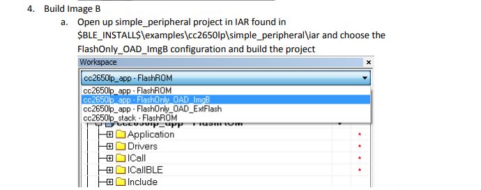

    Problem is creating OAD IMAGE_B(simple_peripheral).
    In CC2640 BLE OAD User's Guide  section 9.4.4 Building OAD Image B contains the steps to followed create the OAD image B. I am following those steps.  After completing those steps i am build the project ,It shows following error in IAR.
    Building configuration: cc2650lp_app - FlashOnly_OAD_ImgB
    Updating build tree...
    Performing Pre-Build Action

    How can i solve this error. Kindly give some ideas on this.

    If you are following the steps from the User's Guide it should work as expected, although I'm not too familiar with the CC2650 OAD project. Have you made any modifications to the project or are you trying to build to example from the SDK? Since you are using IAR, can you try using CCS instead?
