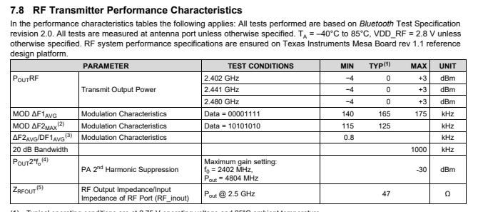

In section 7.8 of LMX9830SM datasheet regarding the RF transmitter performance characteristics shows the power..
It shows minimum (-4 dBm ) and maximum as (+3 dBm). And typical be 0 dBm.
Can you let me know, how they are doing this?

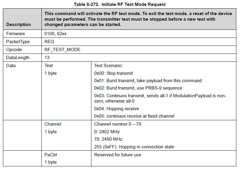

If I want to do RF test mode as mentioned in the LMX9830 software user guide, what will be the default power level.
Is it possible to change the power level as given in shared snapshot.
