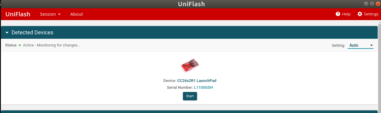

  • For Linux system, you can try to use Uniflash to check if it can recognize your board.
    Here is the screenshot of Uniflash.
    As you can see from the image I sent previously, Uniflash Detected my board CC26X2R1 LauncPad. Does it seem correct to you?

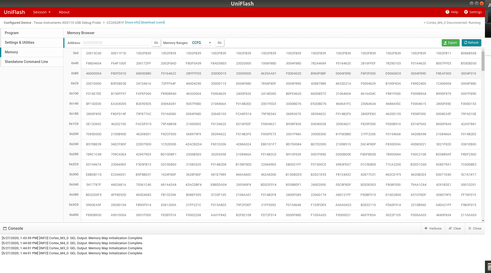

  • This page only means it detects your XDS110. What if you click start and try to read flash data from your CC2642R?
    Here is a screenshot from Uniflash -> Memory -> Read Target Device. There is no problem seen while reading.

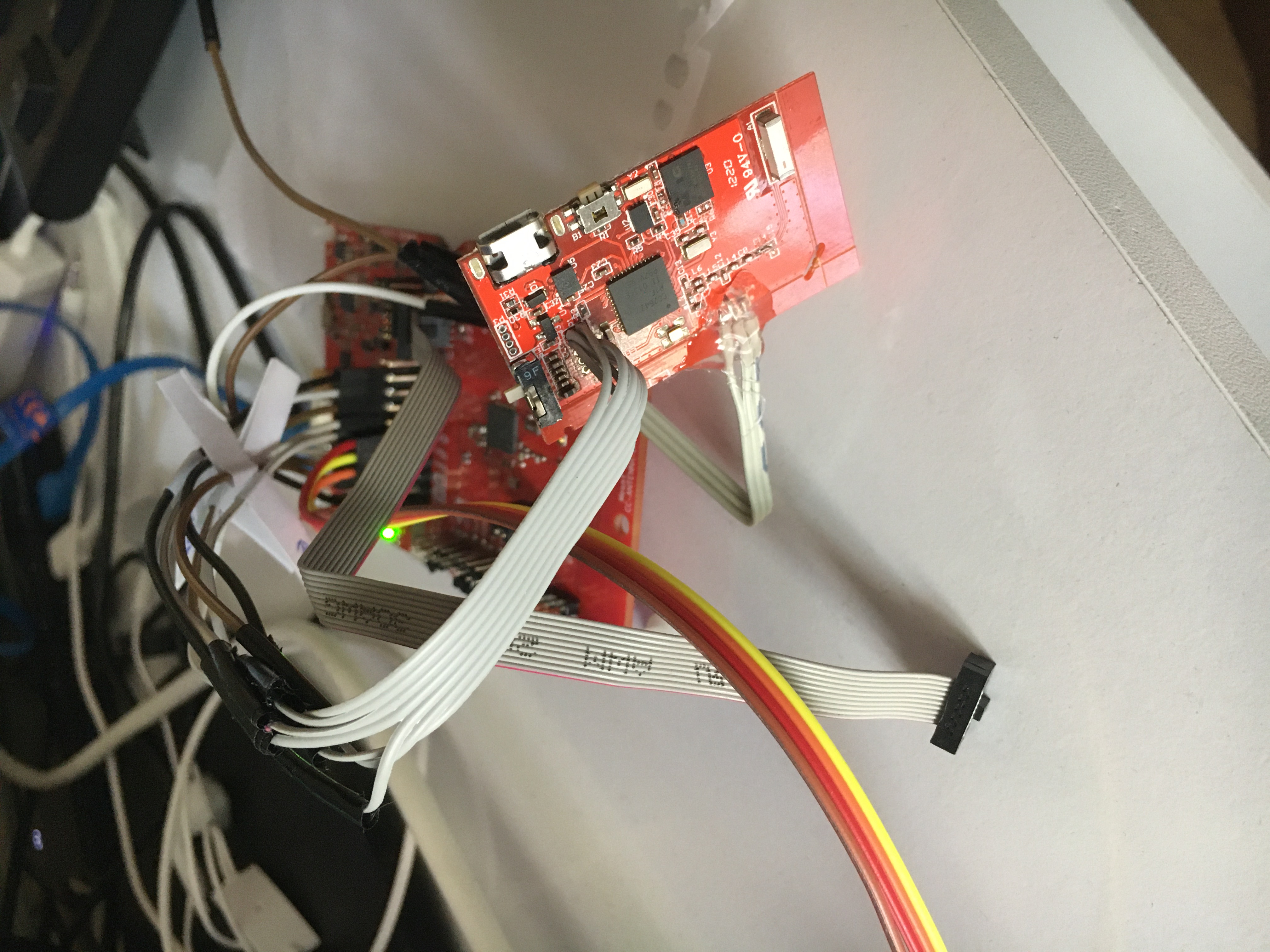

    There is an update. I directly change my custom board's MCU with LaunchBoard' s MCU. As you know it is pintopin. Then, of course, I expected my card to work with OAD example but NO. I did not work. I got same error.
    Actually I am disappointed because my board has Almost Exactly the same schematic with the launch board. I mean the only difference is the External Flash CS pin.
    NOTE THAT: My problem is NOT "OAD_Example not working" because of the CS pin, of course the example will not work directly I know it, My problem -> I cannot Debug my card with CCS. When I pressed "|> Run" button, I got errors just like I mentioned in my first post.

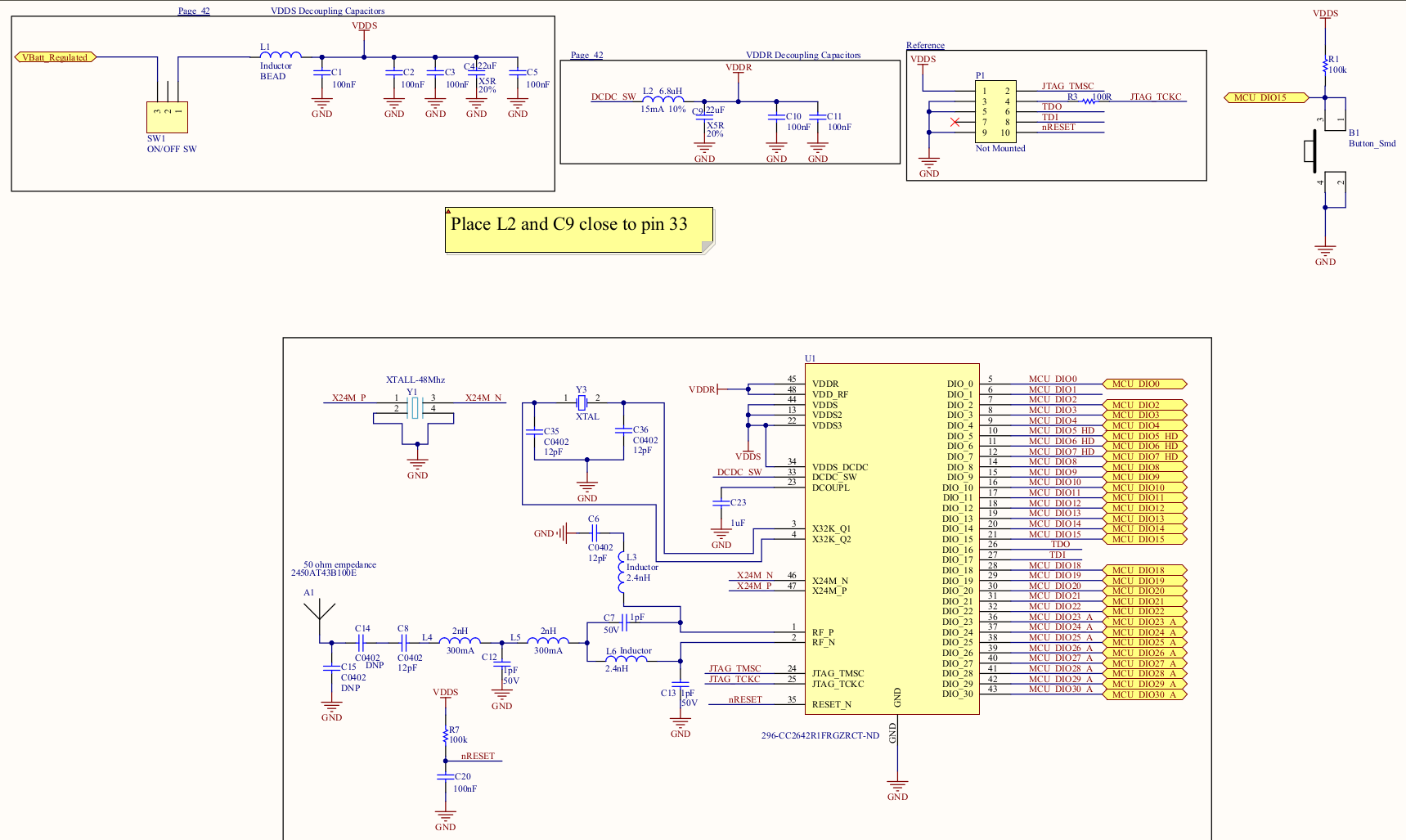

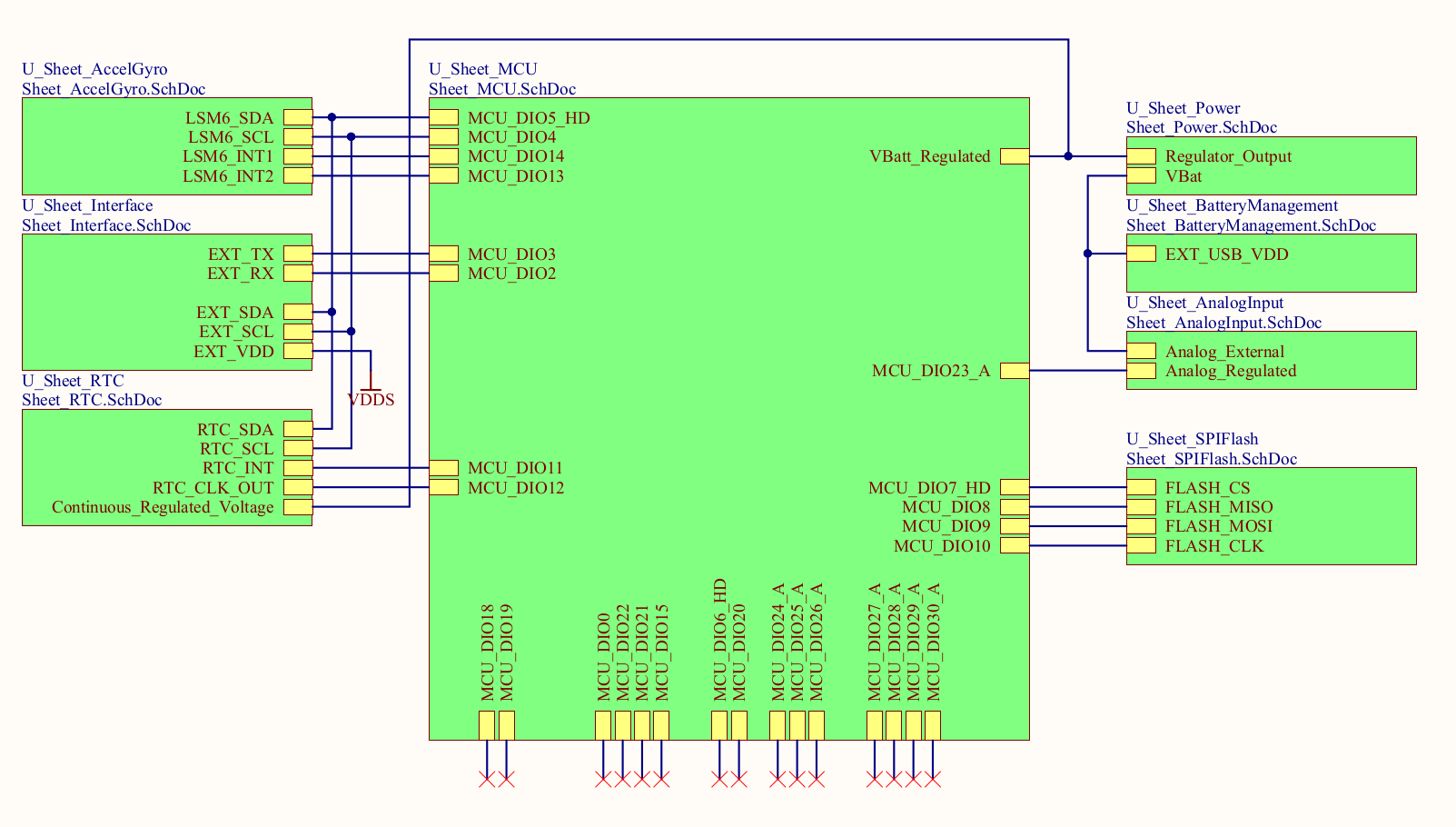

    Here are the schematics of my custom board. Maybe you see a debug interface hardware problem etc.  Any comment is valuable because I am stuck.

  • How Launch Board's debugger part supply voltage to my external card (please see the image in my first post)? I do not think 3v3 volt pin does that because I plugged out 3v3 but I can still upload the code by uniflash and my card works. How could it be possible? I am really confused.

    Have you had anyone at TI review your design before manufacturing it?
    Can you also please clarify the question in your last post?
    Elin
    I am trying to maintain my startup and I am losing my test users, I am really stuck now.
    I did not know TI can review my board. Please but please guide me to review my board.
