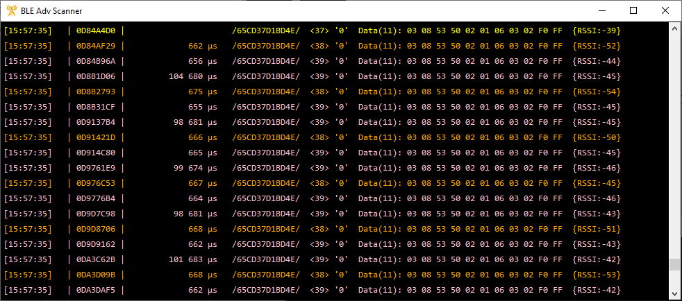

So, now, when I powerup LP-CC2652RB board with simple peripheral project programmed on it, the first thing is that the board will advertise on channels 37 38 and 39. but half the time, the sequence is not respected, and device scan following a curious sequence: one time: 37, followed by 38 and by 39 (this is normal) and after i have this abnormale sequences  (38, 38,39) or (39,38,39)  that doesn't stop until I make a connection with a central. In fact the advertisement on the first channel  (37) seems to be randomly replaced by a advertisement on channel 38 or 39.
Bellow some screenshot of my passive scanner.

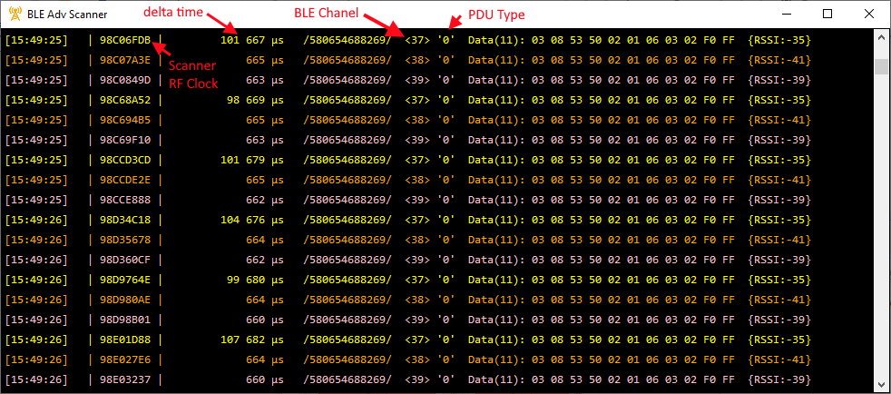

Normale sequence (37, 38, 39):
1st case: after one normal cycle (37, 38, 39) it going to abnormale sequence (38,38,39) and stay with:

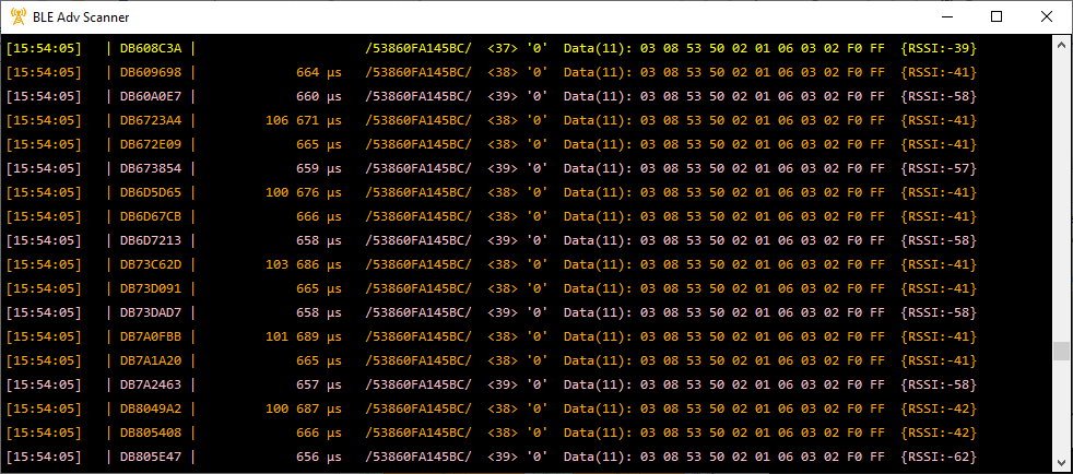

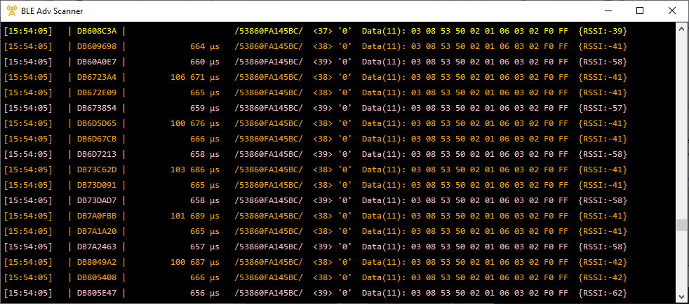

2nd cases: after one normal cycle (37, 38, 39) it going to abnormale sequence (39,38,39) and stay with:

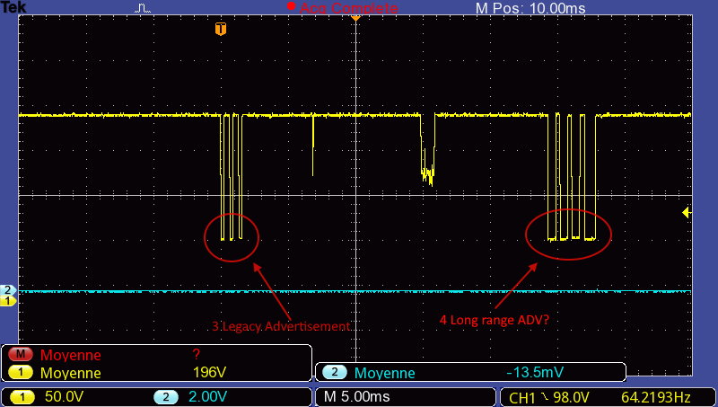

By coupling an RF detector to my oscilloscope, I can clearly see the 3 legacy advertisements, I also see 4 bursts which must correspond to the second set of Advertisements. why 4?

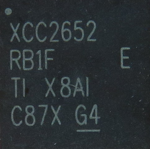

I read that the LP-CC2652RB board are equipped with a preliminary version of the chip, on my board I have the following version:

    On my  launchpad I have the following sticker on it:
    HW Rev : A
    FW: SDK2.10
    1903
    Note:  I reprogrammed Application Firmware with 'simple peripheral project' / SDK 4.10.00.78.
