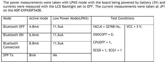

Hi there,
From the developer's Guide , we know the MCU current consumption as the following table , but we care more about the whole current , how about the CC2560 chip current under the same condition , I got   the currrent up to 800uA under the " Bluetooth On + LPM3 "  , is it normal ?
Jeff
