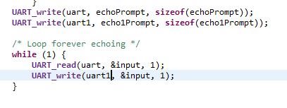

  • This link is helpfull, but how to visualize when i will connect dio 2,3 to arduino tx , rx and then want to see the incoming data on serial monitor.
  • I suppose you just need to connect dio 2,3 (this is first UART pins) to arduino tx , rx and you can use "UART_write(uart1,..." to output message from second UART on serial monitor.
  • I have made the connections as you are telling and used "UART_write(uart1,..." in while loop of the code.
    But still not getting the results on serial monitor.
    I am sending the string characters from arduino side and want to receive it via cc2652 and display them on cc2652 uart.
  • Do you input anything to first UART RX when you test this?
  • In speicific i didnt input anything, just that while testing uart echo i was entering characters on terminal to view them back.
    For details please refer the code in the file attached.

  • This is the expected behavior of uartecho example so what's your issue?
  • Thanks for your patience, my requirement is i want to receive string characters from arduino RX/TX to CC2652 TX/RX and view the incoming characters on CC2652 Serial monitor.
    Its okay if i dont use 2 uarts.
  • You can try to connect CC2652 RX to arduino TX to receive the message and connect CC2652 TX to output to Serial monitor.

  • Do you enable and use two UARTs on LP-CC2652R?
  • Yes I am able to do that but it's not required as one UART is enough for my final application.
  • Yes i have tried to do it.
    Please see the code below:

  • How can i verify that dual uart is working?
  • Do you mean to use one UART or two UARTs?
  • I had shown you how to do at
