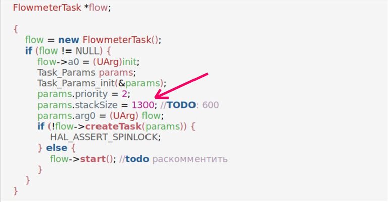

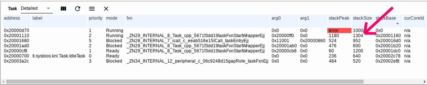

Hi, I need help with Task stack size assignment. When I create Task, I assign a stack size of 1300. After starting the program, I check the stack size with ROV and see that stack size of my Task is 1304. I don’t understand where 4 extra bytes in stack size came from?
Kind regards, Egor.

    This seems to be due to the values chosen. 1300/8 gives a non-integer value (so it might cause a problem when allocating a 64 bits in the stack). As a result, the system increases the stack until the number of 8byte chunk is an integer.
