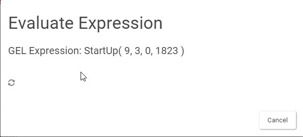

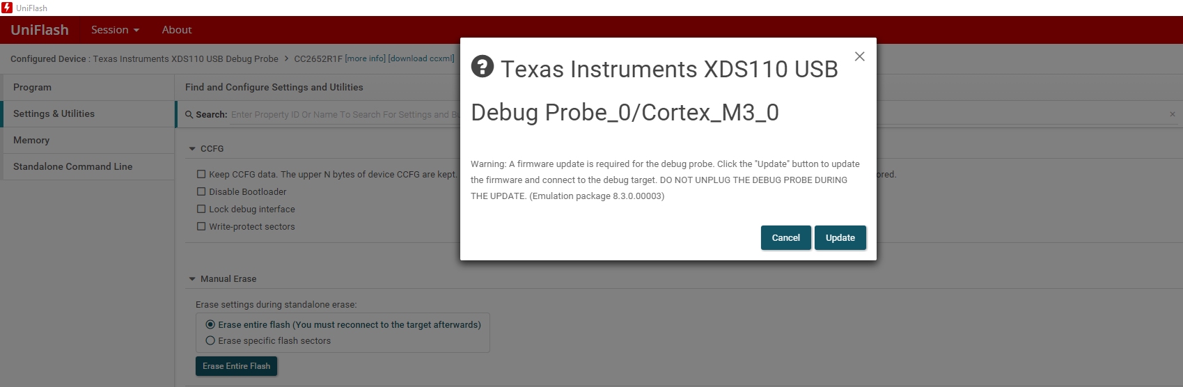

Hello All,
I have been using the cc26x2R1 launchpad for some time, but yesterday when I tried to burn load program or erase entire flash to the launchpad (using Uniflash), it showed a warning for a "firmware update is require for the debug probe. Click the update button to update the firm ware and connect the debug target. Do Not Unplug the debug probe during the update. (Emulation Package 8.3.0.00003)"
when I selected update now, Evaluate expression; Gel Expression: Startup (9,3,0,1823)popup window gets open and update window remains forever and firm ware doesn't get updated.
and at console window showing as:
[Info] cortex_M3_0: GET_OUTPUT: Memory Map Initialization is complete.
[Warning]cortex_M3_0: Warning: "Firmware update is require for the debug probe. Click the update button to update the firm ware and connect the debug target. Do Not Unplug the debug probe during the update. (Emulation Package 8.3.0.00003)"
Please check attached file
