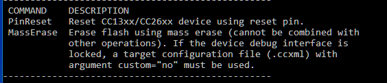

In the Uniflash CLI, it mentions that in order to do a MassErase on a device with a locked debug interface you must do this:
How do you specify custom="no" in a .ccxml file?   Can you give me the syntax for doing that?

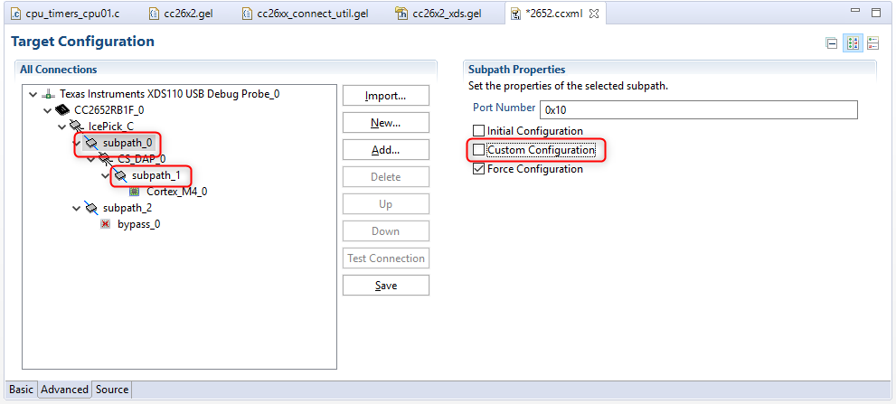

    In the Advanced editor for the Target Configuration File editor, there is checkbox "Custom Configuration" for all the subpath nodes. The message is referring to this checkbox.
    However, I checked with our UniFlash expert and he feels that this message is a bit outdated and that there is a new (more effective) way to perform a Mass Erase on a locked LPRF device. Try:

    I think you will need to go back to using the older command for Mass Erase.
    Which goes back to my comment:
    Basically disable the checkbox for both subpath_0 and subpath_1
    And use the original command:
    > dslite -c <filename>.ccxml -O MassErase

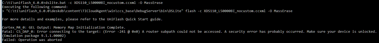

  • I tried this suggestion, and am still getting an issue.  (The 'new' mass erase mode works great, by the way, I just have this extra requirement of handling multiple XDS110 at a time).
    Here is what the command line returns:
    My CCXML file looks like this:

    Can you try clearing the checkbox for subpath_2 (sorry I missed that one in my screenshot)?

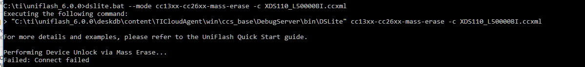

  • I think we are closer, but the command is now not getting all the way through. It throws this error:
    And again here is that .ccxml file I am using.  It works with dslite when I'm trying to flash the device, but throws the error above when trying to mass erase a locked target.   Note that I'm actually using a LAUNCHXLCC2640R2 launchpad as the XDS110 right now. It is connected to my custom board through the 10 pin SWD cable. This is why the serial number is "L50000BI". The production setup has actual standalone XDS110 units... but it should work regardless, right?

    <?xml version="1.0" encoding="UTF-8" standalone="no"?>
    <configurations XML_version="1.2" id="configurations_0">
    <configuration XML_version="1.2" id="Texas Instruments XDS110 USB Debug Probe_0">
    <instance XML_version="1.2" desc="Texas Instruments XDS110 USB Debug Probe_0" href="connections/TIXDS110_Connection.xml" id="Texas Instruments XDS110 USB Debug Probe_0" xml="TIXDS110_Connection.xml" xmlpath="connections"/>
    <connection XML_version="1.2" id="Texas Instruments XDS110 USB Debug Probe_0">
    <instance XML_version="1.2" href="drivers/tixds510icepick_c.xml" id="drivers" xml="tixds510icepick_c.xml" xmlpath="drivers"/>
    <instance XML_version="1.2" href="drivers/tixds510cs_dap.xml" id="drivers" xml="tixds510cs_dap.xml" xmlpath="drivers"/>
    <instance XML_version="1.2" href="drivers/tixds510cortexM.xml" id="drivers" xml="tixds510cortexM.xml" xmlpath="drivers"/>
    <property Type="choicelist" Value="4" id="SWD Mode Settings">
    <choice Name="cJTAG (1149.7) 2-pin advanced modes" value="enable">
    <property Type="choicelist" Value="1" id="XDS110 Aux Port"/>
    </choice>
    </property>
    <property Type="choicelist" Value="0" id="Debug Probe Selection">
    <choice Name="Select by serial number" value="0">
    <property Type="stringfield" Value="L50000BI" id="-- Enter the serial number"/>
    </choice>
    </property>
    <platform XML_version="1.2" id="platform_0">
    <instance XML_version="1.2" desc="CC1310F128_0" href="devices/cc1310f128.xml" id="CC1310F128_0" xml="cc1310f128.xml" xmlpath="devices"/>
    <device HW_revision="1" XML_version="1.2" description="SimpleLink(TM) Sub-1 GHz CC1310 wireless MCU" id="CC1310F128_0" partnum="CC1310F128">
    <router HW_revision="1.0" XML_version="1.2" description="ICEPick_C Router" id="IcePick_C_0" isa="ICEPICK_C">
    <subpath id="subpath_0">
    <property Type="choicelist" Value="1" id="Custom Configuration"/>
    <router HW_revision="1.0" XML_version="1.2" description="CS_DAP Router" id="CS_DAP_0" isa="CS_DAP">
    <subpath id="subpath_1">
    </subpath>
    </router>
    </subpath>
    </router>
    </device>
    </platform>
    </connection>
    </configuration>
    </configurations>
  • Daniel Cambron said:
    I was able to modify the default ccxml with the property to explicitly specify the XDS110 serial number, and it worked great, flashing the particular board that I wanted.
    ah, good to hear!
    I'm still not sure what in my ccxml file isn't jiving with my environment
    When comparing the two ccxml files (yours and the default one), I see that the "Power Selection" setting for yours is set to "Probe supplied power" while the default ccxml has "Target supplied power". the other big difference is that the device for the default is a CC1310, (which is fine for simple connectivity purposes given the basic similarity of the cc13xx and xx26xx devices). Perhaps one of these settings (or a combination of them) is contributing to the issue in your environment (though your ccxml works just fine for me with my 1312).
