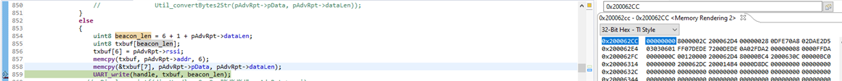

    I have this code in order to send beacon data through UART:
                       uint8 beacon_len = 6 + 1 + pAdvRpt->dataLen;
                       uint8 txbuf[beacon_len];
                       txbuf[6] = pAdvRpt->rssi;
                       memcpy(txbuf, pAdvRpt->addr, 6);
                       memcpy(&txbuf[7], pAdvRpt->pData, pAdvRpt->dataLen);
                       UART_write(handle, txbuf, beacon_len);
    txbuf is in 0x200062DC as seen in the picture:
    and beacon_len is 25 so I would expect to receive A8 70 FE 0D D5 E2 DA 02 01 06 03 03 DE DE 07 FF DE DE 00 72 A2 FD 02 0A 08
    However, I am receiving A8 70 FE 0D D5 E2 DA 02 01 06 03 03 DE DE 07 FF DE DE 00 72 A2 FD 02 0A 0D 08
    I don't understand where is that 0D coming from and why is UART_write printing more bytes than the amount that is told to...
    Solved: (it was a carriage return)
