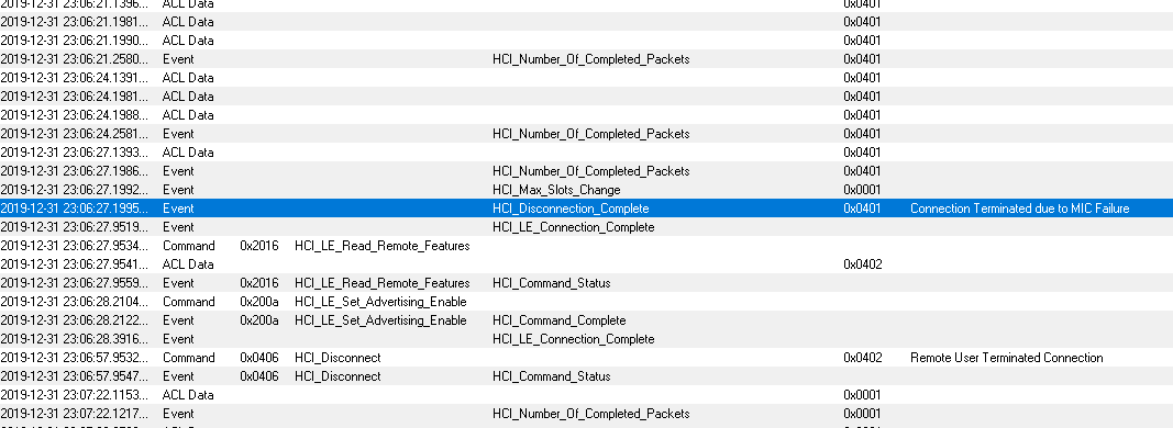

We've encoutered a problem with a random LE disconnection due to MIC Failure during normal operation. It is hard for us to detect the exact reason from this, but we suspect there might be related to invalid hopping sequence numbering. We also see that there is some strange sequences going on in the HCI log. After the MIC failure, we get an unexpected HCI_LE_Connection_Complete from the device withchanged LE address, without having enabled the advertising. Later we are getting a second HCI_LE_Connection_Complete for the same device, which looks quite weird.
We'd like some clarification on these sequences. However, as we and the customers are working under NDA I am not keen on sharing the logs in the public forum. Hence, I've been recommended to request a private channel for the exchange of logs in this case.

    There is no related pairing or encryption procedures going on, the MIC Failure occurs during normal ATT operation, there is also no ongoing pairing or encryption procedures. There is support for BR/EDR and the same device is connected over this transport. The connected unit is an iPhone 7, and we are acting as peripheral towards this device. As far as I know, it's not possible to connect without the peripheral is advertising in this scenario. The central could skip the scanning if it knows the address though.

    I have reviewed the FW logs with a teammate. Although we didn't see disconnects due to MIC failures in the latest logs (8-03) we did see the connections failed due to timeouts on both BT classic and BLE. We are concerned the bandwidth usage on the CC2564 might be too high since shortly after establishing the BLE connection both connections are dropping. Could you try disabling page scanning and inquiry scan to see if that fixes the issue? You can also try increasing the connection interval, latency and timeout for BLE.
    Jesu
  • Hi Jesu
           Yes, the log sent you on 08-03 was not MIC failure but timeout failure. Then I tried to reproduce the MIC case, but could not reproduce that case unfortunately.
           From the log you can know that the timeout failure is another issue we must fix. I will try to disable page scanning and inquiry scanning when connected and to increase the connection interval, latency and timeout for BLE link; then watch if it works or not.
          But at the same time, could you find out why cannot create any connection after the issue that timeout failure happened? I think it is a critical issue for us because the user cannot make a connection.

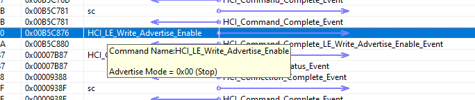

    For disconnects on the BLE side, the FW logs you sent me last time it looks like you stopped advertising after the disconnects and never enable it again. Below is a screenshot of the last advertise enable command sent. Make sure BLE advertising is enable before you try to establish the connection from the iPhone.

       1. From the HCI log, frame 652, you can find that we used HCI_LE_Connection_Update to update the LE link parameters. But chip replied  that HCI command failed with error code( Unsupported Remote Feature/Unsupported LMP feature). So the parameters for that HCI command is right? We did not use host stack from TI but from cybercom.
      2. From the HCI log, frame 2945 and frame 2947, you can find that the two link( BR/EDR and LE link) disconnected with error code timeout. Why for this?
      3. After the two link disconnected, we tried to create another BR/EDR connection at frame 2954. After sent HCI command HCI_Create_Connection, we cannot receive any response for this command for ever!  So it's a fatal issue for us.https://e2e.ti.com/cfs-file/__key/communityserver-discussions-components-files/538/0812.7z
