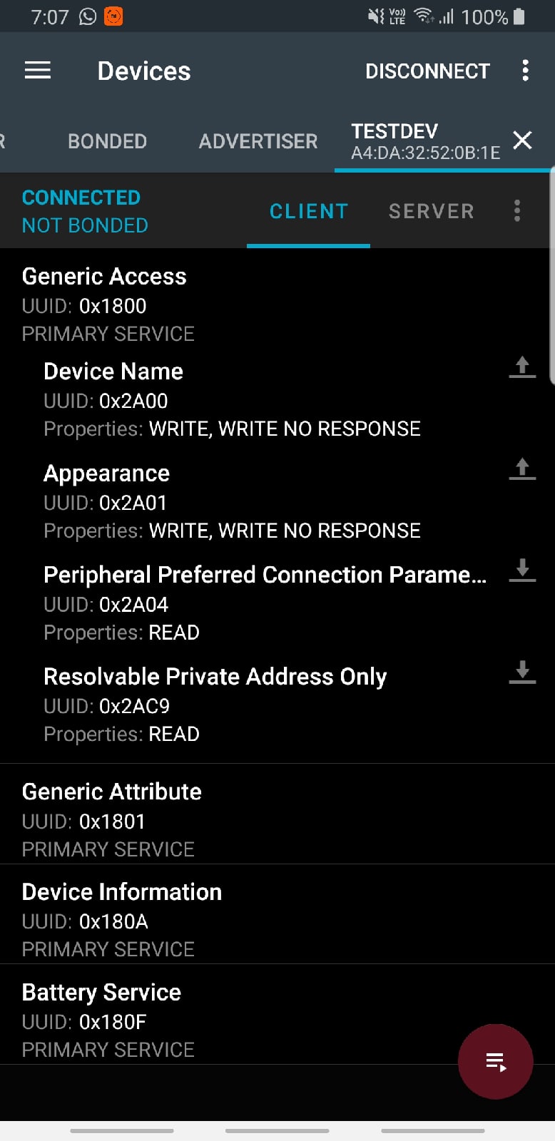

Hi all,
I am trying to learn BLE stack with CC2640R2F. I took simple_peripheral example as a starting point. My task init function looks like this:
static void App_init( void ) {
    ICall_registerApp(&selfEntity, &syncEvent);
    Queue_construct(&appMsgQueue, NULL);
    appMsgQueueHandle = Queue_handle(&appMsgQueue);
    Util_constructClock(&clkPeriodic, App_clockHandler, 1000, 0, false, 0);
    GAP_SetParamValue(GAP_PARAM_LINK_UPDATE_DECISION, GAP_UPDATE_REQ_ACCEPT_ALL);
    GGS_SetParameter(GGS_DEVICE_NAME_ATT, GAP_DEVICE_NAME_LEN, appDeviceName);
    GASS_AddService();
    GGS_AddService(GATT_ALL_SERVICES);
    GATTServApp_AddService(GATT_ALL_SERVICES);
    DevInfo_AddService();
    BAT_AddService();
    GAP_RegisterForMsgs(selfEntity);
    GATT_RegisterForMsgs(selfEntity);
    GATT_InitClient();
    GAP_DeviceInit(GAP_PROFILE_PERIPHERAL, selfEntity, ADDRMODE_PUBLIC, NULL);
I've added my custom battery service (which works fine), but when I am connecting to my board with android with BLE scanning app, I see that GENERIC ACCESS properties are write only (see screenshot).
I've tried to manually set the permissions:
uint8 devNamePermission = GATT_PERMIT_READ;
GGS_SetParameter(GGS_W_PERMIT_DEVICE_NAME_ATT, sizeof(uint8_t), &devNamePermission);
GGS_SetParameter(GGS_W_PERMIT_APPEARANCE_ATT, sizeof(uint8_t), &devNamePermission);

It doesn't work either. The function GATTServApp_RegisterService returns 2 (invalid arg).
I compiled my project with two versions of compiler (16.9.4 and 20.2.1).
I was trying to load different examples (project zero and simple_peripheral with minimal changes due to custom board).
Please tell me where is the problem and how to solve it. And why can't I create my own generic access profile.
Thank you!
    I have assigned an expert to comment.
    Also, which BLE stack and SDK version are you using for your application?
    Michael
  • Hi Nick,
    1) What version of the SimpleLink CC2640R2 SDK are you basing your code on?
    2) Can you call GGS_SetParameter() after GGS_AddService().
    3) GGS is a part of the BLE-Stack library so making your own version wont work.
    4) Regarding GGS_SetParameter() with the permissions I think the GAPGATTServer  may be overwriting the parameters. Let me check this.
    1) I am using SDK version 4.10.01.00
    2) It didn't help
  • I am still trying to figure out the reason. I've tried different compiler versions, different sdk versions. Different examples. Ble5 and ble stack. All the same.
    I am working with CCS 10.1.0.00010. I compiled projects on two different PCs (win and Linux).
    It looks like some kind of data alignment error (wrong bytes are fetched within stack or something like that).
    I am using custom board (basically HM-19 chinese module with 4x4 package). I've made changes in board files (created and included my own board file, remapped pins according to my configuration).
    May be I am missing some config due to different package?
    And almost all the time when I start debug session, Cc2640 hangs on addr 0x1001b986 (some internal library loop). Hardware resetting the device brings everything to normal.
    I am using segger jlink debugger.
