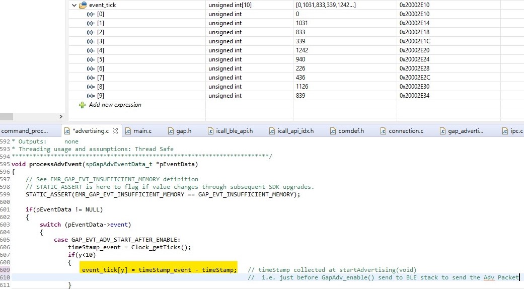

I tried to observe how much delay did TI BLE Stack is adding before sending out the first advertisement data packet by calculating the system tick (i.e. in our project 1 tick = 10 micro second) between GapAdv_enable() and GAP_EVT_ADV_START_AFTER_ENABLE. Following are my observation:
From multiple debug session I had observe, BLE stack adds 0ms to around 16ms for each advertising data set before sending first advertisement data packet for advertising. And same is observe at the Central side while receiving the advertisement data set.

    Because I have set advertisement interval to 319ms. And when timeout occurs, we called GapAdv_enable() to start advertising the new advertisement data set. And I always receive the advertisement data packet with advertising interval between 319ms to 335ms at central side. So this delay is only because of the inherent delay you are talking about. Or Is it added with advDelay you mention above?

    The advDelay is included in the time between the start of advertising events (see BLUETOOTH CORE SPECIFICATION Version 5.1 | Vol 6, Part B, §4.4.2.2.1 Fig 4.3). The delay would have already occurred by the time you receive the GAP_EVT_ADV_START. When GapAdv_enable() is called, you may see an additional delay occur due to the inherent delay I mentioned. This inherent delay which would have occurred by the time you receive the GAP_EVT_ADV_START_AFTER_ENABLE event. The delay seen on the central will most likely be a combination of both. If possible, I would suggest modifying the central's code to be able to handle this variation in delay.
