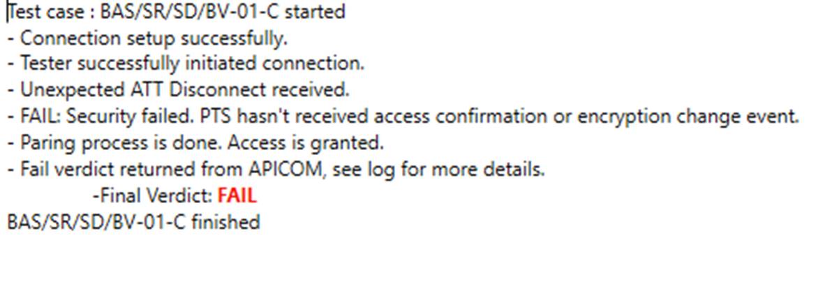

Hi team,
Customer is doing BQB certification. However, they meet connection problem about security.The CC2640R2 device is fail to connect to the PTS host. But this CC2640R2 device works well while connecting to smart phone (iOS or Android).
Below is the error message.
Attachment is test log from test lab.
Below list the bonding parameters in the FW code.

Please help clarify what's the problem. Thank you.
