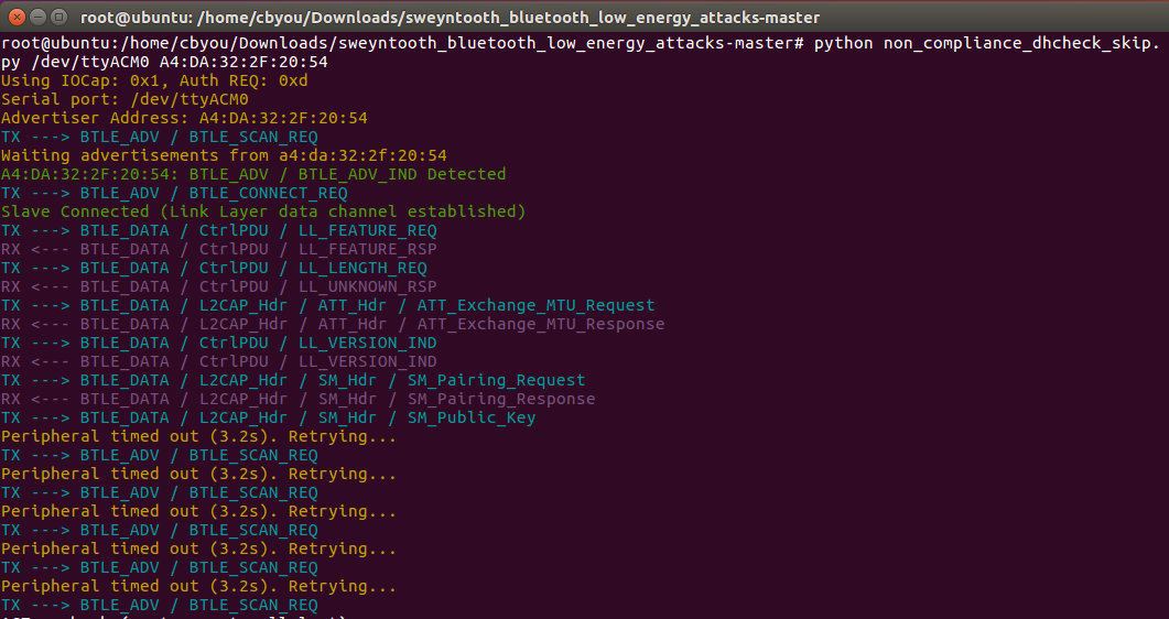

  • Hi Luis,
    I'm the customer of Mr.Albert, who asked the original question.
    Currently, I'm using CC2640 with BLE-STACK v2.2.2, and CC2640R2 with SDK v3.40 for two products.
    We received inquiries about this vulnerability for our products from overseas MFDS, and we must prove that the problem is solved when we apply the SDKs that fixes this vulnerability to our products.
    So I applied 2.2.4 and 4.20 to each product to verify the vulnerability patch and I test with the script file provided by sweyntooth, but It doesn't seem to work gracefully.
    1. Could you provide a modified script file for your SDKs ?
    2. If not, how can we prove the vulnerability fixed for our products? We must explain that how we test and what the results are to the overseas MFDS.
    Calvin

  • Hi Luis,
    I figured out what the problem was.
    The script works well after enabled length extension feature in the peripheral's firmware.
    I test again and the results are:
    1. CC2640 with SDK 2.2.2 : Failed as expected.
    2. CC2640 with SDK 2.2.4 : Success as expected.
    3. CC2640R2F with SDK 4.20.00.04 : Failed unexpectedly. The result is just same with #1's picture.
    So I think the 13593 vulnerability is not patched in the SDK 4.20.00.04.
    Please confirm this.
    Calvin.

  • Hi Luis,
    The DLE is enabled.
    I test our product with SDK4.10(4_10_00_10) and the result is just same with #1's picture.
    I test with "simple peripheral" example hex file of SDK 4.10 and 4.20 and the results are also same.
    I guess the 13593 is not patched on 4.10 and 4.20 both.
    Calvin
