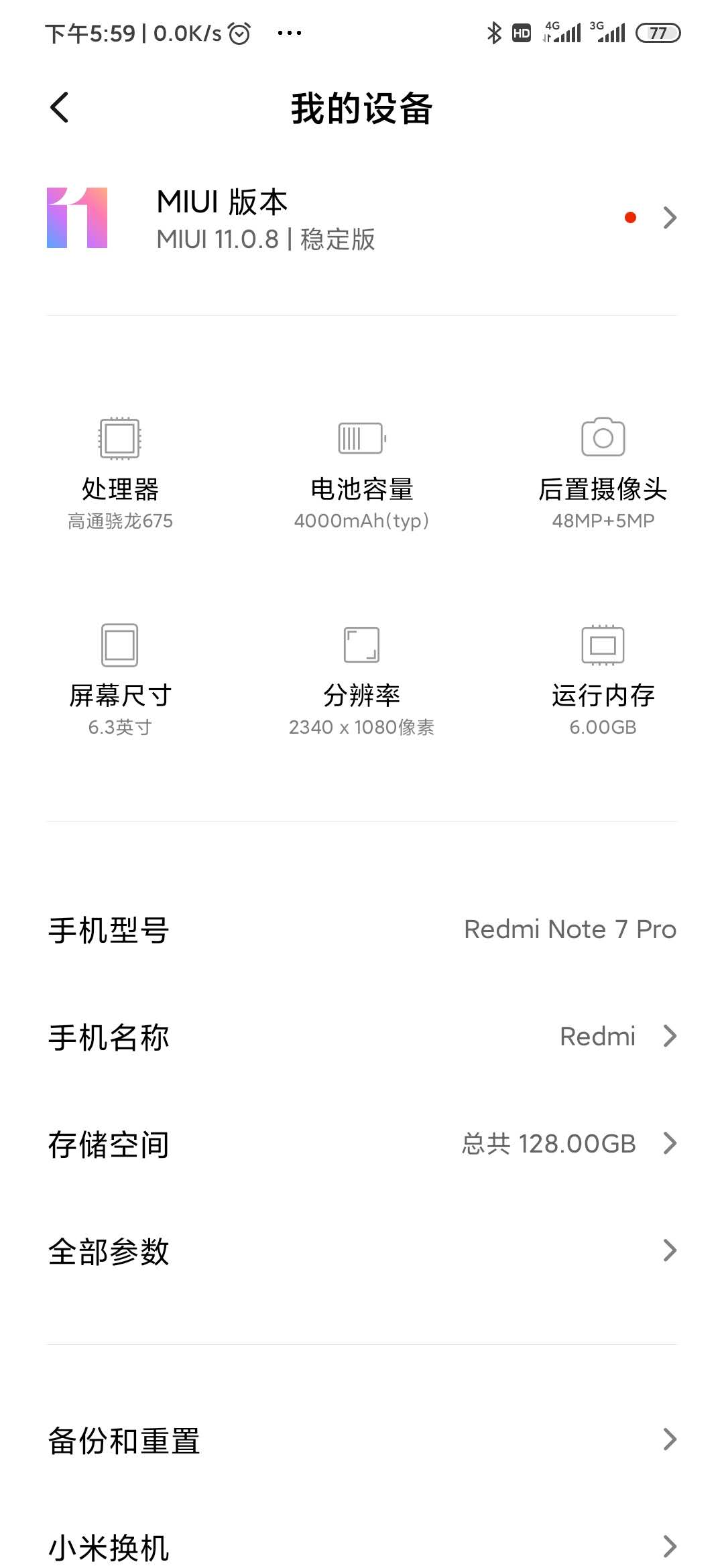

  • Pls kindly refer to the following picture for the mobile phone version

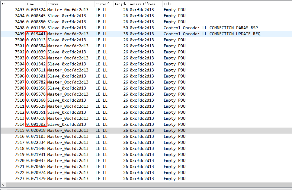

  • Steven,
    As I've said, I'm in the process of obtaining feedback from our team of experts.
    However, on a quick look, it seems that the phone is sending connection events at intervals much more smaller than the permitted. The minimum interval between connection events is 7.5 ms, and as I'm showing in the attached image, the phone jams the TI chip with too-frequent connection events, as close as even less than 1 millisecond! (see for example message #1638 in the image below)
    Please see the image below: (I'm displaying time between packets)
    So, I believe that the cause is that, at least in part, the phone is out of spec.
    Luis

  • Sunny,
    What are your thoughts in the likely root cause that I mentioned? It seems to me that the messages from the phone are coming at a much higher rate than permitted by the Bluetooth specification.
    Also, could you please share some logs of a "good" phone? (maybe another model that works reliably). I'm trying to analyze the communication and compare "pass" vs "fail".
