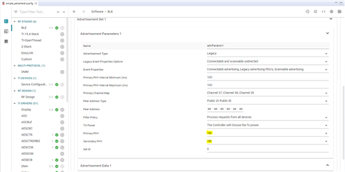

    With the newer SDKs, SysConfig can be used to select the PHY(s) used for advertising, the PHY(s) used for scanning and the PHY used for connection initialization.

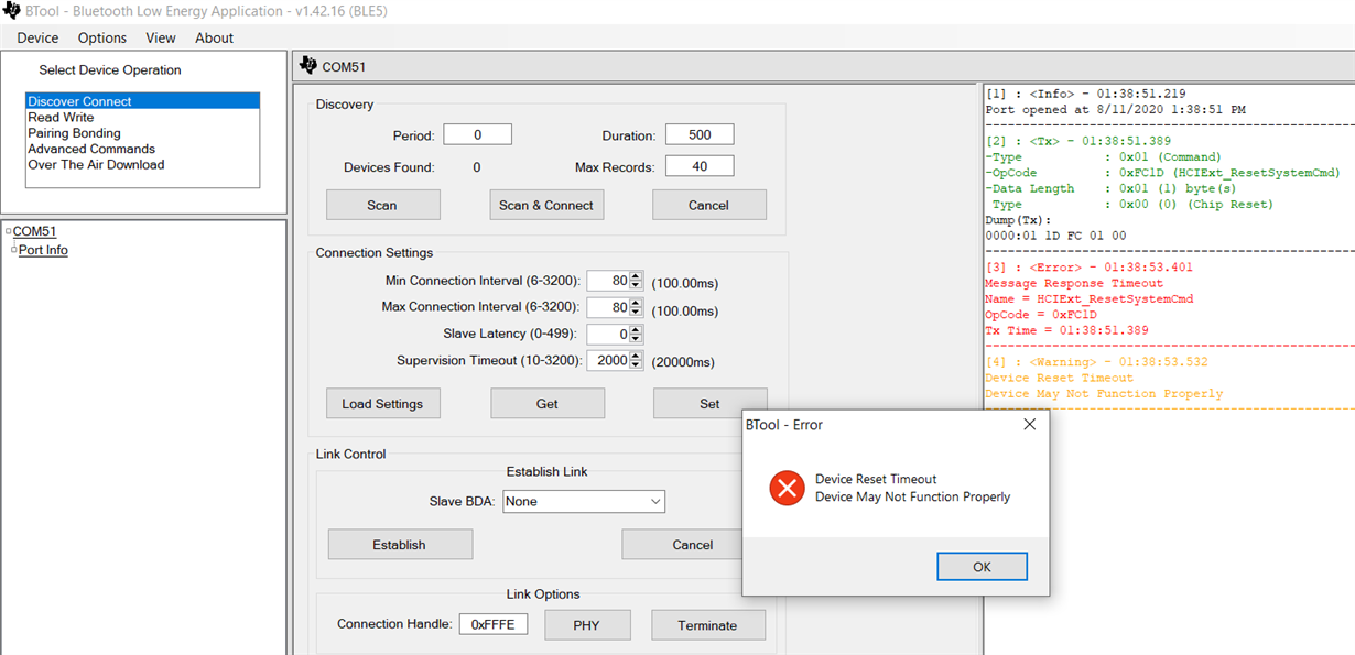

    In addition, in the Stack project (usually named Stack Wrapper), change the value set for the predefined values PHY_2MBPS_CFG and PHY_LR_CFG (both symbols has to be 0x00). The modification has to be made inside TOOL/build_components.opt
    /* BLE Core Spec V5.0 Feature Partition Build Components */
    -DPHY_2MBPS_CFG=0x00
    -DPHY_LR_CFG=0x00
  • Hi Clément,
    After building with the predefined values, the BTOOL can't connect with the LaunchPad with host_test, it shows the error "Device reset timeout". The connection is fine if the predefined value is as default. Do you have any idea what is the cause of this error?
    BTW, is it possible to limit the PHY to 1Mbps only in Simple_peripheral project? I tried to set the advertisment option in sysconfig, but it seems only affect the advertising PHY, the peripheral can still respond to a PHY change request from a central device.

  • Hi Shuyang,
    Obviously I was wrong in my suggestion. It is not possible to deactivate the 2M and coded PHYs in hosttest. Sorry for the misleading answer.
    In a connection, the PHY update is negotiated between the central and the peripheral. Even if the peripheral is allowed to start the procedure, the central will always have the final say (you can review BLUETOOTH CORE SPECIFICATION Version 5.1 | Vol 6, Part B, §5.1.10 for more details). As a result, if a central asks the peripheral to use the 2M PHY then the peripheral will use this PHY.
