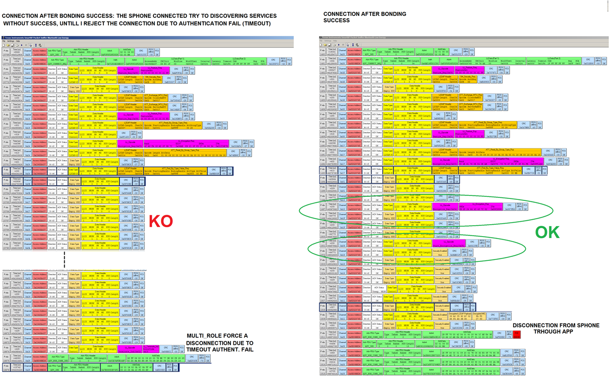

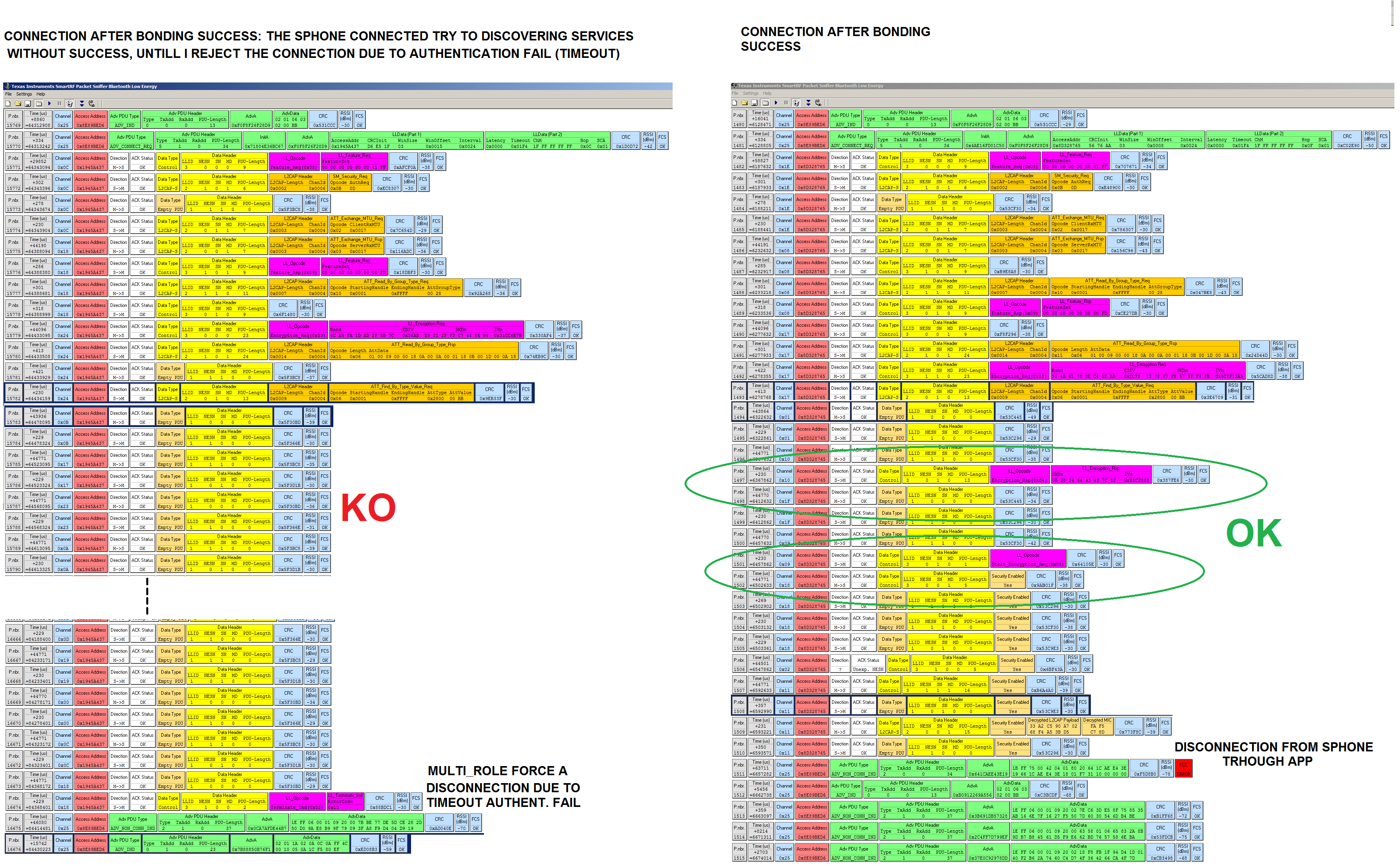

I'm using BLE Scanner o similar APP on my smartphone to test the pairing and bonding process.
At first, the pairing and bonding seems ok( i send the passkey to the multi_role with no problem and i can see the correct bonding complete process).
Once the pairing and Bonding is done, i terminate the link with Sphone.
The problem come when, later, i try to test many times the connections and disconnections between the two device: as expected, during the connection request from the sphone, most of the time multi_role doesn't ask anymore the passkey and everything works fine. But sometime, the multi_role during the connection request seems to lost the LTK, leading to a new pairing and bonding process, wich is not acceptable (from customer point of view).
the error is similar I've found here
https://e2e.ti.com/support/wireless-connectivity/bluetooth/f/538/t/516771?tisearch=e2e-sitesearch&keymatch=Ltk%2525252520ReqUEST%2525252520NegATIVE%2525252520Reply
With bond already made, if a next connection from Sphone is ok with no issue, i can see from
multi_role_processStackMsg() the event (not handled) HCI_LE_LTK_REQ_REPLY (0x201A) while when the connection lead to the problem above, the event (not handled) is HCI_LE_LTK_REQ_NEG_REPLY (0x201B)
The HCI_LE_LTK_REQ_NEG_REPLY event come out randomically, sometime at the first connection I try to do with SPhone, sometime after 20 Link.. I really cannot understand the problem

I'm attaching sniffer log with both the OK and KO behaviours

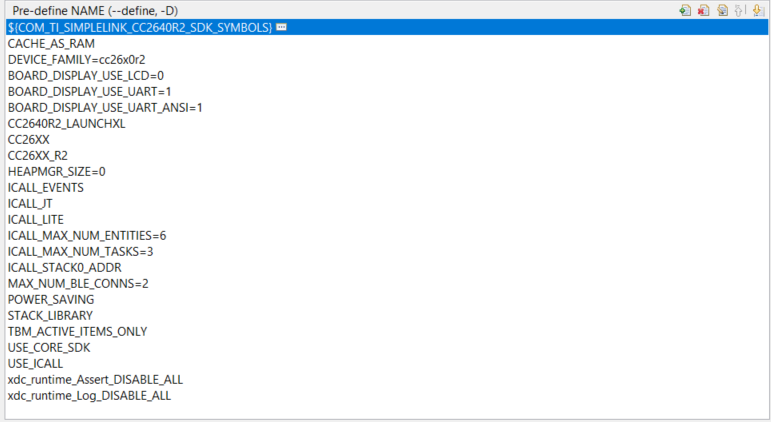

    I try to explain better the strange behaviours I've found this morning using different MAX_NUM_BLE_CONNS
    Case with predefined symbol MAX_NUM_BLE_CONNS=2
    SPhone and Product never paired
    - 1° connection with SPhone -> Pairing and Bonding done with no problem
    - disconnection from SPhone -> I can see from Sphone that the Bonding is kept in memory
    - 2° connection with SPhone -> the Password is required again( I can see from Sphone that the Bonding is lost)-> Pairing Bonding done again with no problem
    - start from now, any SPhone connection and disconnection doesn't cause Bonding lost BUT FOR A RANDOM NUMBER/PERIOD OF TIMES
    The 2° connection is Always required to have a bonding ok (at least for a period of time as i wrote)

    At the moment when I set MAX_NUM_BLE_CONNS to 1, I am not able to recreate the results you described as it shows the multi_role as non connectable. I am debugging the difference in behavior at the moment, however, here are my modifications to the multi_role project. Please confirm that these are the changes you made or if there are additional changes made to the project that I may have overlooked.
    Project: ble5_multi_role_cc2640r2lp_app
    SDK: v1_35_00_33
    Predefined Symbols:
    - CACHE_AS_RAM
    -AUX_AS_RAM
    -OSAL_SNV=1
    -HEAPMGR_SIZE=0
    -MAX_NUM_BLE_CONNS=1
    -GAP_BOND_MGR
    -V42_FEATURES=SECURE_CONNS_CFG

    - In this case no change is necessary to predefined symbol MAX_NUM_BLE_CONNS as this is the default simple peripheral project

    - Keep predefined symbol MAX_NUM_BLE_CONNS=2

  • Hi Jenny,
    I made the modifications as you've described above, but unfortunately from the SPhone side I can't see anymore the message "Password request", so I'm not able to bond any device.
    I've tryed with 3 different SPhone and the result is the same.
    Just to add another test(may be it can be helpful?), I've re-enabled the define GAP_BOND_MGR and in multi.c I've modify your Fix from
        #if !defined(GAP_BOND_MGR)
             // Reenable advertising
             uint8_t advertEnable = TRUE;
             GAPRole_SetParameter(GAPROLE_ADVERT_ENABLED, sizeof(uint8_t), &advertEnable, NULL);
        #endif
    to
      //  #if !defined(GAP_BOND_MGR)
     //   #endif
    just for a try: in that case I can see from the SPhone the message "Password request", however the Bonding still be fail at the first try in some device.
    In this situation, If I re-change MAX_NUM_BLE_CONNS=2 to MAX_NUM_BLE_CONNS=1 the bonding process work well with all the SPhone again
    I don't know if my test its make sense, but i made it just to highlight that if I'm not use the define GAP BOND MANAGER, I can't see from the SPhone the "Password request" message
    Thanks and Regards, Federico

  • Hi Federico,
    After reviewing the files Carlo sent, I believe the root cause of this fix not working is originating from two defines within the build_config.opt.
    1. I believe the behavior of the CCS vs IAR project build config is slightly different. When I tested it in CCS, even though I didn't explicitly see GAP_BOND_MGR present in the predefined symbol window (as shown in the screenshot above) it was still defined which is desired. You are correct, this define needs to be in your build_config.opt. I apologize for the miscommunication on my part for the define GAP_BOND_MGR.
    2. -DV42_FEATURES=SECURE_CONNS_CFG should be commented out. Noted that with this defined, the passkey request was still displaying unwanted behavior.
    After making these changes, I have verified the IAR project you have provided is working as expected with the fix. I sent Carlo a copy through the TI drive, however, I will also post the build_config.opt here for future user's that run into the same issue:

                            combo roles and HOST_CONFIG defines are:
                            Peripheral + Observer  :    PERIPHERAL_CFG+OBSERVER_CFG
                            Central + Broadcaster  :    CENTRAL_CFG+BROADCASTER_CFG
                            Peripheral + Central   :    PERIPHERAL_CFG+CENTRAL_CFG
        lib_search tool:    There is a pre build action for every stack project that runs a tool
                            lib_search.exe. This tool aims to automatically import the correct library
                            files into your project based on the defines in this file.

  • Hi  Jenny,
    thanks for your support. Right now I'm testing the project with the fix suggested.
    Regarding the multi.c you've sent to Carlo, I found that the fix
    #endif
    isn't be grayed out (as you suggested few days ago): it's just because I'm using the define GAP_BOND_MGR so it's like to comment it out ? Basically, if a link is formed succesfully, the Advertising must not be enabled ? Am I right?
    Last question is: because in file.opt I need comment out -DV42_FEATURES=SECURE_CONNS_CFG , what about the security connection level? I'm going to decrease the security during the connection  compared to before?
    Thanks and Regards,
    Federico
  • Hi Federico,
    Hope that testing is successful with this fix!
    Yes you are correct, the fix should have this section greyed out and GAP_BOND_MGR should be defined. Since original issue was that after one connection was being made, it resumes advertising and fails to update the resolving list, having this fix in place it will resume advertising after the bonding/pairing process is completed.
    Removing SECURE_CONNS_CFG I believe will disable the BLE 4.2 stack secure connections pairing procedure feature.
    Jenny
  • Hi  Jenny,
    I'm doing many test with our product, using 2 connection define and your Fix.
    I'm using two different SPhone (Samsung A20 & Huwawei Mate 20 Pro, both with SO Android 10). I've bonded both the SPhone with a couple of products, named 1 and 2.
    After few days of connections/disconnesctions with no problems, during a connection test between Samsung and product 1, the bonded was lost.
    So I immediately check if the bonding was lost also with product 2, but this second bonding was ok. So I've checked also the bonding between Mate 20 Pro with both product 1 and 2 and also in this case the bonding was ok
    I made again a bonding with Samsung and product 1
    A day later it happened the same thing, this time between Huwawei and product 1, and also in that case all the others bonding were ok.
    In this context, how can I understand if the bonding was lost from the SPhone side or from the product side?
    Is it reasonable to think that bonding was lost from the product side, as it happened with two different SPhone (both of which are quite new) ?

    1. In the meantime, would you be able to provide sniffer logs of this as the behavior is different, it might be an entirely different situation. After reviewing the sniffer logs, it might bring more clarity on if the bonding was lost from the SPhone side or from the product side.
    2. I wanted to clarify the test setup. Is it correct to assume that product 1 and 2 are both multi_roles? Additionally it seems like you mentioned that both times when bonding was lost it was SPhone (first time Samsung and second time Huawei) + product 1. Have you ever noticed any bonding lost when using the combination of SPhone (either Samsung or Huawei) + product 2? If not, would you be able to detail the behavioral differences between product 1 and 2 such as number of times reads/writes are performed, bonding parameters, etc. to narrow down if this could be from the product side or SPhone side?
    Thanks Federico!
    Jenny
  • Hi Jenny,
    thanks for your patience and your last Fix.
    The time (3 days of test) before to get in bonding lost is not really indicative because it's strongly dependent from the number of test I'm doing(connection/disconnection) with SPhone and products.
    Both product 1 and 2 are identical and are running as multi_role. Yeah, the bonding was lost also with product2, a day later.
    I will try to record a bonding lost with the sniffer if you think that after your Fix this may be another different issue
