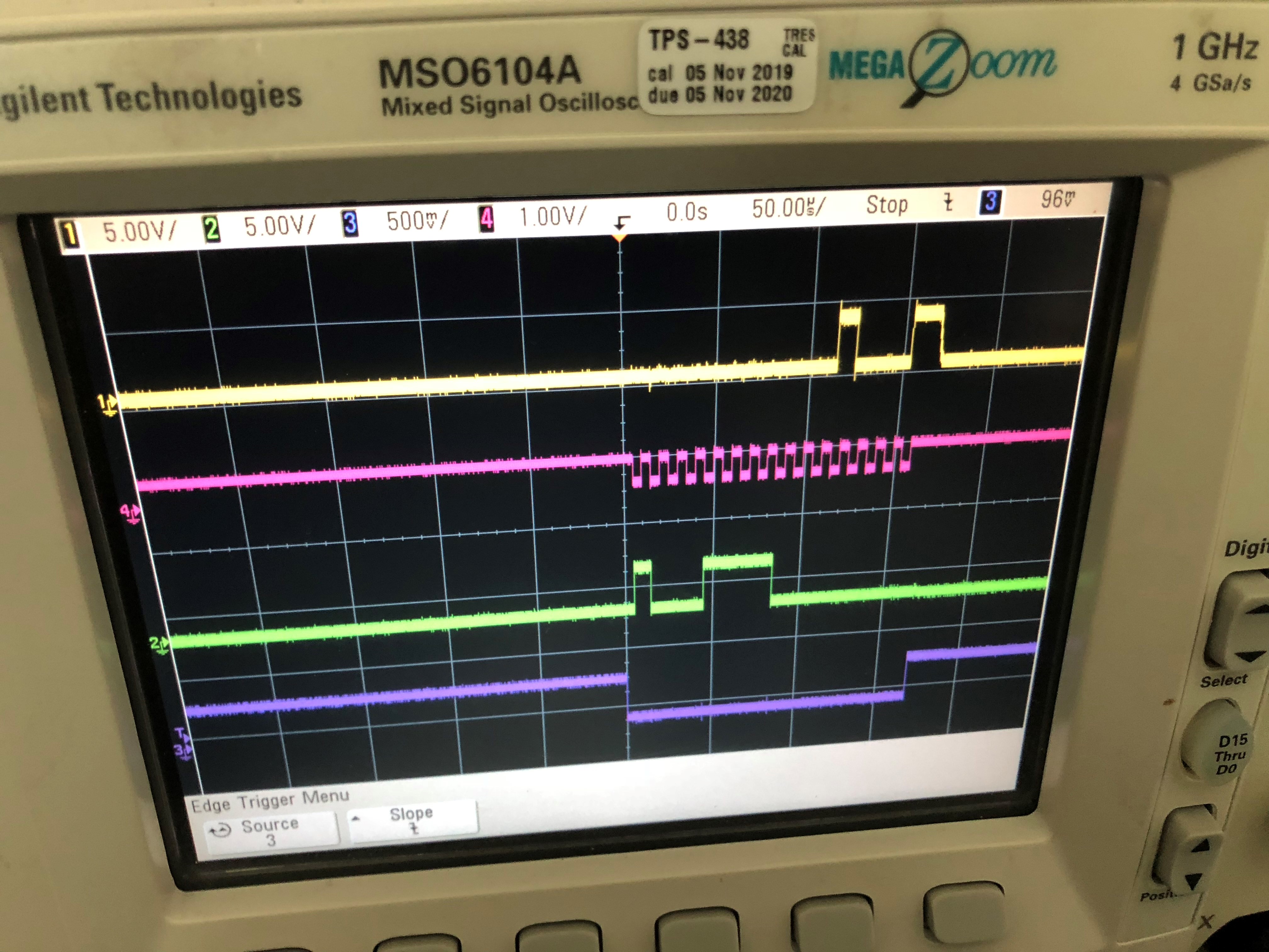

CCS/LAUNCHXL-CC26X2R1: LAUNCHXL-CC26X2R1 SPI not working with Accelerometer
Part Number: LAUNCHXL-CC26X2R1
Is there any sample code or an example to make SPI Acclerometer work with CC2652?
I tried to use SPIMaster in the SDK and modify it. But no luck.
I can't even read device ID (Who_am_I)?
My accelerometer (IIS3DHCC from ST Micro) has value of 0x11 at address 0x0F. But I read 0xFF instead of 0x11.
I need sample code just to read Who_am_I correctly. Then I know how to do the rest.
I got this working in Arduino environment in less than 2 hours. But I can't get it to work in Code Composer even after spending 2 days.
Please help.
KM
  • Hi Kiran,
    Have you considered frame format and clock rates of the device in question? Could you share what you are doing in code?
  • Hi M-W;
    I am trying to read WHO_AM_I of IIS3HCC accelerometer from ST Micro. The REG address is 0x0F and value is 0x11 i.e. 17 decimal. But I get 536880248.
    I started with SPIMaster code and removed R89 from the LaunchXL-CC26X2R1, so there is no conflict with the CS pin.
    I changed the speed to 1000000 and I am not using Slave Ready signal (DIO21).
    I commented "sem_wait(&masterSem);". So there is no wait.
    I changed the TX and RX buffers from char to int.
    This what I get on my Terminal;

    Please see attached code. I am also including my Arduino code which works and I am trying to implement that in Code Composer.
    KM

    Today I didn't get the logic analyzer, but got the 4-channel scope. I got my Arduino Nano and IIS3DHCC eval board working and took the picture of the cycle reading "WHO_AM_I" register and got value 0x11h (17 decimal). On the SDO I saw data 0001001.
    Then I got back to my setup of LauncXL-CC26X2R1 and IIS3DHCC eval board with the changes you recommended. I got 0 on the terminal port and the scope also showed data. I looked into the Arduino code and found that we need to send 0x8F instead of 0x0F as 1st byte. So I made following change to your code;
    masterTxBuffer[0] = 0x8F;
    This worked good and I saw SDO showing 00010001 (0x11h) as supposed to. But on my terminal I still was reading 0. So I made following change to your code;
    Display_printf(display, 0, 0, "Master received: %d", masterRxBuffer[1])
    WIth this change on my terminal I got 17 (0x11h) as supposed to and the scope also I could see SDO with value 00010001.
    I am attaching the scope picture for your record. Signals from bottom to top are CS, SDI, CLK and SDO.
    I will try rest of the code tomorrow and let you know the progress. I am sure I should be able to make rest of the code work, like my Arduino code.
