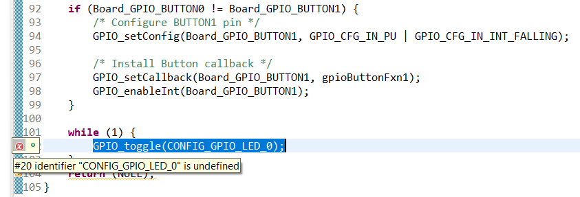

I have tried using GPIO toggling as mentioned in the lab practice but I see these errors could you help if I missed adding any directives or any?

How have you configured the DIO you want to toggle? As the error message indicate you are not using a identifier that exist and you have to change this. If you use the CC2640R2F LP, you should try to use Board_GPIO_LED0/ Board_GPIO_LED1
Also see https://e2e.ti.com/support/wireless-connectivity/sub-1-ghz/f/156/t/711372?CC1312R-Unable-to-modify-value-of-GPIOs-in-CC1312R on how the naming in the board files are set-up.

I am following this link and it didn't say any where to buy this extra MCU. I am using the CC2640R2F board that I have with me and have modified it in release.cfg file then imported the gpiointerrupt_CC2640R2_LAUNCHXL_tirtos_ccs file and in the gpiointerupt.c as mentioned I made the changes. Please suggest me if I am missing anything.

Your question is related to the GPIO driver and I gave you a couple of hints to try out. Please read the E2E post I linked to, this explains how the GPIO driver links a name to an actual DIO. The GPIO driver implementation is the same for all chips in the SimpleLink family, I have not said anything about buying an extra MCU.
