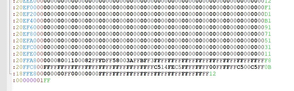

I am trying to program a custom board and I am getting this error
>Initiate access to target: XDS-L50000DQ using 4-pin cJTAG.
>Create XBAL object failed: Debug interface is locked.
>XBAL EB pointer is null.
>Failed to create device object.
Before this, I tried to program the board using UART serial bootloader and the I was able to flash program using SmartRF Flash Programmer V2 but the firmware isn't running. And after that I couldn't flash also, the backdoor enable button I set was also not working.
I tried to mass erase the board using XDS110, but I am getting the above-mentioned error.
Thanks in Advance
  • I suspect that you manage to overwrite the CCFG section of the flash with the image you managed to flash and threby bricked the chip.
    Please check the content of the last flash page in the hex file you used.
  • this is the last flash page which contains the ccfg section
    Assuming the chip is bricked, how I can un-brick the chip and reflash the image file?
    thanks in advance
  • Please use the "Insert/ Edit media" to include a picture in a post.
    If a mass erase does not work, you have bricked the device which means that you are unable to access the chip and you have to replace it.
    Please note that in the CCFG you can set to which degree you can access the chip after you have flashed it. If you disable the ability to mass erase you would not be able to do so.
  • Sorry, this the last page in flash memory.

    This is the ccfg file I have used to flash the chip
  • Can you point out my mistakes and possible solutions?
    1. I want to use serial bootloader for flashing and backdoor enable button is connected to pin 20.
    2. I would like to be able to mass erase the flash memory.
    3. Using a balun+chip antenna setup for RF
    4. using both 24Mhz and 32.768KHz oscillators
    5. Debug access should be enabled
    I guess this became more of a ccfg question, can you please clear my doubts
    Thanks in advance,
    -Rajesh Pushparaj
  • Try to do mass erase from Flash Programmer 2 to see if it can unbrick your chip.
  • Hi Yikai Chen,
    I tried doing mass erase but I got this error
  • Try to set Flash programmer 2 to use 2-pin Cjtag to do mass erase.
    e2e.ti.com/.../3386.11.png
  • I tried that too, and the flash programmer wasn't able to detect the chip in the first place.
  • From the CCFG it looks like you should in theory be able to do mass erase since you haven't disabled this option. But it looks like you have locked the JTAG interface etc in the CCFG_TAP_DAP_0/ CCFG_TAP_DAP_1 fields and hence the tools are not able to access the chip. I would advice that you are not changing this part of the CCFG early in the development.
    Did you change something else than the bootloader fields in CCFG.c?
  • Apart from this, I have changed the "SET_CCFG_MODE_CONF_SCLK_LF_OPTION"  to "0x1" since I am using an external LF 32.768KHz clock
    previously it was set to "0x2"
    And also to add up few things about my debug environment, I am using XDS110 from CC2640R2F launchpad to debug my custom board.
  • Could you post your ccfg.c file?
  • I have attached the ccfg.c file in the thread, please check it.
  • Sorry, you posted several posts in this thread and it looks like I didn't see the one with the ccfg.
    under:
    '// Debug access settings
    you have set a few entries to "access disable". For debugging keep this section at "access enabled" and change this as the last step of the code development.
  • Do I have to enable access for all the entries in this section?
    Can you please tell me what entries should I enable access and what not?
  • For debug, keep the entries at the default setting.
    For what you should use in your final product, see the introduction for the "Device Configuration" chapter in https://www.ti.com/lit/ug/swcu117i/swcu117i.pdf
  • what is the default setting, can you share that code section with default settings for which debugging is enabled?
  • I changed the chip and now the smartRF flash programmer was able to detect the chip.
    please guide me through the ccfg.c file setting to make sure not to brick the Chip again.
  • You can see the default CCFG.c by importing any driver example from the SDK.
  • Is this setting correct for using an external 32.768KHz oscillator ?
  • I attach ccfg.c for your reference.

    #define SET_CCFG_VOLT_LOAD_0_VDDR_EXT_TP5               0xFF
    #define SET_CCFG_VOLT_LOAD_0_VDDR_EXT_TM15              0xFF
    #define SET_CCFG_VOLT_LOAD_1_VDDR_EXT_TP125             0xFF
    #define SET_CCFG_VOLT_LOAD_1_VDDR_EXT_TP105             0xFF
    #define SET_CCFG_VOLT_LOAD_1_VDDR_EXT_TP85              0xFF
    #define SET_CCFG_VOLT_LOAD_1_VDDR_EXT_TP65              0xFF
    #define SET_CCFG_RTC_OFFSET_RTC_COMP_P0                 0xFFFF
    #define SET_CCFG_RTC_OFFSET_RTC_COMP_P1                 0xFF
    #define SET_CCFG_RTC_OFFSET_RTC_COMP_P2                 0xFF
    #define SET_CCFG_FREQ_OFFSET_HF_COMP_P0                 0xFFFF
    #define SET_CCFG_FREQ_OFFSET_HF_COMP_P1                 0xFF
    #define SET_CCFG_FREQ_OFFSET_HF_COMP_P2                 0xFF
    // Concatenate bit fields to words.
    // DO NOT EDIT!
    #define DEFAULT_CCFG_EXT_LF_CLK          ( \
    	 ((((uint32_t)( SET_CCFG_EXT_LF_CLK_DIO                          )) << CCFG_EXT_LF_CLK_DIO_S                          ) | ~CCFG_EXT_LF_CLK_DIO_M                          ) & \
    	 ((((uint32_t)( SET_CCFG_EXT_LF_CLK_RTC_INCREMENT                )) << CCFG_EXT_LF_CLK_RTC_INCREMENT_S                ) | ~CCFG_EXT_LF_CLK_RTC_INCREMENT_M                ) )
    #define DEFAULT_CCFG_MODE_CONF_1         ( \
    	 ((((uint32_t)( SET_CCFG_MODE_CONF_1_ALT_DCDC_VMIN               )) << CCFG_MODE_CONF_1_ALT_DCDC_VMIN_S               ) | ~CCFG_MODE_CONF_1_ALT_DCDC_VMIN_M               ) & \
    	 ((((uint32_t)( SET_CCFG_MODE_CONF_1_ALT_DCDC_DITHER_EN          )) << CCFG_MODE_CONF_1_ALT_DCDC_DITHER_EN_S          ) | ~CCFG_MODE_CONF_1_ALT_DCDC_DITHER_EN_M          ) & \
    	 ((((uint32_t)( SET_CCFG_MODE_CONF_1_ALT_DCDC_IPEAK              )) << CCFG_MODE_CONF_1_ALT_DCDC_IPEAK_S              ) | ~CCFG_MODE_CONF_1_ALT_DCDC_IPEAK_M              ) & \
    	 ((((uint32_t)( SET_CCFG_MODE_CONF_1_DELTA_IBIAS_INIT            )) << CCFG_MODE_CONF_1_DELTA_IBIAS_INIT_S            ) | ~CCFG_MODE_CONF_1_DELTA_IBIAS_INIT_M            ) & \
    	 ((((uint32_t)( SET_CCFG_MODE_CONF_1_DELTA_IBIAS_OFFSET          )) << CCFG_MODE_CONF_1_DELTA_IBIAS_OFFSET_S          ) | ~CCFG_MODE_CONF_1_DELTA_IBIAS_OFFSET_M          ) & \
    	 ((((uint32_t)( SET_CCFG_MODE_CONF_1_XOSC_MAX_START              )) << CCFG_MODE_CONF_1_XOSC_MAX_START_S              ) | ~CCFG_MODE_CONF_1_XOSC_MAX_START_M              ) )
    #define DEFAULT_CCFG_SIZE_AND_DIS_FLAGS  ( \
    	 ((((uint32_t)( SET_CCFG_SIZE_AND_DIS_FLAGS_SIZE_OF_CCFG         )) << CCFG_SIZE_AND_DIS_FLAGS_SIZE_OF_CCFG_S         ) | ~CCFG_SIZE_AND_DIS_FLAGS_SIZE_OF_CCFG_M         ) & \
    	 ((((uint32_t)( SET_CCFG_SIZE_AND_DIS_FLAGS_DISABLE_FLAGS        )) << CCFG_SIZE_AND_DIS_FLAGS_DISABLE_FLAGS_S        ) | ~CCFG_SIZE_AND_DIS_FLAGS_DISABLE_FLAGS_M        ) & \
    	 ((((uint32_t)( SET_CCFG_SIZE_AND_DIS_FLAGS_DIS_TCXO             )) << CCFG_SIZE_AND_DIS_FLAGS_DIS_TCXO_S             ) | ~CCFG_SIZE_AND_DIS_FLAGS_DIS_TCXO_M             ) & \
    	 ((((uint32_t)( SET_CCFG_SIZE_AND_DIS_FLAGS_DIS_GPRAM            )) << CCFG_SIZE_AND_DIS_FLAGS_DIS_GPRAM_S            ) | ~CCFG_SIZE_AND_DIS_FLAGS_DIS_GPRAM_M            ) & \
    	 ((((uint32_t)( SET_CCFG_SIZE_AND_DIS_FLAGS_DIS_ALT_DCDC_SETTING )) << CCFG_SIZE_AND_DIS_FLAGS_DIS_ALT_DCDC_SETTING_S ) | ~CCFG_SIZE_AND_DIS_FLAGS_DIS_ALT_DCDC_SETTING_M ) & \
    	 ((((uint32_t)( SET_CCFG_SIZE_AND_DIS_FLAGS_DIS_XOSC_OVR         )) << CCFG_SIZE_AND_DIS_FLAGS_DIS_XOSC_OVR_S         ) | ~CCFG_SIZE_AND_DIS_FLAGS_DIS_XOSC_OVR_M         ) )
    #define DEFAULT_CCFG_MODE_CONF           ( \
    	 ((((uint32_t)( SET_CCFG_MODE_CONF_VDDR_TRIM_SLEEP_DELTA         )) << CCFG_MODE_CONF_VDDR_TRIM_SLEEP_DELTA_S         ) | ~CCFG_MODE_CONF_VDDR_TRIM_SLEEP_DELTA_M         ) & \
    	 ((((uint32_t)( SET_CCFG_MODE_CONF_DCDC_RECHARGE                 )) << CCFG_MODE_CONF_DCDC_RECHARGE_S                 ) | ~CCFG_MODE_CONF_DCDC_RECHARGE_M                 ) & \
    	 ((((uint32_t)( SET_CCFG_MODE_CONF_DCDC_ACTIVE                   )) << CCFG_MODE_CONF_DCDC_ACTIVE_S                   ) | ~CCFG_MODE_CONF_DCDC_ACTIVE_M                   ) & \
    	 ((((uint32_t)( SET_CCFG_MODE_CONF_VDDR_EXT_LOAD                 )) << CCFG_MODE_CONF_VDDR_EXT_LOAD_S                 ) | ~CCFG_MODE_CONF_VDDR_EXT_LOAD_M                 ) & \
    	 ((((uint32_t)( SET_CCFG_MODE_CONF_VDDS_BOD_LEVEL                )) << CCFG_MODE_CONF_VDDS_BOD_LEVEL_S                ) | ~CCFG_MODE_CONF_VDDS_BOD_LEVEL_M                ) & \
    	 ((((uint32_t)( SET_CCFG_MODE_CONF_SCLK_LF_OPTION                )) << CCFG_MODE_CONF_SCLK_LF_OPTION_S                ) | ~CCFG_MODE_CONF_SCLK_LF_OPTION_M                ) & \
    	 ((((uint32_t)( SET_CCFG_MODE_CONF_VDDR_TRIM_SLEEP_TC            )) << CCFG_MODE_CONF_VDDR_TRIM_SLEEP_TC_S            ) | ~CCFG_MODE_CONF_VDDR_TRIM_SLEEP_TC_M            ) & \
    	 ((((uint32_t)( SET_CCFG_MODE_CONF_RTC_COMP                      )) << CCFG_MODE_CONF_RTC_COMP_S                      ) | ~CCFG_MODE_CONF_RTC_COMP_M                      ) & \
    	 ((((uint32_t)( SET_CCFG_MODE_CONF_XOSC_FREQ                     )) << CCFG_MODE_CONF_XOSC_FREQ_S                     ) | ~CCFG_MODE_CONF_XOSC_FREQ_M                     ) & \
    	 ((((uint32_t)( SET_CCFG_MODE_CONF_XOSC_CAP_MOD                  )) << CCFG_MODE_CONF_XOSC_CAP_MOD_S                  ) | ~CCFG_MODE_CONF_XOSC_CAP_MOD_M                  ) & \
    	 ((((uint32_t)( SET_CCFG_MODE_CONF_HF_COMP                       )) << CCFG_MODE_CONF_HF_COMP_S                       ) | ~CCFG_MODE_CONF_HF_COMP_M                       ) & \
    	 ((((uint32_t)( SET_CCFG_MODE_CONF_XOSC_CAPARRAY_DELTA           )) << CCFG_MODE_CONF_XOSC_CAPARRAY_DELTA_S           ) | ~CCFG_MODE_CONF_XOSC_CAPARRAY_DELTA_M           ) & \
    	 ((((uint32_t)( SET_CCFG_MODE_CONF_VDDR_CAP                      )) << CCFG_MODE_CONF_VDDR_CAP_S                      ) | ~CCFG_MODE_CONF_VDDR_CAP_M                      ) )
    #define DEFAULT_CCFG_VOLT_LOAD_0         ( \
    	 ((((uint32_t)( SET_CCFG_VOLT_LOAD_0_VDDR_EXT_TP45               )) << CCFG_VOLT_LOAD_0_VDDR_EXT_TP45_S               ) | ~CCFG_VOLT_LOAD_0_VDDR_EXT_TP45_M               ) & \
    	 ((((uint32_t)( SET_CCFG_VOLT_LOAD_0_VDDR_EXT_TP25               )) << CCFG_VOLT_LOAD_0_VDDR_EXT_TP25_S               ) | ~CCFG_VOLT_LOAD_0_VDDR_EXT_TP25_M               ) & \
    	 ((((uint32_t)( SET_CCFG_VOLT_LOAD_0_VDDR_EXT_TP5                )) << CCFG_VOLT_LOAD_0_VDDR_EXT_TP5_S                ) | ~CCFG_VOLT_LOAD_0_VDDR_EXT_TP5_M                ) & \
    	 ((((uint32_t)( SET_CCFG_VOLT_LOAD_0_VDDR_EXT_TM15               )) << CCFG_VOLT_LOAD_0_VDDR_EXT_TM15_S               ) | ~CCFG_VOLT_LOAD_0_VDDR_EXT_TM15_M               ) )
    #define DEFAULT_CCFG_VOLT_LOAD_1         ( \
    	 ((((uint32_t)( SET_CCFG_VOLT_LOAD_1_VDDR_EXT_TP125              )) << CCFG_VOLT_LOAD_1_VDDR_EXT_TP125_S              ) | ~CCFG_VOLT_LOAD_1_VDDR_EXT_TP125_M              ) & \
    	 ((((uint32_t)( SET_CCFG_VOLT_LOAD_1_VDDR_EXT_TP105              )) << CCFG_VOLT_LOAD_1_VDDR_EXT_TP105_S              ) | ~CCFG_VOLT_LOAD_1_VDDR_EXT_TP105_M              ) & \
    	 ((((uint32_t)( SET_CCFG_VOLT_LOAD_1_VDDR_EXT_TP85               )) << CCFG_VOLT_LOAD_1_VDDR_EXT_TP85_S               ) | ~CCFG_VOLT_LOAD_1_VDDR_EXT_TP85_M               ) & \
    	 ((((uint32_t)( SET_CCFG_VOLT_LOAD_1_VDDR_EXT_TP65               )) << CCFG_VOLT_LOAD_1_VDDR_EXT_TP65_S               ) | ~CCFG_VOLT_LOAD_1_VDDR_EXT_TP65_M               ) )
    #define DEFAULT_CCFG_RTC_OFFSET          ( \
    	 ((((uint32_t)( SET_CCFG_RTC_OFFSET_RTC_COMP_P0                  )) << CCFG_RTC_OFFSET_RTC_COMP_P0_S                  ) | ~CCFG_RTC_OFFSET_RTC_COMP_P0_M                  ) & \
    	 ((((uint32_t)( SET_CCFG_RTC_OFFSET_RTC_COMP_P1                  )) << CCFG_RTC_OFFSET_RTC_COMP_P1_S                  ) | ~CCFG_RTC_OFFSET_RTC_COMP_P1_M                  ) & \
    	 ((((uint32_t)( SET_CCFG_RTC_OFFSET_RTC_COMP_P2                  )) << CCFG_RTC_OFFSET_RTC_COMP_P2_S                  ) | ~CCFG_RTC_OFFSET_RTC_COMP_P2_M                  ) )
    #define DEFAULT_CCFG_FREQ_OFFSET         ( \
    	 ((((uint32_t)( SET_CCFG_FREQ_OFFSET_HF_COMP_P0                  )) << CCFG_FREQ_OFFSET_HF_COMP_P0_S                  ) | ~CCFG_FREQ_OFFSET_HF_COMP_P0_M                  ) & \
    	 ((((uint32_t)( SET_CCFG_FREQ_OFFSET_HF_COMP_P1                  )) << CCFG_FREQ_OFFSET_HF_COMP_P1_S                  ) | ~CCFG_FREQ_OFFSET_HF_COMP_P1_M                  ) & \
    	 ((((uint32_t)( SET_CCFG_FREQ_OFFSET_HF_COMP_P2                  )) << CCFG_FREQ_OFFSET_HF_COMP_P2_S                  ) | ~CCFG_FREQ_OFFSET_HF_COMP_P2_M                  ) )
    #define DEFAULT_CCFG_IEEE_MAC_0          SET_CCFG_IEEE_MAC_0
    #define DEFAULT_CCFG_IEEE_MAC_1          SET_CCFG_IEEE_MAC_1
    #define DEFAULT_CCFG_IEEE_BLE_0          SET_CCFG_IEEE_BLE_0
    #define DEFAULT_CCFG_IEEE_BLE_1          SET_CCFG_IEEE_BLE_1
    #define DEFAULT_CCFG_BL_CONFIG           ( \
    	 ((((uint32_t)( SET_CCFG_BL_CONFIG_BOOTLOADER_ENABLE             )) << CCFG_BL_CONFIG_BOOTLOADER_ENABLE_S             ) | ~CCFG_BL_CONFIG_BOOTLOADER_ENABLE_M             ) & \
    	 ((((uint32_t)( SET_CCFG_BL_CONFIG_BL_LEVEL                      )) << CCFG_BL_CONFIG_BL_LEVEL_S                      ) | ~CCFG_BL_CONFIG_BL_LEVEL_M                      ) & \
    	 ((((uint32_t)( SET_CCFG_BL_CONFIG_BL_PIN_NUMBER                 )) << CCFG_BL_CONFIG_BL_PIN_NUMBER_S                 ) | ~CCFG_BL_CONFIG_BL_PIN_NUMBER_M                 ) & \
    	 ((((uint32_t)( SET_CCFG_BL_CONFIG_BL_ENABLE                     )) << CCFG_BL_CONFIG_BL_ENABLE_S                     ) | ~CCFG_BL_CONFIG_BL_ENABLE_M                     ) )
    #define DEFAULT_CCFG_ERASE_CONF          ( \
    	 ((((uint32_t)( SET_CCFG_ERASE_CONF_CHIP_ERASE_DIS_N             )) << CCFG_ERASE_CONF_CHIP_ERASE_DIS_N_S             ) | ~CCFG_ERASE_CONF_CHIP_ERASE_DIS_N_M             ) & \
    	 ((((uint32_t)( SET_CCFG_ERASE_CONF_BANK_ERASE_DIS_N             )) << CCFG_ERASE_CONF_BANK_ERASE_DIS_N_S             ) | ~CCFG_ERASE_CONF_BANK_ERASE_DIS_N_M             ) )
    #define DEFAULT_CCFG_CCFG_TI_OPTIONS     ( \
    	 ((((uint32_t)( SET_CCFG_CCFG_TI_OPTIONS_TI_FA_ENABLE            )) << CCFG_CCFG_TI_OPTIONS_TI_FA_ENABLE_S            ) | ~CCFG_CCFG_TI_OPTIONS_TI_FA_ENABLE_M            ) )
    #define DEFAULT_CCFG_CCFG_TAP_DAP_0      ( \
    	 ((((uint32_t)( SET_CCFG_CCFG_TAP_DAP_0_CPU_DAP_ENABLE           )) << CCFG_CCFG_TAP_DAP_0_CPU_DAP_ENABLE_S           ) | ~CCFG_CCFG_TAP_DAP_0_CPU_DAP_ENABLE_M           ) & \
    	 ((((uint32_t)( SET_CCFG_CCFG_TAP_DAP_0_PRCM_TAP_ENABLE          )) << CCFG_CCFG_TAP_DAP_0_PRCM_TAP_ENABLE_S          ) | ~CCFG_CCFG_TAP_DAP_0_PRCM_TAP_ENABLE_M          ) & \
    	 ((((uint32_t)( SET_CCFG_CCFG_TAP_DAP_0_TEST_TAP_ENABLE          )) << CCFG_CCFG_TAP_DAP_0_TEST_TAP_ENABLE_S          ) | ~CCFG_CCFG_TAP_DAP_0_TEST_TAP_ENABLE_M          ) )
    #define DEFAULT_CCFG_CCFG_TAP_DAP_1      ( \
    	 ((((uint32_t)( SET_CCFG_CCFG_TAP_DAP_1_PBIST2_TAP_ENABLE        )) << CCFG_CCFG_TAP_DAP_1_PBIST2_TAP_ENABLE_S        ) | ~CCFG_CCFG_TAP_DAP_1_PBIST2_TAP_ENABLE_M        ) & \
    	 ((((uint32_t)( SET_CCFG_CCFG_TAP_DAP_1_PBIST1_TAP_ENABLE        )) << CCFG_CCFG_TAP_DAP_1_PBIST1_TAP_ENABLE_S        ) | ~CCFG_CCFG_TAP_DAP_1_PBIST1_TAP_ENABLE_M        ) & \
    	 ((((uint32_t)( SET_CCFG_CCFG_TAP_DAP_1_WUC_TAP_ENABLE           )) << CCFG_CCFG_TAP_DAP_1_WUC_TAP_ENABLE_S           ) | ~CCFG_CCFG_TAP_DAP_1_WUC_TAP_ENABLE_M           ) )
    #define DEFAULT_CCFG_IMAGE_VALID_CONF    SET_CCFG_IMAGE_VALID_CONF_IMAGE_VALID
    #define DEFAULT_CCFG_CCFG_PROT_31_0      SET_CCFG_CCFG_PROT_31_0
    #define DEFAULT_CCFG_CCFG_PROT_63_32     SET_CCFG_CCFG_PROT_63_32
    #define DEFAULT_CCFG_CCFG_PROT_95_64     SET_CCFG_CCFG_PROT_95_64
    #define DEFAULT_CCFG_CCFG_PROT_127_96    SET_CCFG_CCFG_PROT_127_96
    // Customer Configuration Area in Lock Page
    #if defined(__IAR_SYSTEMS_ICC__)
    __root const ccfg_t __ccfg @ ".ccfg" =
    #elif defined(__TI_COMPILER_VERSION__)
    #pragma DATA_SECTION(__ccfg, ".ccfg")
    #pragma RETAIN(__ccfg)
    const ccfg_t __ccfg =
    #else
    const ccfg_t __ccfg __attribute__((section(".ccfg"))) __attribute__((used)) =
    #endif
    {                                     // Mapped to address
        DEFAULT_CCFG_EXT_LF_CLK         , // 0x50003FA8 (0x50003xxx maps to last
        DEFAULT_CCFG_MODE_CONF_1        , // 0x50003FAC  sector in FLASH.
        DEFAULT_CCFG_SIZE_AND_DIS_FLAGS , // 0x50003FB0  Independent of FLASH size)
        DEFAULT_CCFG_MODE_CONF          , // 0x50003FB4
        DEFAULT_CCFG_VOLT_LOAD_0        , // 0x50003FB8
        DEFAULT_CCFG_VOLT_LOAD_1        , // 0x50003FBC
        DEFAULT_CCFG_RTC_OFFSET         , // 0x50003FC0
        DEFAULT_CCFG_FREQ_OFFSET        , // 0x50003FC4
        DEFAULT_CCFG_IEEE_MAC_0         , // 0x50003FC8
        DEFAULT_CCFG_IEEE_MAC_1         , // 0x50003FCC
        DEFAULT_CCFG_IEEE_BLE_0         , // 0x50003FD0
        DEFAULT_CCFG_IEEE_BLE_1         , // 0x50003FD4
        DEFAULT_CCFG_BL_CONFIG          , // 0x50003FD8
        DEFAULT_CCFG_ERASE_CONF         , // 0x50003FDC
        DEFAULT_CCFG_CCFG_TI_OPTIONS    , // 0x50003FE0
        DEFAULT_CCFG_CCFG_TAP_DAP_0     , // 0x50003FE4
        DEFAULT_CCFG_CCFG_TAP_DAP_1     , // 0x50003FE8
        DEFAULT_CCFG_IMAGE_VALID_CONF   , // 0x50003FEC
        DEFAULT_CCFG_CCFG_PROT_31_0     , // 0x50003FF0
        DEFAULT_CCFG_CCFG_PROT_63_32    , // 0x50003FF4
        DEFAULT_CCFG_CCFG_PROT_95_64    , // 0x50003FF8
        DEFAULT_CCFG_CCFG_PROT_127_96   , // 0x50003FFC
    #endif // __CCFC_C__
  • Thanks for your kind replies.
  • As far as I can see you have set up to use a 32 kHz signal on a pin. If you have a 32 kHz xtal you should set:
    #define SET_CCFG_MODE_CONF_SCLK_LF_OPTION               0x2        // LF XOSC
