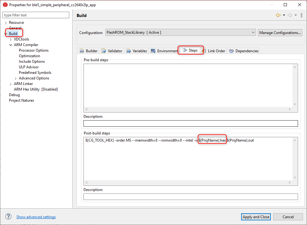

CCS/CC2640R2F: How to change the name of the .hex file that will be generated every time after compilation?
Part Number: CC2640R2F
Tool/software: Code Composer Studio
SDK --> simplelink_cc2640r2_sdk_4_10_00_10
I am working on Simple peripheral project.
