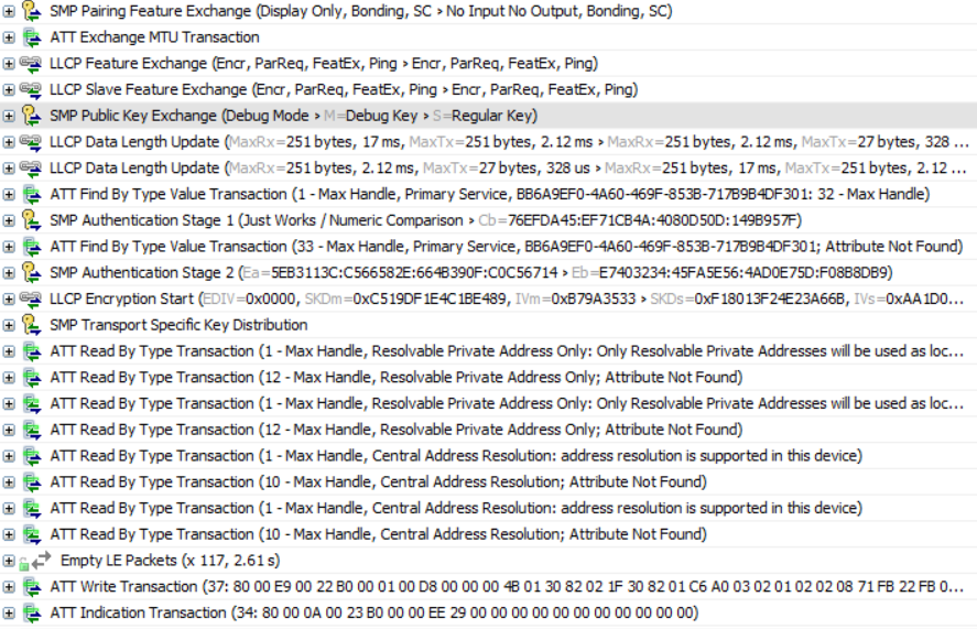

However, when using these settings I noticed that if the connecting party is using secure connection debug keys, the entire connection uses those keys and my BLE sniffer is able to sniff the connection. The Core spec says “if a device receives this debug public key and it is in a mode in which it cannot accept the debug key then it may send the Pairing Failed command with the reason set to ‘Invalid Parameters’.” So it seems that the core spec leaves this up to the implementation to decide. How do I reject the use of secure connection debug keys in code?

    We use an Ellisys Bluetooth Tracker. Can I send the logs to you privately? It seems I'm not able to send you a private message. I also have included a screenshot of a portion of the sniffer log. You can see that the master wants to use debug keys but the slave is using a regular key, yet the sniffer is still able to sniff the connection. Please advise.
    Keron

  • Hi Keron,
    When either the initiating or non-initiating device uses this specific debug key, it enables over-the-air sniffer equipment that supports LE Secure Connections to determine the LTK and therefore monitor/decrypt encrypted traffic throughout the connection. As far as being able to actually reject an attempt by a device using debug keys, allow me to look into this for you.

    After taking some time to try to implement this solution I came to the realization that using the approach where I check the LTK to see if debug keys are in use won't quite work. I had originally assumed that when one party uses debug mode, the LTK used for the connection would be the same for all connections, but this is not necessarily the case. The issue is that if the peer wants to use debug keys, the LTK will be formed using the peer's default public debug key (defined in the BLE Core spec) and my device's own private key. Since my device is not set up to use debug keys by default, it will not necessarily be using the default private debug key defined in the BLE Core spec and so the LTK is not predictable.
    What I actually need is a way to check if the peer is using the default public debug key defined in Vol 3, Part H, section 2.3.5.6.1 of the BLE Core spec. That would immediately let me know that the pairing should be rejected. Alternatively, if I had a way to retrieve my own device's private key, I could combine it with the default public debug key in an ECDH operation and see if the result is equal to the LTK I see in the GAP_AUTHENTICATION_COMPLETE_EVENT case of GAPBondMgr_ProcessGAPMsg(). If the results are equal, that would also indicate that debug keys are in use.
