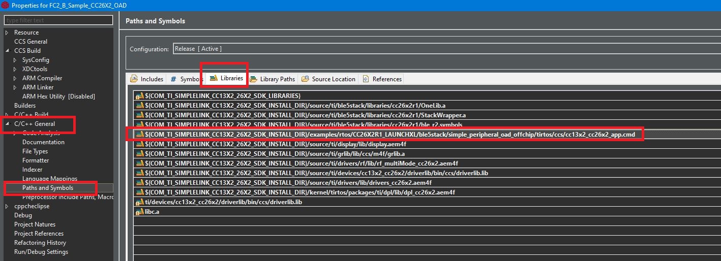

  • Hi M-W,
    i just double checked:
    In our application i see the following file being used in the command-line call for the ARM Linker:
    -l"C:/ti/simplelink_cc13x2_26x2_sdk_4_10_00_78/examples/rtos/CC26X2R1_LAUNCHXL/ble5stack/simple_peripheral_oad_offchip/tirtos/ccs/cc13x2_cc26x2_app.cmd"
    After searching through various option windows in CCS i found the location were that linker command file is specified:
    So i guess that i can copy the file into the project, make my adaptions and adapt the Entry in the "library" compartment....
    Kind regards
