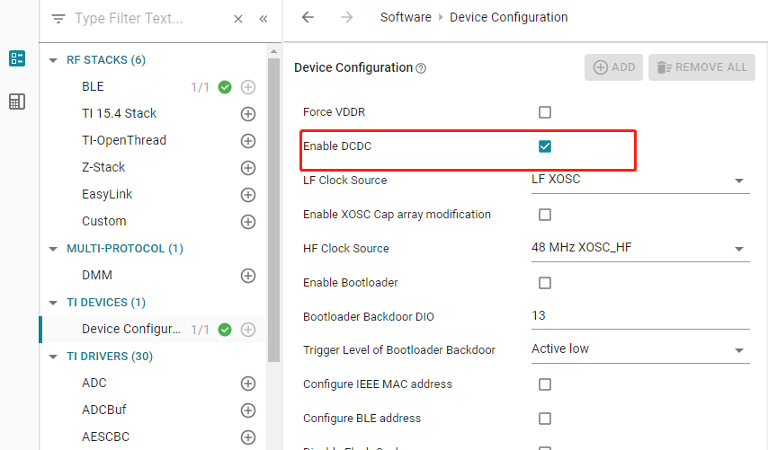

hello,
The internal global LDO can be used instead of the DC/DC regulator.I want to know how to config on CCS to switch Internal DC/DC Converter to Global LDO.The configuration in the figure below seems to have no effect.
  • If you compile, you will see that these two settings:
    // Use the DC/DC during recharge in powerdown
    #define SET_CCFG_MODE_CONF_DCDC_RECHARGE 0x0
    // Use the DC/DC during active mode
    #define SET_CCFG_MODE_CONF_DCDC_ACTIVE 0x0
    in ti_devices_config.c
    change value if you toggle the "Enable DCDC" button.
    You will see an effect of this change on the current consumption.
  • Hi Sir,
    1. In the simple_peripheral project code, uncheck the "Enable DCDC" option in the syscfg file, and the ti_devices_config.c file will be modified to the following settings:
    #define SET_CCFG_MODE_CONF_DCDC_RECHARGE 0x1
    #define SET_CCFG_MODE_CONF_DCDC_ACTIVE 0x1
    2. Because the simple_peripheral_oad_onchip project code does not generate the ti_devices_config.c file, but directly uses the startup_files/ccfg.c file in the SDK 3.40.
    Uncheck the "Enable DCDC" option will not modify the settings in the startup_files/ccfg.c file
    Whether we can only manually modify SET_CCFG_MODE_CONF_DCDC_RECHARGE and SET_CCFG_MODE_CONF_DCDC_ACTIVE in the SDK?
    Thank you.
  • Could you please update to 4.20 of the SDK and test again?
