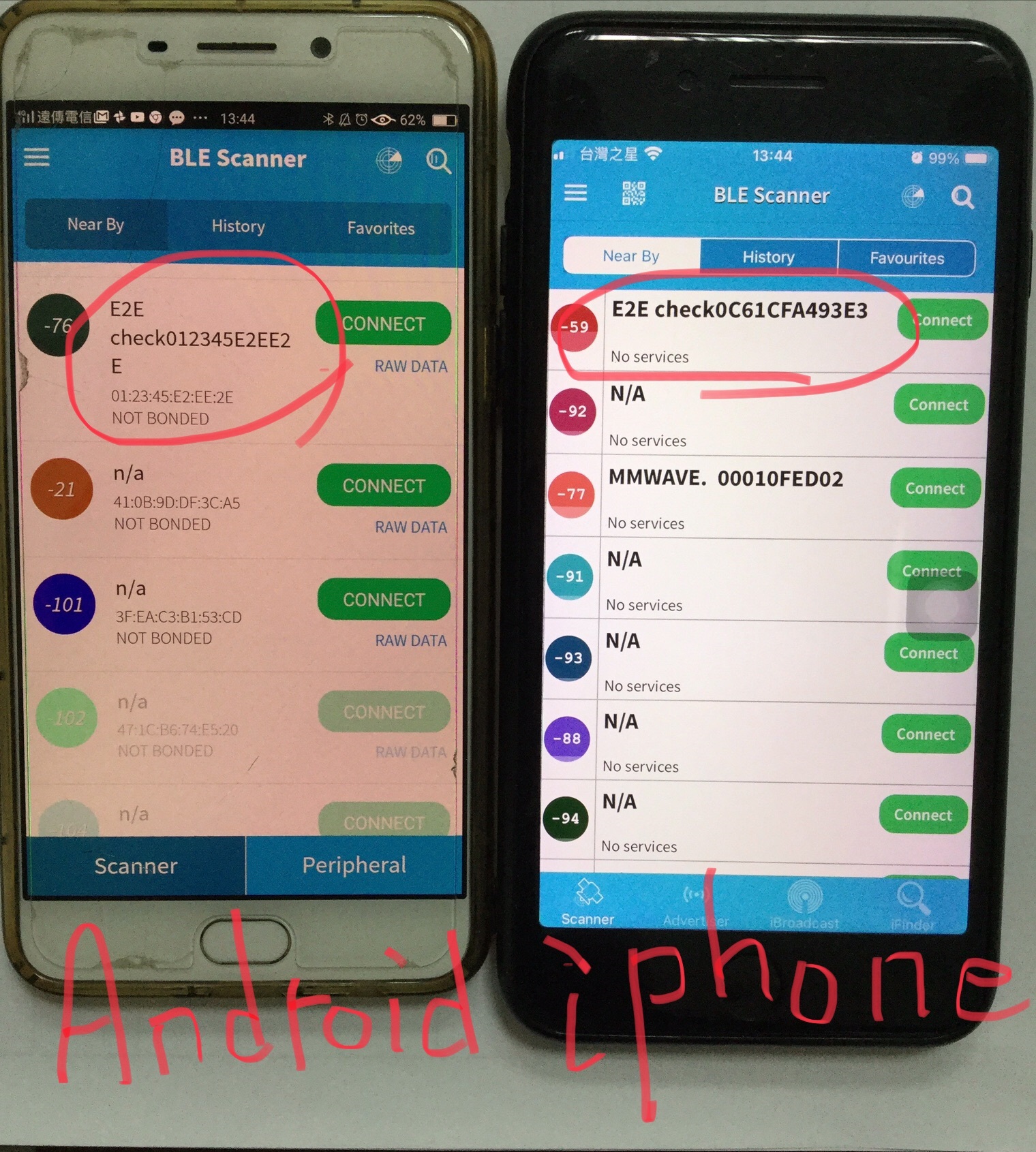

  • Hi Alec,
    1. I just use TI's STARTER APP on iOS Phone then click SERVICE EXPLORER when one of BLE5 devices on the listing be selected on step2
        It did not be pairing or bonding just connecting and show SERVICES listing on APP
    2. They are different display on the DEVICE-NAME shown on Android Phone and iOS Phone reported as followings,
        (Case 1) In Android Phone system shows the SECONDARY MAC address always on the way both of ADVERTISING stage or RE-SCAN advertising
                       after quit  from CONNECTING
       (Case 2) In iOS Phone system shows the SECONDARY MAC address  on  ADVERTISING stage, but shows the PRIMARY MAC address
                     in RE-SCAN advertising after quit from CONNECTING, from now on the PRIMARY MAC address always shows on even RESET the device
                     or RE-START iOS Phone
    3. I try to use TI's SNIFFER Tool to check the ADVERTISING message and found that the message bytes is packed by SECONDARY MAC address
        that means the device is advertising based on the SECONDARY MAC address by reading from NV which flashed by UNIFLASH Tool
    Why are the different behaviors on Android and iOS Phone system? and how to fixed it?

  • Hi Alec,
    1. Attached image file for checking,
        file inserted here, file name: E2E_check_Android_vs_iPhone.hex
    2. The report on Android and iOS Phone,
        As following, Android Phone shows SECONDARY MAC address
                             iOS Phone       shows PRIMARY        MAC address
    Kevin

  • Hi Alec,
    Report the behavior on Andriod Phone and iOS Phone as following,
    As you can see Android Phone shows SECONDARY MAC address
    Kevin

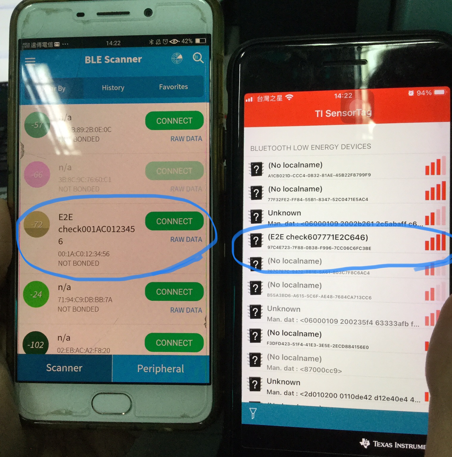

  • Hi Alec,
    1. Attached snapshot for checking,
        As you can see the secondary MAC address of "0x12345E2EE2E" can bee seen on Android Phone,
        but the iPhone shows the primary MAC address
    Kevin

  • Hi Kevin,
    I was able to find a similar behavior on the iphone version of the simplelink starter app, and I believe this to be an issue in the app itself. I am contacting the correct team to try to get this resolved in a future update. Is there anything else that I can do for you? I presume this is not an issue blocking your development, since it is only an app issue. Let me know if you have any other questions.
    Alec
